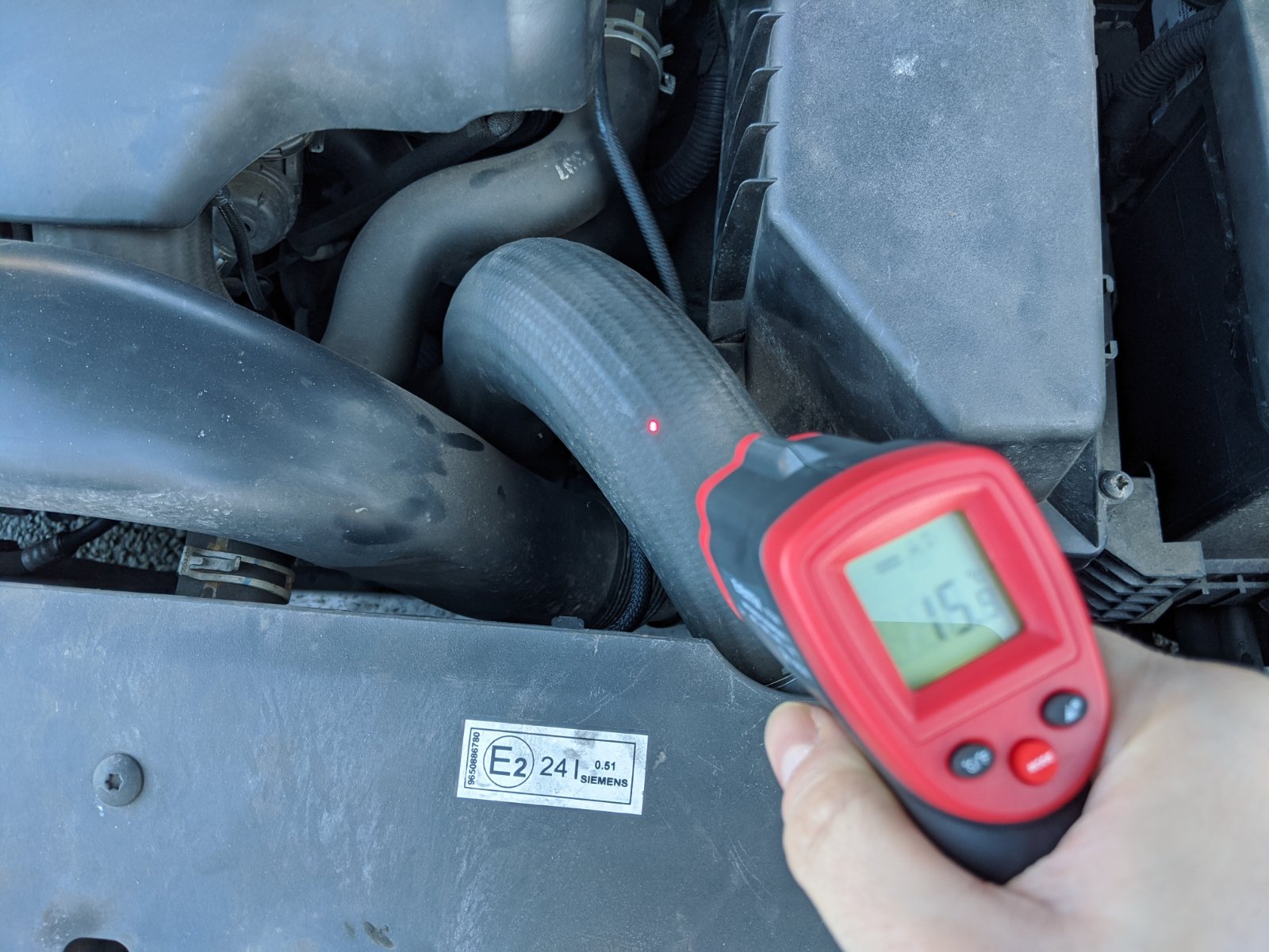

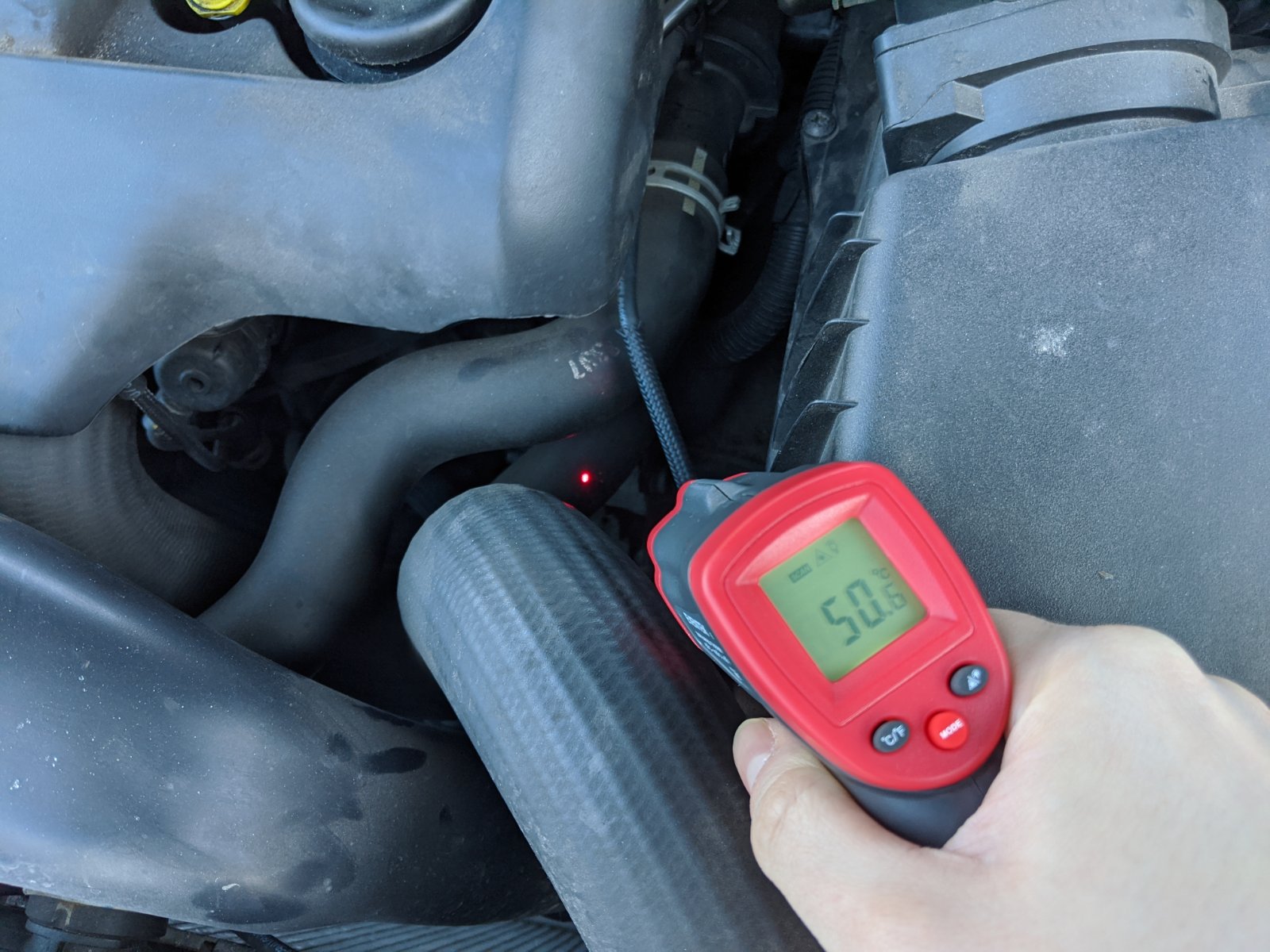

Okay, I'm sat in my car at the moment, bonnet open. The water temp on the dash says 70c, while the top hose measures 16c with my temp gun. Assuming I've got an accurate reading, the hose from the bottom of the radiator reads 50c.
Does this suggest that the thermostat is actually doing its job?

That suggests something very odd is going on.BadIdea wrote: 18 Jan 2020, 13:39 Okay, I'm sat in my car at the moment, bonnet open. The water temp on the dash says 70c, while the top hose measures 16c with my temp gun. Assuming I've got an accurate reading, the hose from the bottom of the radiator reads 50c.
Assuming all those temp readings are right, if the top hose (coming away from the cylinder head, temp sensor and thermostat) is reading 16C, then the top of the main radiator should be the same, and as the water in it cools, it drops to the bottom, and thence along the bottom hose - which ought to be cooler, not 50C. Re-check the readings...
If the engine is still warming up (70C on the gauge) and the 'stat is still closed (it should be at a block temp of 70C), there should be no coolant flow along the main radiator hoses. Your top hose figure confirms that, the bottom hose one doesn't.

Maybe I've been an idiot and checked the wrong hose. I thought I'd traced it back from the bottom of the radiator, but perhaps it was a different hose. I've attached a couple of photos I took at the time.white exec wrote: 18 Jan 2020, 16:14 That suggests something very odd is going on.

You might have been reading a by-pass hose - maybe.

That's my thoughts, looking at the photo although not knowing the setup well. Looks a little small to be a bottom hose & I might expect it to be on the other end of the rad, so the bottom hose can go direct to the water pump as a lot do.white exec wrote: 18 Jan 2020, 18:23 You might have been reading a by-pass hose - maybe.
