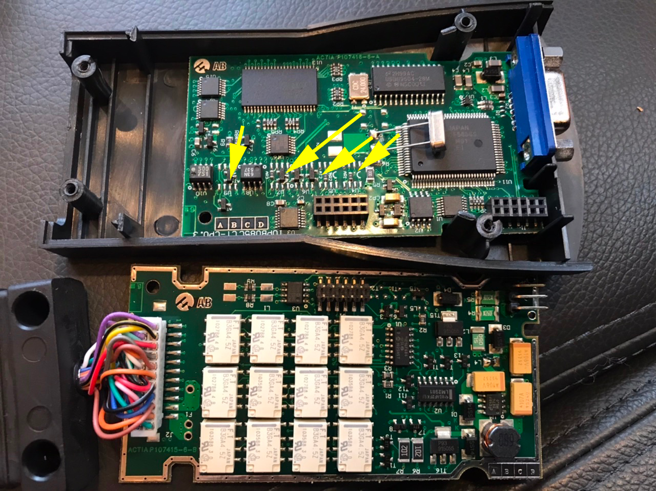

- x 6946
Re: C5 X7 tailgate anger......
Yes, that one is missing the Optocouplers arrowed, and there will be other components on the other sides of the board including a 10k resisitor no doubt that is needed for full CAN communications.
Thanks for that Marc.
My mate has now told me to keep the old Lexia but I don’t think it’s worth modifying. I could fit the optocouplers, used to be my job years ago, but I doubt I could justify the time taken to save a few quid.
