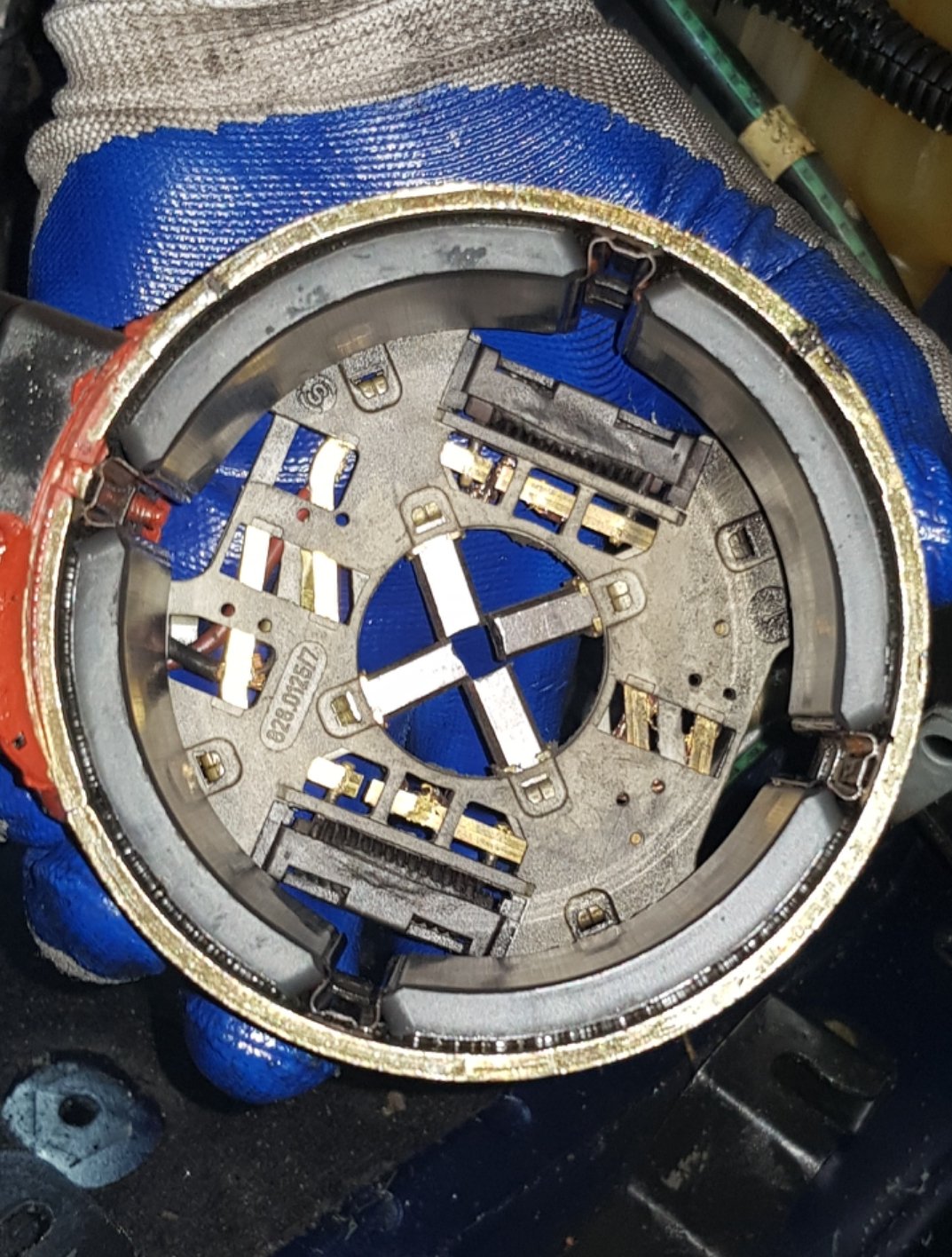

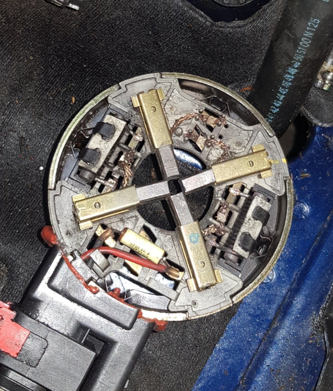

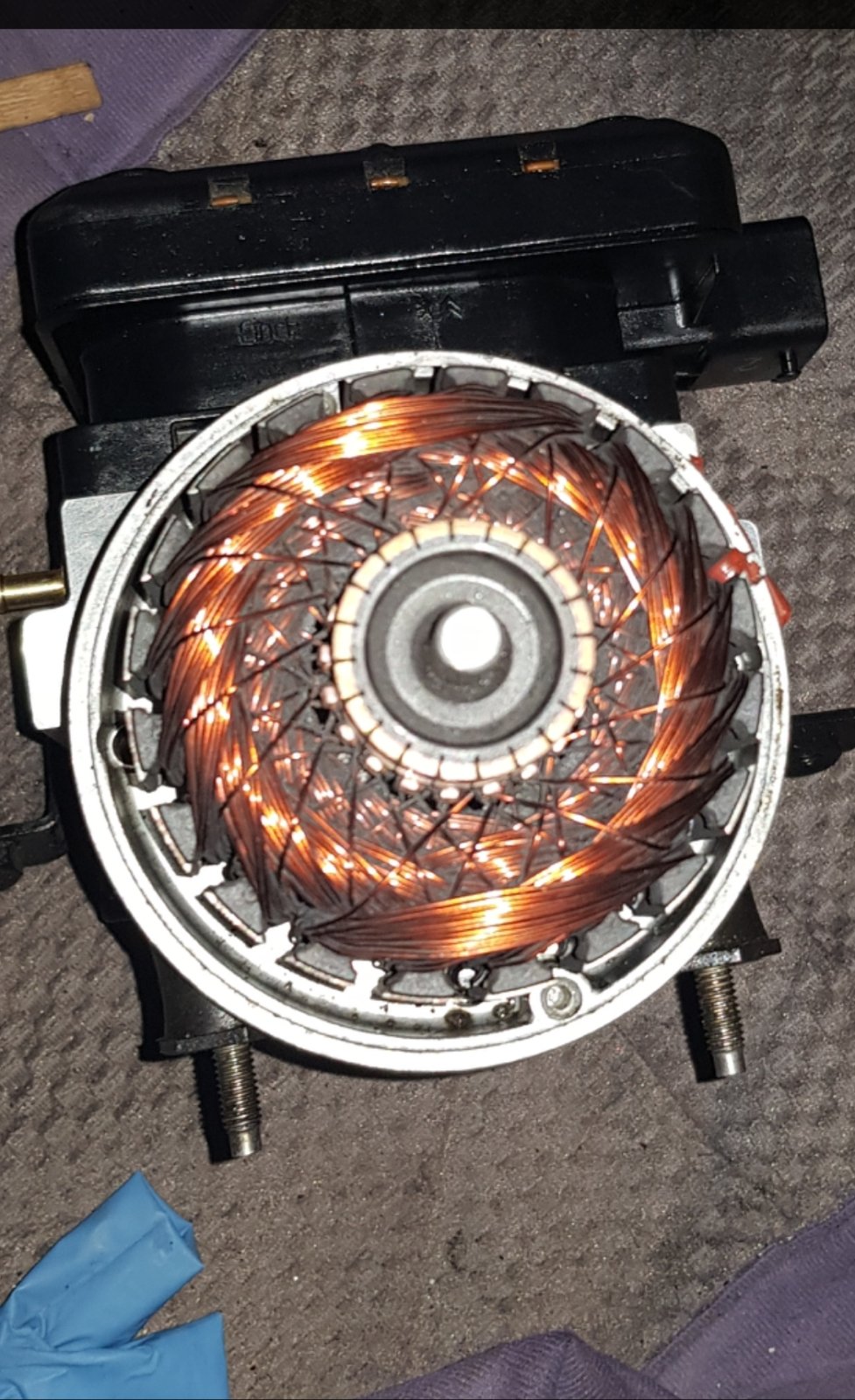

Re: C5 front suspension stuck at highest setting
I managed to disambled motor without removing plug. There wwas some oil at the bottom, but there was nothing burned inside. So cleaned the motor and put it back everything to see if it fire up. Initially it was weird sound but it was power steering sound which disappear after fluid flew throgh the system. Did suspension up down but no change. I didn't prime the pump as don't have any tool. Wanted to check if the motor start working but didn't work. It was messy job but good learning curve. If the plug was not stuck I will replaced the motor. If I have to cut the cable and solder it new motor, it won't be reliable.
The pump looks very clean indeed!
When did you last check the Maxi fuse? I suggest you check again - not visually, but test with a multimeter and look at the contacts that hold the fuse in - these can get covered in crusty deposits or become loose making a bad contact with the fuse. Always worth checking this again as your pump looks like new.
That looks like a newish motor to me....

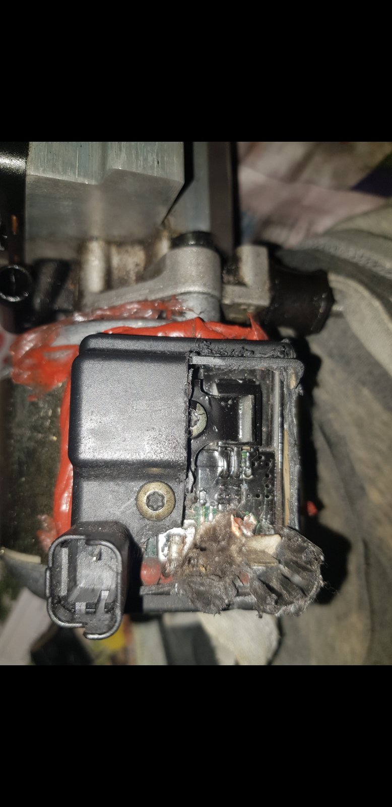

The connector is melted and caused the smoke. I am going to buy pump with connector so i can cur the cable and solder to new connector. Is it safe to solder connector withoit compromosong funtion of the pump. What are the other option to join the cable.
If the melted connector is the only thing wrong with your pump, you have nothing to lose by just bypassing it and soldering wires directly to the pump, with an external connector.
Finally i was able to seperate cable from the motor. Checked the motor by connecting 12v supply and it perfectly fine. The connector housing is completely damaged and can't locate positive connection. Can i bypass connector and comnect both cable directly to the motor. If i do this where should i connect exiter cable.
