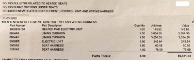

Well, the drivers seat seems to feel better - and the heating in it works. I don't think they did the passenger seat though (I did tell them it was both). Here's the work order. Some replacement cushioning as well as the heating pads and some electric components. I can't tell if that's one seats worth or two.

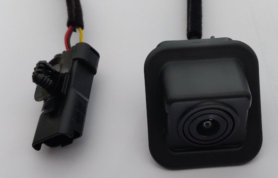

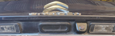

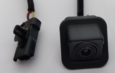

The rear camera is blurry, so they got a replacement, but found what they say is a third party camera. So now I have a spare genuine camera. Does anyone have a camera on their C5? Which one does it look like? The one they gave me looks too big to fit in the space.
The sound system loses the right channel sometimes. They tried to blame that on the third party rear camera! Bit of a stretch. Much more likely broken wire where it goes through the drivers door or a connector.

Re: Heated Seats stopped working C5 x7

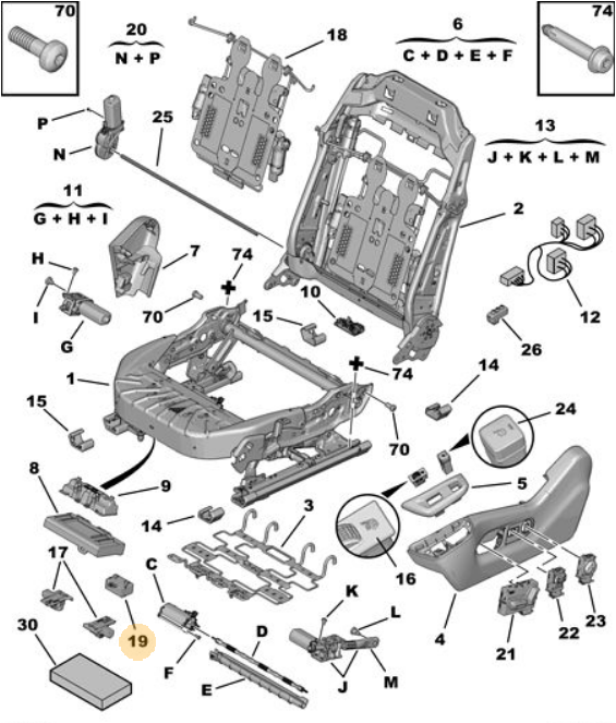

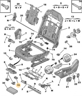

Ok, as I suspected, there is no repair for the heating elements - it has to be a new seat cushion (otherwise they would rip the bonded leather) - so this is what they have done
Basically they have replaced the following:
1609939180 Heated Pad Electric Unit (19)
6509ER - Electronic control unit? (not shown)
6505A3 - Seat Harness Driver (12)
6505A2 - Seat Harness Passenger (12)
8864A8 - Driver Seat cushion (1)
8864A5 - Passenger Seat Cushion (1)

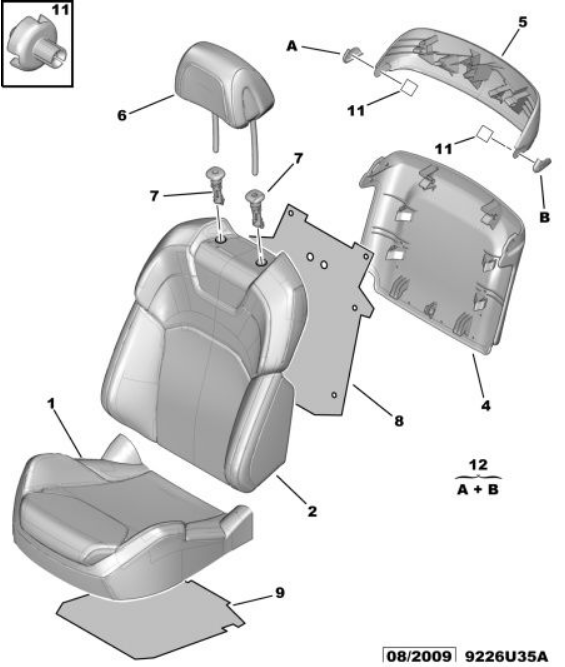

However - there is also a heated pad in the seat back cushions (2)! - There is no mention of having replaced these anywhere on the parts list as you can see. So I would check that the seat backs also get heat on both seats.....
As for the cameras, there was a known issue on the DS range and early C5 X7s with a poor image especially at night and the camera was replaced with an updated one - but I don't see the part number of this on the list, so not sure what they have done there.

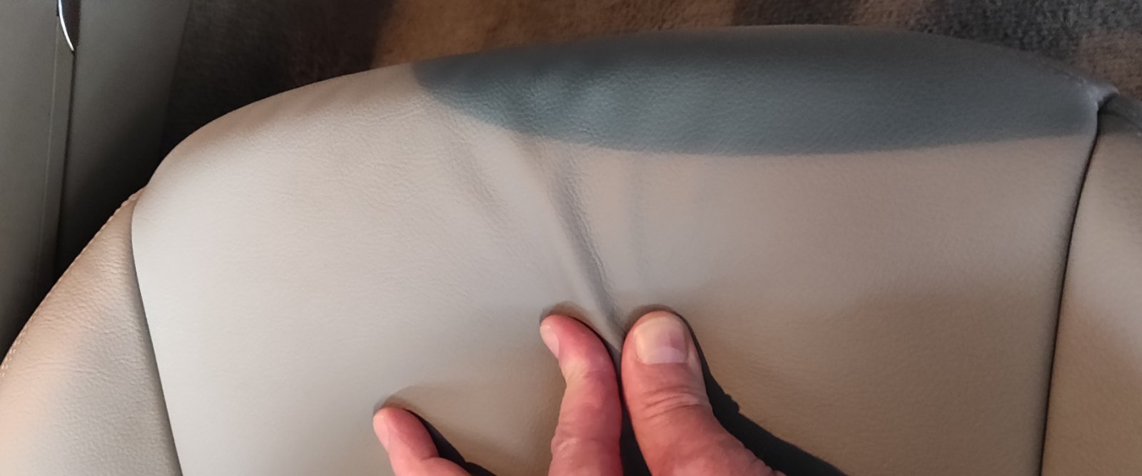

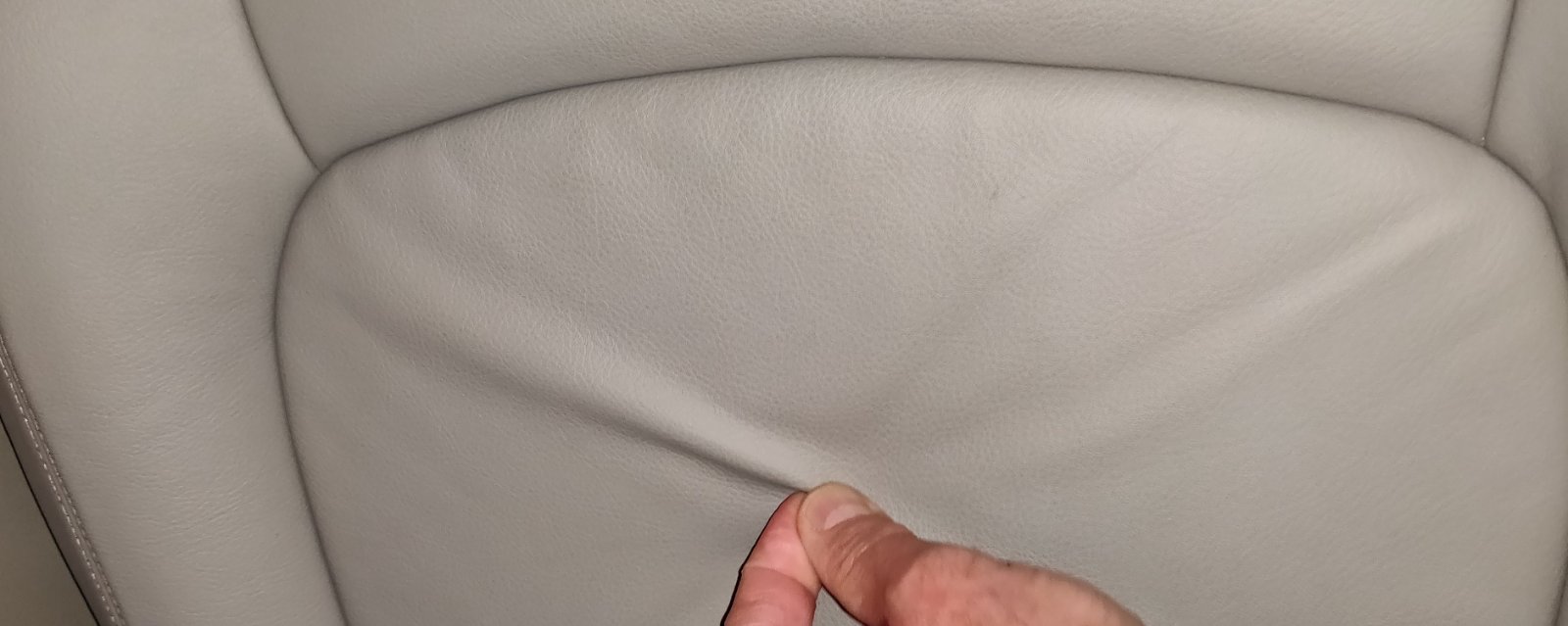

Marc - the leather on the seat base feels 'loose' not attached to the cushion under it Not a big deal unless it gets worse. Are you saying it should be bonded to the cushion all over, not just pulled down at the seams?

The leather is bonded to the cushion with glue, which is why I mentioned the unlikelihood of them replacing the pads. As for the underside of the seats and the finishing of the trim - a photo might help so that I could do a comparison with my seats to see if this is normal.

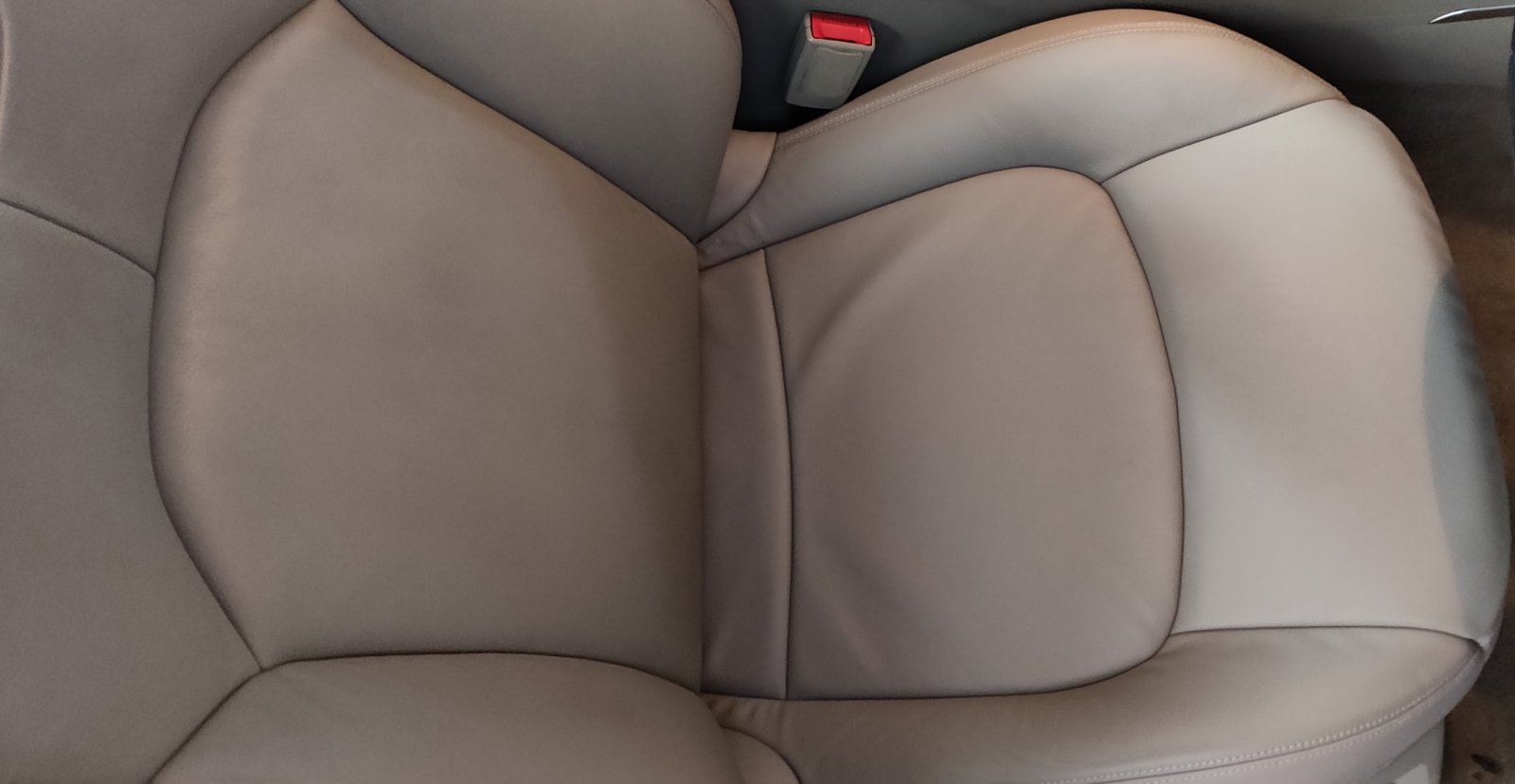

Right, so they've taken the whole seat base off the steel frame, taken the cushion and heat pad out of the leather cover, then put the new cushion and heat pad in and reattached that to the frame. As you can see in the pics, the leather is not stuck to the cushion inside it. I can pinch it to make the ridges, but the rear seats (which haven't been touched) are the same. The leather doesn't feel like it's stuck to the foam inside it. So it seems that's how it's done (in this car at least).
I'm guessing the foam padding and heat pad are bonded together and that's one reason they're so expensive.

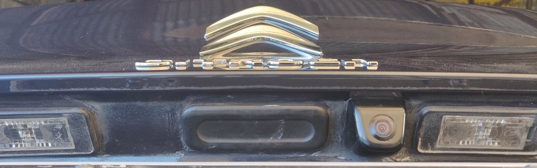

I took the cover off the inside of the boot and the camera is a third party one with a round 4 pin connector. It actually works, just is a bit blurry, so I reckon I'll leave it.

I thought you meant on the underside of the seat base - those pics are normal as mine is the same. I believe it is bonded at the underside of the cushion. But they don't seem to sell the heated seat pads separately as they are not available on their parts database.
