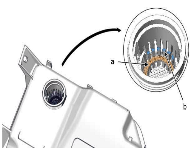

Remember if they are going to be doing the work with the car raised off the ground with the wheels hanging freely, then they must ensure they remove the LDS cap beforehand and also to disconnect the battery, otherwise the suspension pump will try and kick in regardless of whether the engine is running or not and that can have consequences. Follow the battery disconnect / reconnect procedure before and after the work:

The LDS fluid must only be checked on the lowest setting and be between the 'a' & 'b' marks below.
