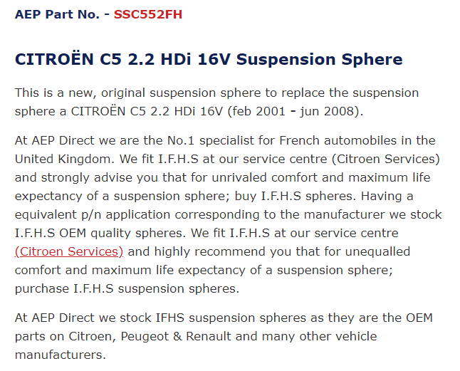

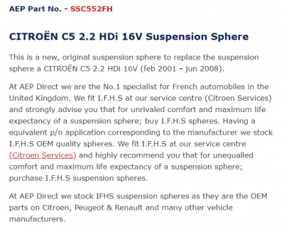

- x 6953
Re: Why do new spheres go hard very quickly?
But they are still 'equivalent' products according to their own blurb - not originals David. Reading that link it wouldn't give me any confidence either:
It's all repeated blurb and not very well written at all - would put me right off. I've seen Chinese sellers with more coherent blurb than that
I know originals are expensive, but at least they are originals....
I appreciate you saying that these were recommended by the Forum - but the Forum doesn't actually recommend anything - only the individual members who contribute and that will be their own experiences of course.
