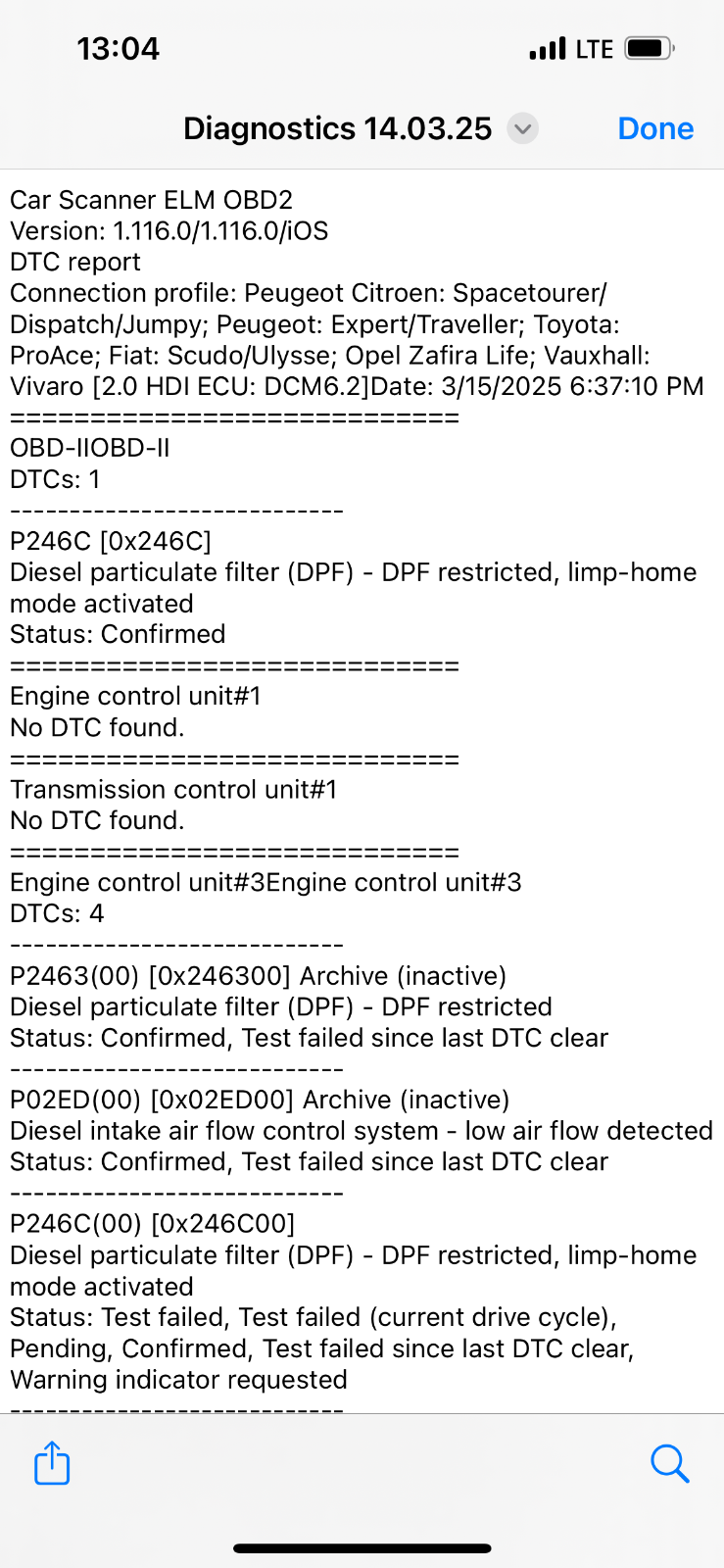

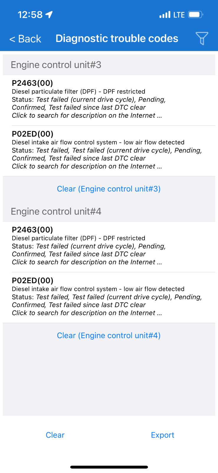

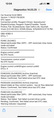

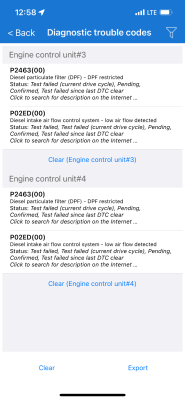

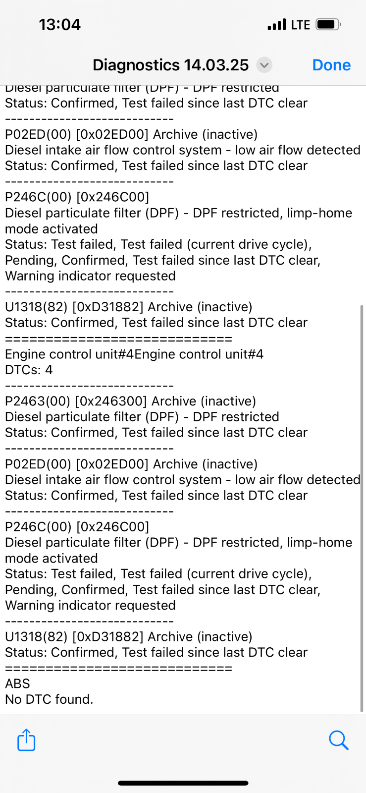

JLobster
- Posts: 4
- Joined: 03 Dec 2024, 18:06
Re: Soot on rear doors Expert 2.0 HDi (DW10CD)
I got these codes, even though I’m fairly certain the coding was done.
