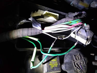

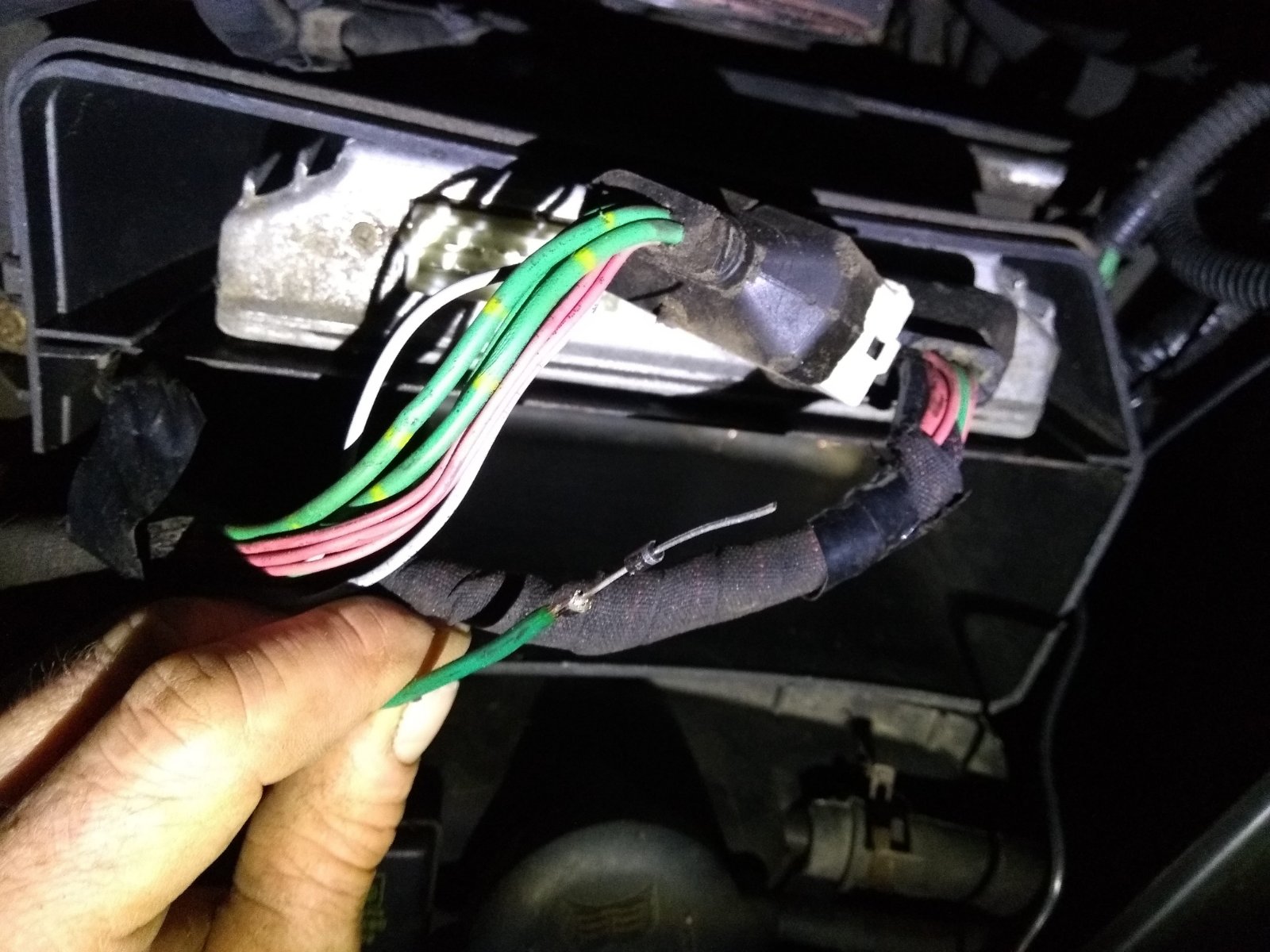

Howdy team
Finally got back on the frenchie, got diode's sent via trademe and soldered them in last night. As can see I went for a separate Earth from outside of the ECU box, as I had a faulty earth issue with the headlights.
Suspension is now running smoothly again, but I still have that sideways skip/slide/corkscrew, it almost feels like have a flat tyre on left-hand turn-in, I have popped that RH rear wheel off and inspecting the rear sub-frame. Currently considering:
* air locks in the RH rear hydraulics, requiring bleeding...
* I am assuming if bubbles in the hydraulic fluid itself then all points would be affected, rather than consistently one side of the car
* returning to something physical, rear sub-mounts, bearings, ball-joints at the front end. All have been recently inspected for the Warrant of Fitness however.
Again, open to suggestions!
Cheers
- Simon
