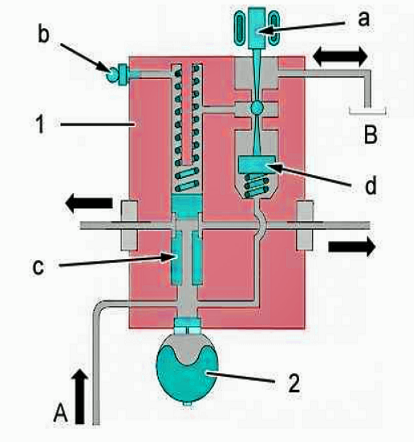

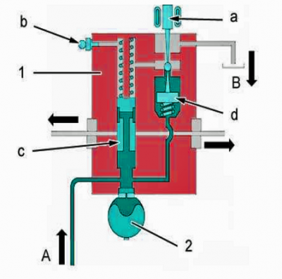

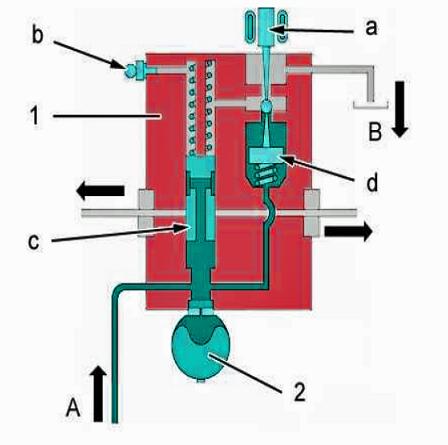

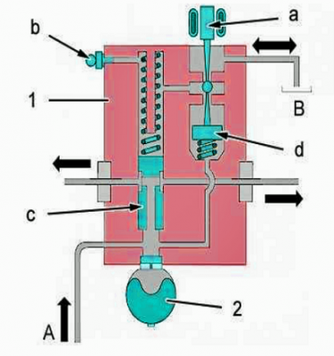

Here's a simple diagram of the rear firmness regulator:
Soft Status
"A": High pressure inlet (Integrated BHI ).
"B": Return to the reservoir (Integrated BHI ).
(1) Rear firmness regulator.
(2) Rear stiffener regulator accumulator.
"a" Variable firmness electrovalve.
"b" bleed screw(s) .
"c" Hydraulic isolation slide valve.
"d" Electrovalve slide valve.
Soft status:
  • The electrovalve is not supplied
  • The electrovalve slide valve "d" moves under the effect of the integrated hydroelectronic block supply pressure
  • The return to the hydraulic fluid reservoir is blocked: The pressure under the lower part of the hydraulic isolation slide valve is identical to that of the BHI
  • The upper part of the hydraulic isolation slide valve is identical to that of the BHI: The slide ("c") moves under the action of the integral spring
  • Flow of hydraulic fluid between the right hand and left hand suspension is possible: The hydractive 3+ sphere communicates with the suspension circuit
N.B.: In the rest position, the rear firmness regulator is at the soft status.
N.B.: The body height can be regulated in "soft status" operation.
Firm Status
"b" bleed screw(s).
Firm status:
  • The electrovalve is supplied
  • The electrovalve slide valve "d" moves and frees up the return to the reservoir and blocks the hydraulic supply from the integrated hydroelectronic block
  • The bottom part of the slide ("c") is at the pressure of the hydraulic fluid reservoir
  • The upper part of the slide valve is under pressure from the hydractive sphere 3+
  • The difference in the pressure at each end of the slide ("c") causes its movement
  • In its new position the slide ("c") blocks the passage of hydraulic fluid between the RH suspension and the LH suspension
  • The hydractive 3+ sphere is isolated from the suspension circuit
