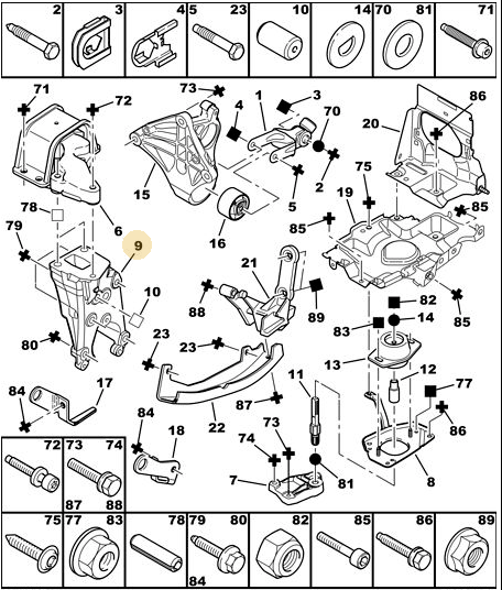

I searched on the part number (184699) - that one is in fact in Germany - https://www.ebay.co.uk/itm/Engine-Suppo ... SwUDZcodW7
If you could find someone who has an engine with the bracket attached you could contact them and ask if they would just sell you that bit? I'm surprised that Citroen say it is not available - it's not listed as out of production, and has been used on recent models (eg C5 Mk 3).

If this is the part you want, it IS available from Citroen directly.
Item 9 on the diagram and is confirmed as part number 184699. That is the listed part number on your link and can be ordered from Citroen directly. The UK price from Citroen is £133.10 inc. 20% VAT over here.

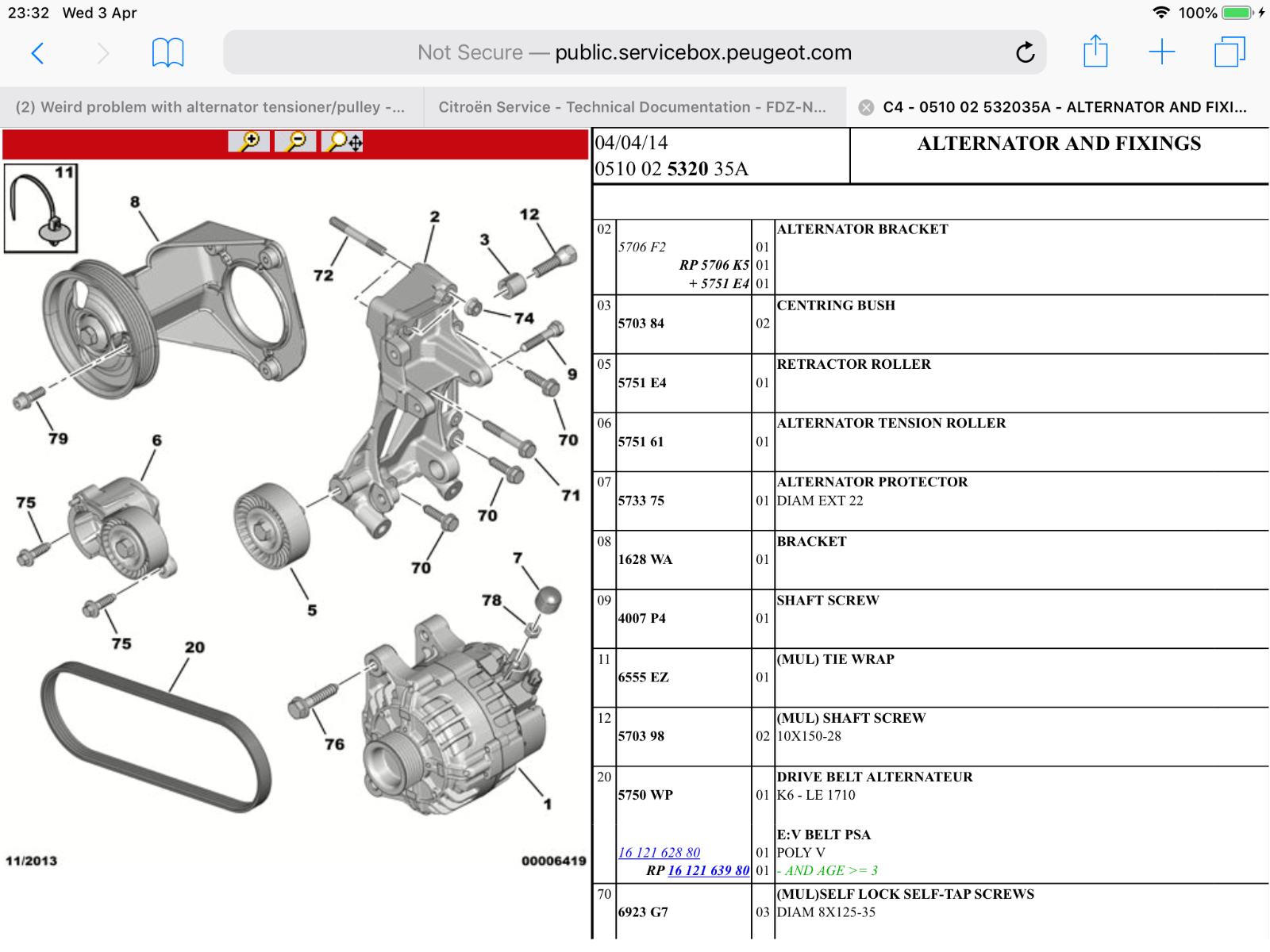

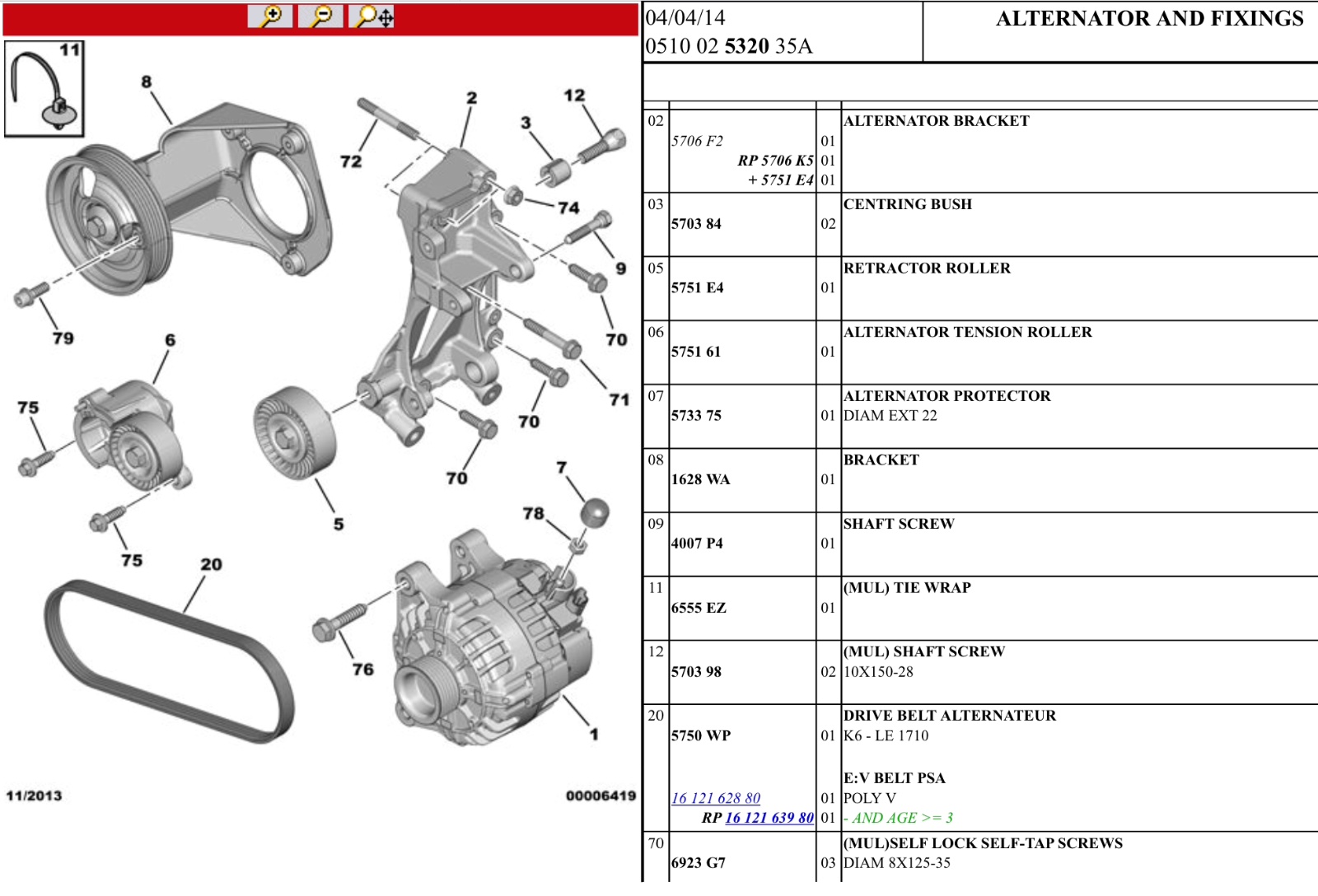

GiveMeABreak wrote: 03 Apr 2019, 23:42 Ok, so it looks like it’s the alternator bracket that has cracked (number 2 on the diagram). You’ll also need a new roller (number 5) when replacing this.
The bracket is priced at £87 (UK) which includes our VAT at 20%, so may be less with your local dealer.

Re: Weird problem with alternator tensioner/pulley - C4 2.0 16V petrol
575160 seems to be for the C5 and a few other vehicles.
I would not use Autodoc for parts myself. I always use the official sources based on VIN. That way you know what was fitted and what should be there.
5751E4 is the correct part (No 5) based on your VIN from Citroen.
Is it possible that the wrong one was replaced previously - possibly contributing to the damage???
