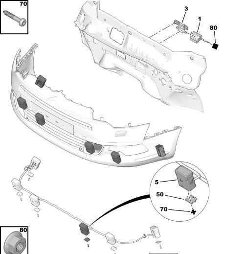

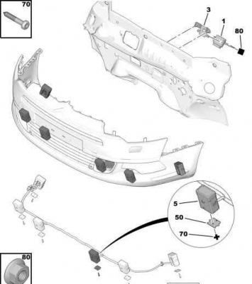

Your AFIL ECU (LDWS) is item 1 in the diagram Andy.
The suspension reference heights are pre-programmed into the ECU, so should be there unles there is a communication issue with the ECU so that they cannot be obtained. They won't just disappear so to speak.

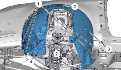

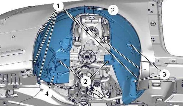

Any one got experience of taking out the wheel liners, are they better designed than the old ones or so all the mountings still fall apart and require angle grinding out?
- x 6945
Re: C5 X7 rear suspension fun.
Quite easy in comparison:
| Remove: The bolts (1) The plastic pins (2) ; Using tool [1] The nuts (3) The front splash shield (4) |
