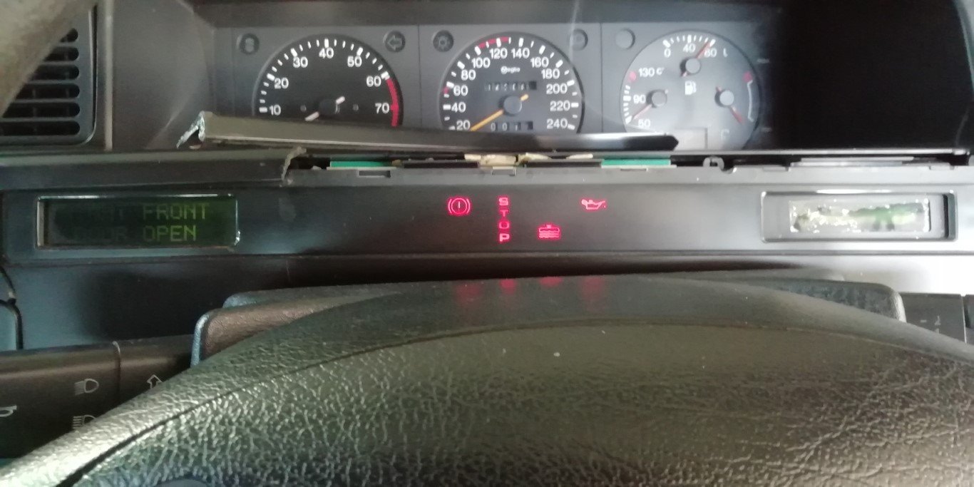

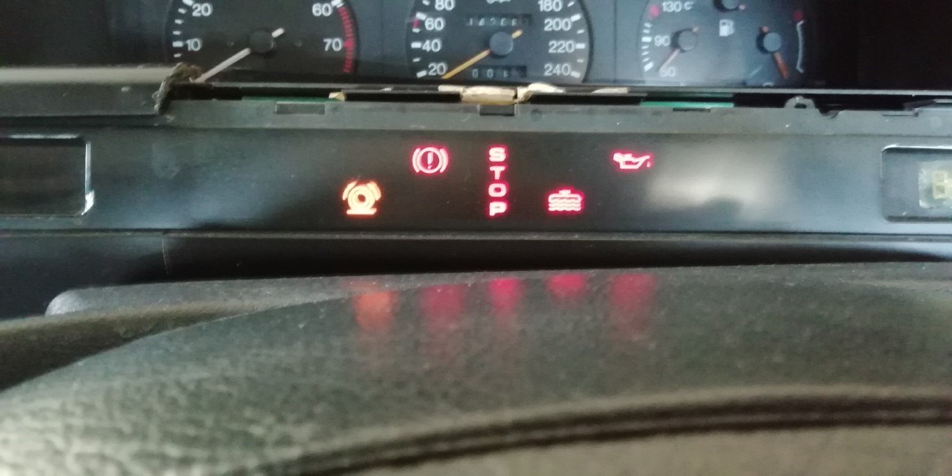

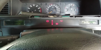

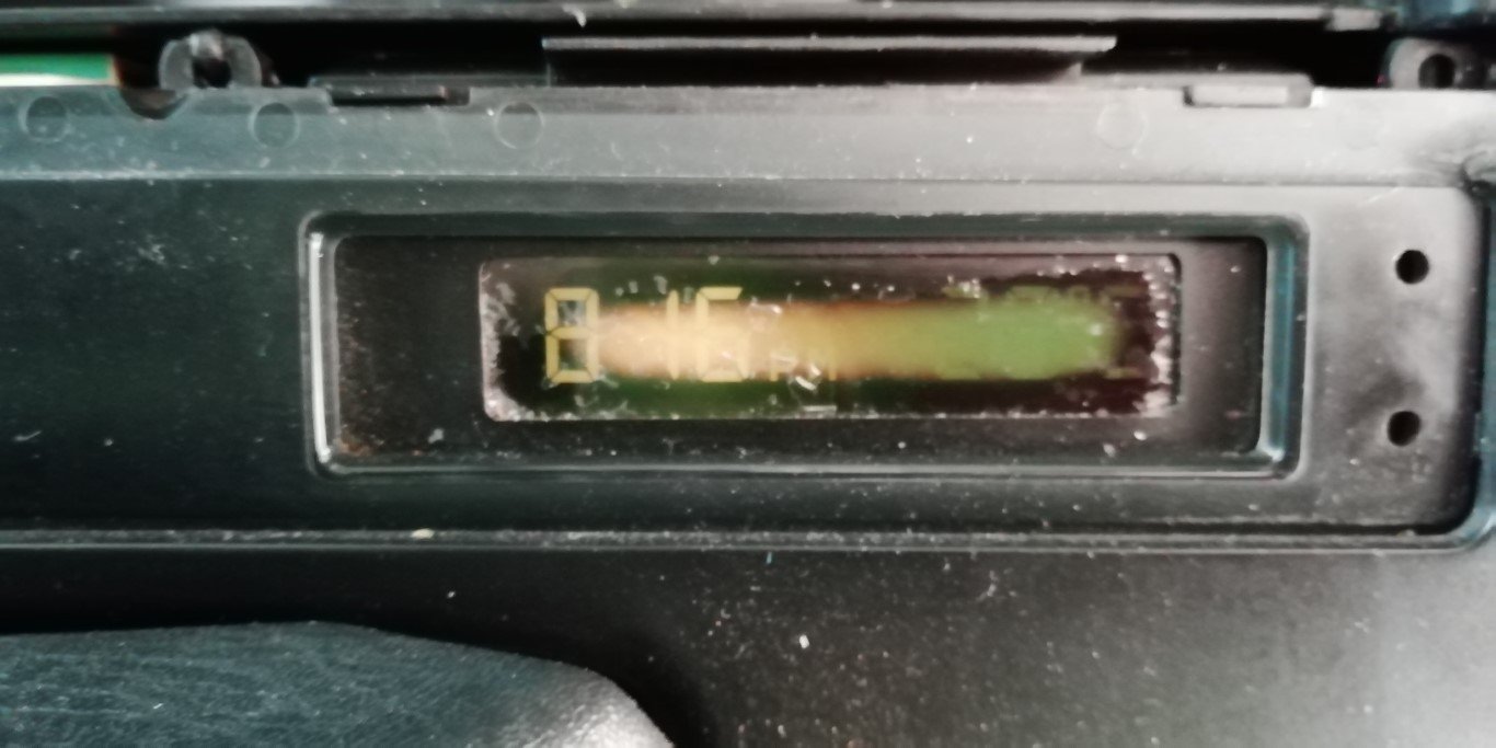

This morning we fitted a new battery, Looking at the display the LHS is now readable, but faint in parts. The RHS has responded to setting the clock in that I can tell the time, but the rest is a green blur.
The face-plate us far more damaged that I thought, large chunk just lifts off the top and some of the sides/returns and perhaps molded-in fittings are broken off
The centre display with the icons does not show a lot - I guess there should be more?

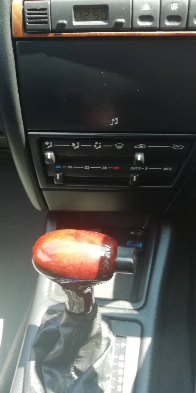

Hoping a to clear the issue re wooden Gear knobs. in this market it seems that the higher spec cars for both XM and Xantia had wood fitted locally - see my Xantia

Click to enlarge On our 2.5TD here, IGN switch on (engine not started) just shows these four:
( P ) parking brake on
( ! ) hydraulic pressure/level
STOP
[- +] battery
Your LH display looks as if it's just missing one or two rear illumination bulbs.
RH display looks a basket case; display layer may have delaminated. You could dismember and inspect, but make a note of the order in which the layers are assembled. Could be that only one of them (? diffuser) has deteriorated.

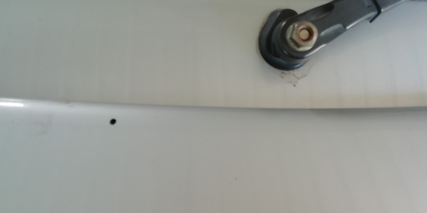

The spoiler is a thin, hard plastic casing, filled with brown PU foam. Looks like someone has punctured it.
Here, parking tickets are usually done with tape/adhesive, but a drawing pin would be another approach I guess.
That dash panel has been properly butchered, probably in a frustrated attempt to take it out. Ouch!
Try on club-xm for a replacement.

I just remembered that Chris had previously looked up the original spec for your car viewtopic.php?f=3&t=61837&p=599821#p599710 , and it shows that the RH display should have trip computer functions. The LCD in yours seems to have failed, but if looking for a replacement you should get one with km and litres, so you need one from Europe, not the UK (which is miles and gallons).

All good stuff - and one puzzle - if it's supposed to have trip functions - where's the button - it's certainly not on either the indicator or washers switch

When you get to the back of the RH display, see if it has one connector or two. If it has two, it will have trip computer functions. The trip computer always uses a button on the end of the wiper stalk. Possibly yours has been replaced by one from a car without a trip computer.
