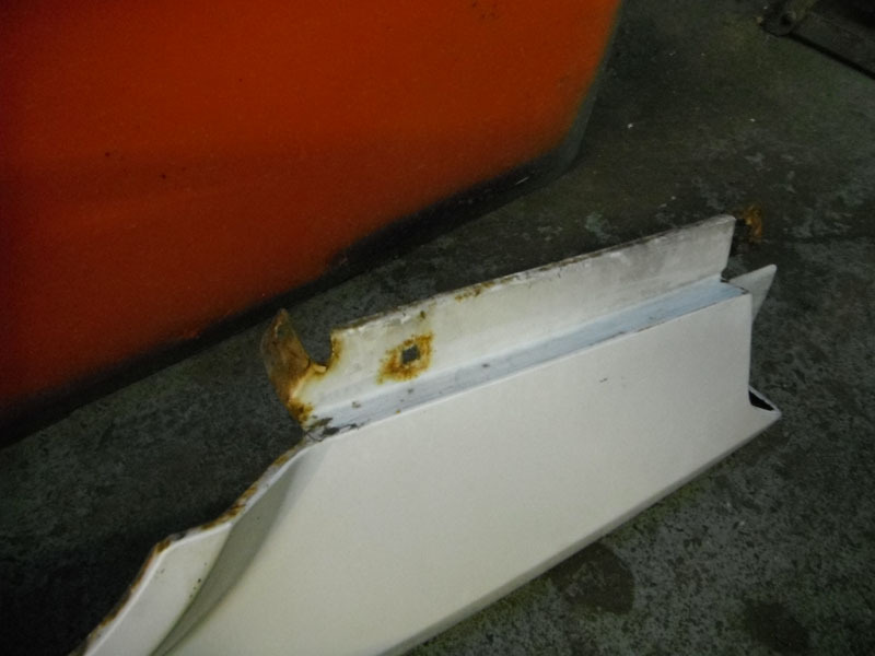

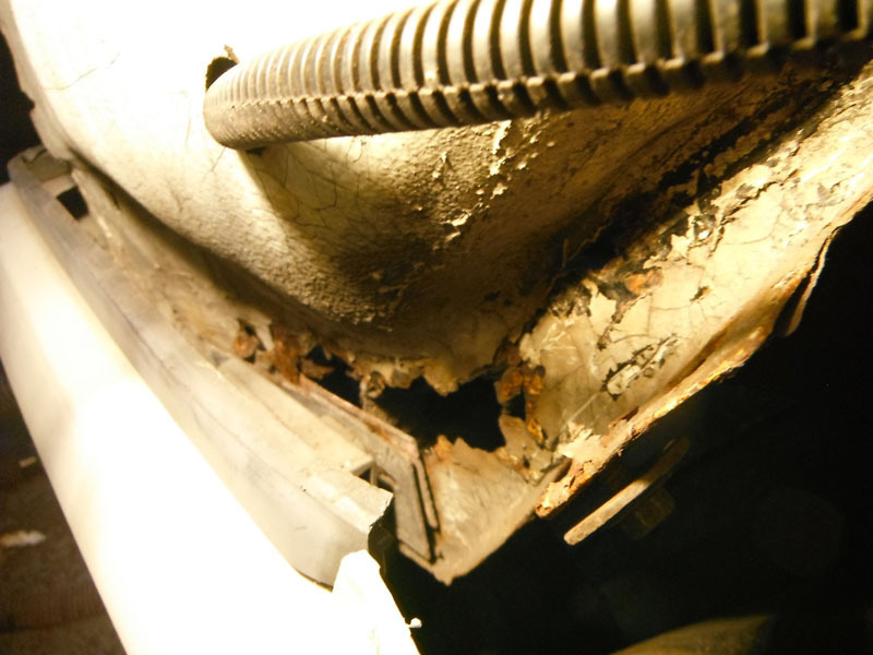

The other big weakness is the boot. I put my big boy pants on and started stripping out the boot trims, knowing just how frightening this part can end up being. Amazingly, it's incredibly good underneath everything.
There's just two small areas that require some attention. A small section of sealant has failed on the passenger side, and some rot has begun on the driver's side. This is all flat panels with excellent access so shouldn't be bad to fix at all. Looking underneath the car the inner arches are remarkably clean, and the rear apron is in excellent shape. I'll remove the bumper to do the repairs properly and get everything cleaned, painted, and protected to keep it this good once the welding is done. This was a very pleasant surprise, I was expecting this area of the car to be much worse even though it looks so nice on the outside.

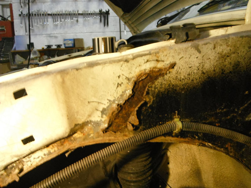

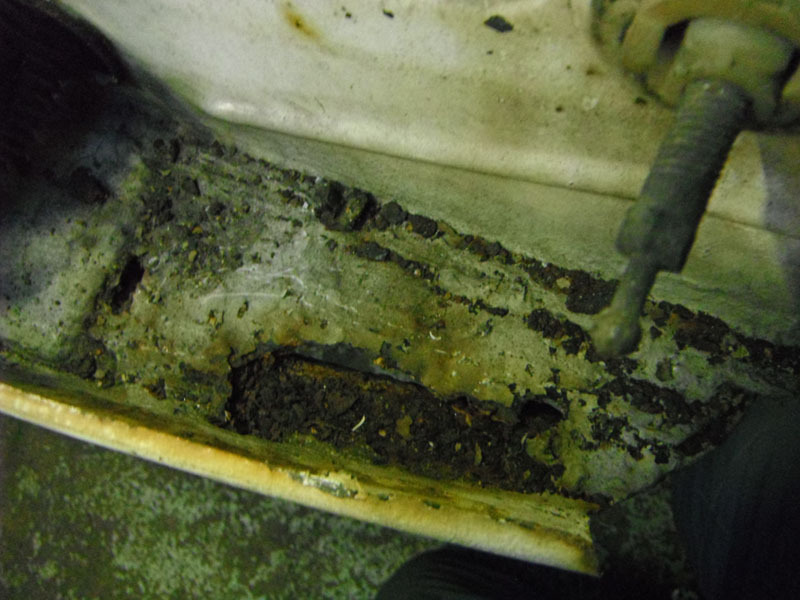

Up front I wanted to check out the only other bit of rust of note which was the inner wings. This is another common BX weak point and worth exploring. There was some foam-backed stuff applied to the inner wings and when I noticed it was holding on to water I decided the best thing to do was to whip it all off and deal with whatever was lurking underneath. Absolutely no point pretending it would be okay and letting it fester since I have the luxury of time and space to sort this out. Amazingly, it really wasn't that bad at all, just a bit ugly. The damage that is there appears to be localised to the bit where the vertical inner arch meets the horizontal, with a little bit in the nose on the passenger side. The driver's side nose piece seems very solid. I also had a look at the front crossmember that was advised at MoT and that too looks like it only needs a fresh bit of underseal to replace the bit we accidentally removed and is otherwise very solid. I will remove the front wings, lights, and bumper to rectify all of this since it's all very easy to dismantle and then make sure there's plenty of paint and protection applied to keep it good afterwards.

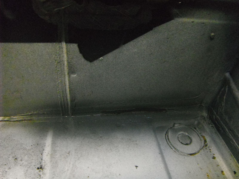

This was a very pleasant surprise. The floors and sills are amazingly sound throughout, with the exception of the few spots that need a fresh bit of protection from the scraping it got loading and unloading. There's no crusty tender bits underneath. I knew it was a good solid car, I didn't expect it to be quite this solid.

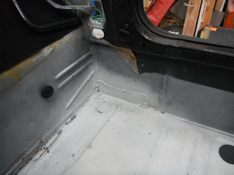

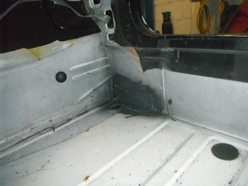

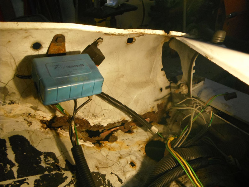

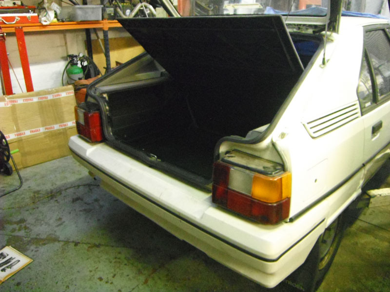

Got cracking on the welding today. I've started in the boot. Unfortunately, I couldn't remove the rear bumper because the fixings were being the usual pain and since I was concerned about breaking things, I left the bumper on and just worked from inside the car instead. This way I got the repair work done in the time I had spare instead of spending all day fighting with the bumper. It's not a factory style repair, I just let in a suitable patch with a 90 degree bend rather than mimicking Citroen's construction. Sploshed some zinc rich primer on once welded (no close up, it looks like I used a pigeon) and then had just enough time to seam seal it on both sides after this photo was taken. Happily, the passenger side spot didn't need any welding as once it was cleaned back the metal was good and it just needed a bit of fresh sealant to replace the bit that had lifted.
I would have liked to got the boot repairs painted and all the trim back in but it was too dark and too cold in the unit to really see what I was doing so I'll leave things as they are for now and come back to it tomorrow, most likely. I did discover the colour of the BX is Alpine White rather than Polar White and Halfords stock a reasonable match for the areas I'm working on, so I grabbed a can of that today. I didn't have time to do more welding work, and couldn't do more painting work, so I started dismantling the worst part of the car I knew about by first pulling out the headlight and indicator pod and then unbolting the front wing. I was pleased to see the wing is actually in very good shape, with just some very minor rust staining to treat and repaint to keep it this way.

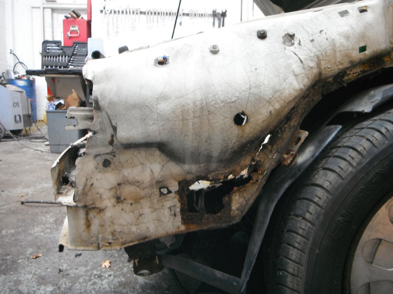

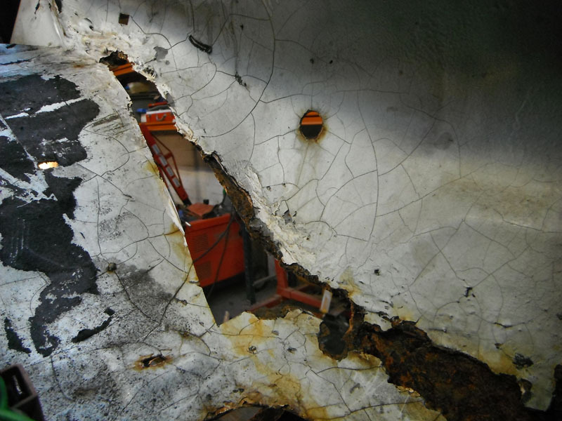

With the wing off, I got to see a bit of rust that I wasn't aware of, but wasn't surprising, which is where a couple of skins join. It should be a straightforward repair since access is very good, the cleaning up is likely what will take the most time on this. The reason it's a funny shape like that is that's the line of a seam where two panels overlap. This is a fairly common spot, as far as I'm aware. The other side of this is a panel seam with a smear of white sealant over the top of it.
I expect the other side will be a similar, but less bad, story. Better to deal with this stuff now and have it done. I'm hoping to get in tomorrow and get some progress on the front end and get the boot repair painted and all the interior back in, I don't want to have too much of the car apart at a time.

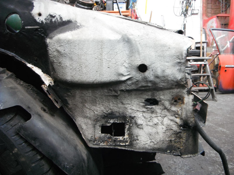

Part of the reason for me getting stuck into the BX so quickly is that I'm back at work on Tuesday so I wanted to get through as much as I possibly could before then. It's the busiest week of the month for me and I didn't want to be distracted too much by the desire to fettle the BX. That means there won't be another substantial update now until probably Sunday. There might be some smaller cosmetic updates, like the wheel trims I'll be restoring, in the meantime. We'll see how I get on with work.
I managed to get in a couple of hours earlier today so that meant I could actually get some paint on the boot corner repair and have time to put all the trims back in. There's nothing else to do at the back of the car now.

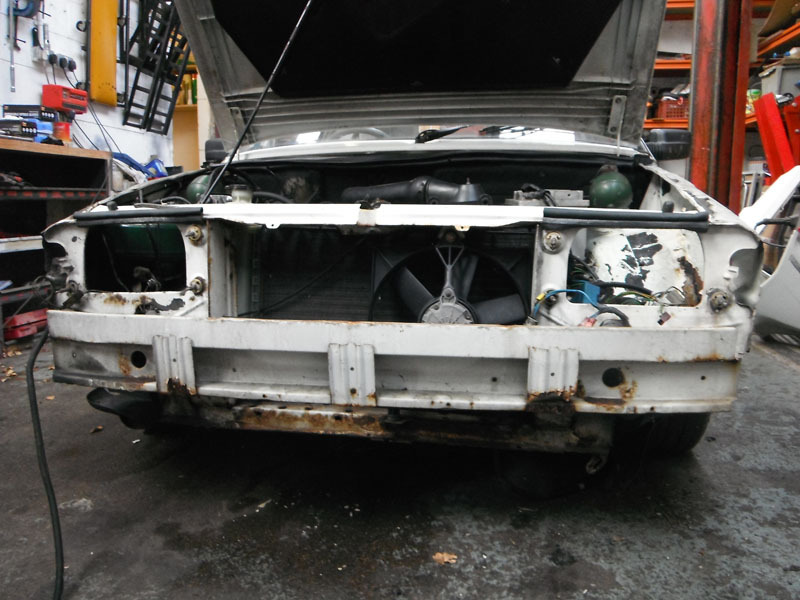

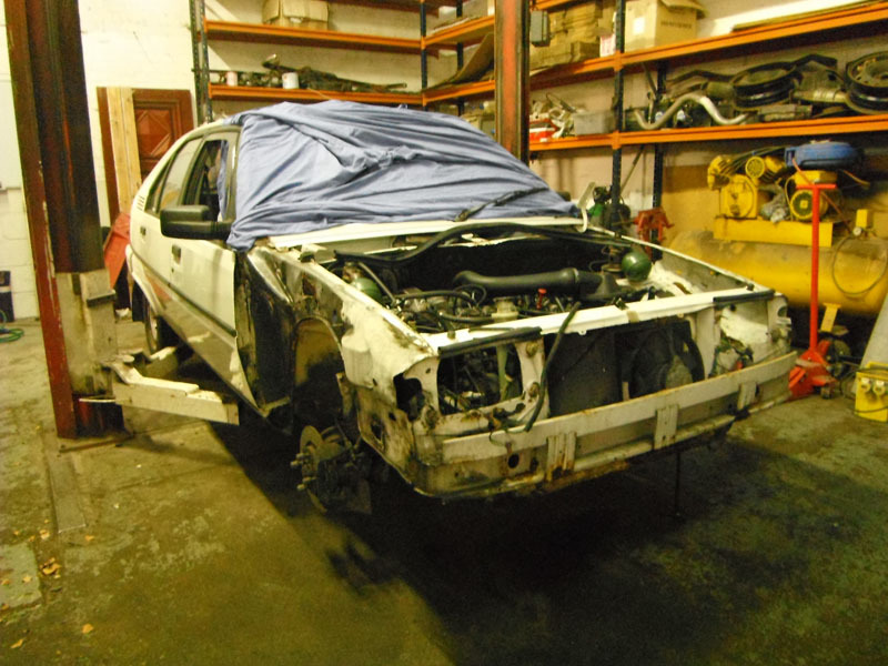

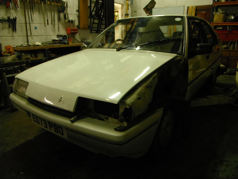

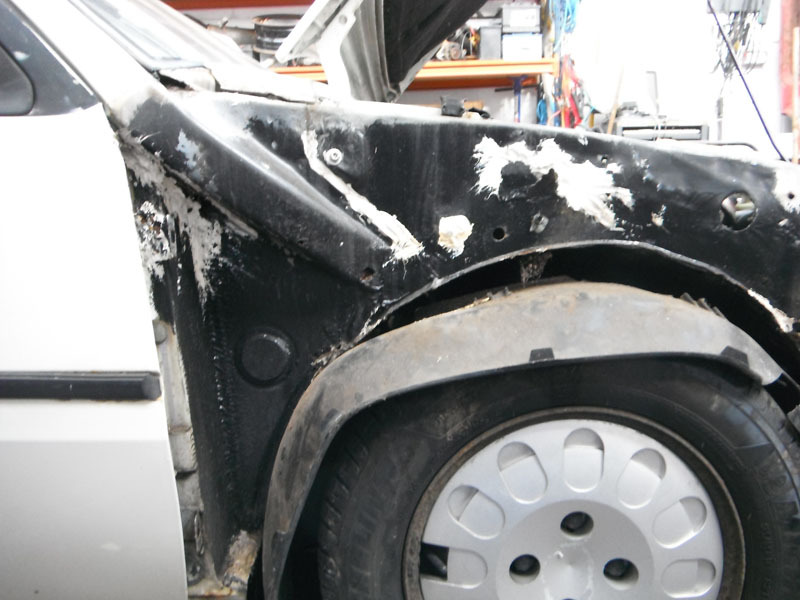

Then I decided the best course of action was to strip the front end down. I was going to have to take the bumper off anyway to sort out the passenger side, and it was so easy to remove the rest of the panels and lights it would have been daft not to do it all in one go. Lots of cableties where captive nuts and bolts should be, presumably because the daft captive bolts Citroen used had all pinged off in that way they do. I found a little extra work to be done in the front crossmember, nothing serious and all easy access stuff. Overall, it's in pretty good shape.

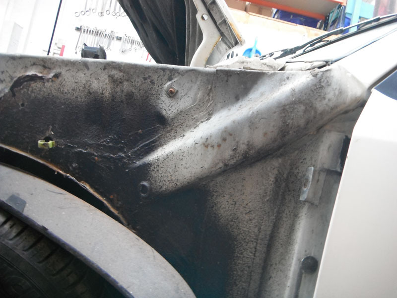

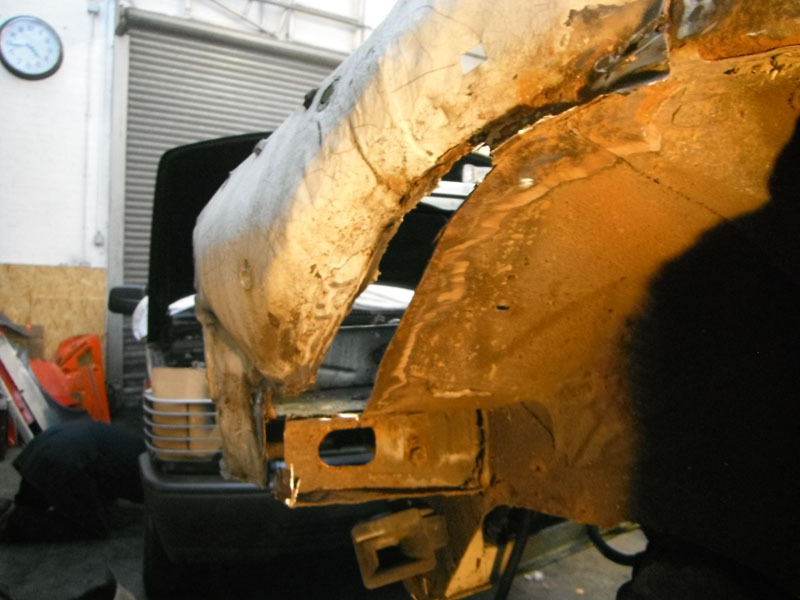

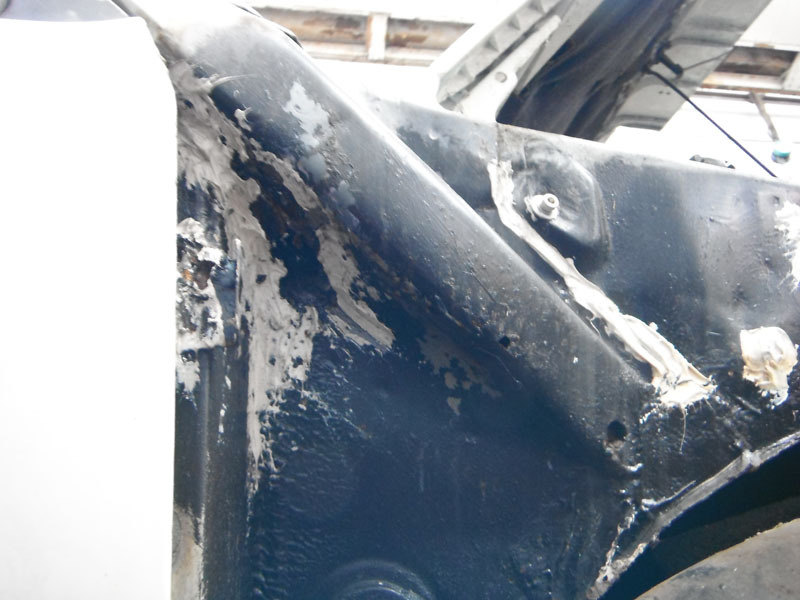

Next to have a look at the driver's side inner wing. Dean had warned me it needed work in here, it was on his to do list, so I wasn't surprised to find stuff to do. More of that white sealant stuff had to be dug out and it revealed a handful of smaller patches required of the usual sort. The worst bit is on the outer wing side of the inner wing where the suspension sphere sits, a common place for BXs to go and not terribly involved to repair. Happily, the front lower part of the wing that the bumper slots into is in excellent shape and will provide a perfect pattern for rebuilding the passenger side. Here's some before and after shots.
This had all taken rather longer than you might expect, so I wasn't going to get any welding done today. Instead, I focused on getting things started on the passenger wing, so the first job was to explore the rusty bits to see what I was dealing with. The bumper hanger on this side had sat in a modified bit of bracketry wedged into the rust hole, which worked and wasn't done in a way that damaged the bumper or original hanger. I'll now just be putting it right again with fresh steel. Thankfully, the reference point for the bumper slot on the leading edge hasn't rotted away so I shouldn't have too much trouble lining the repair piece up in the correct place. Everything from the suspension point back looks in good shape, there's been at least one reasonable repair made that I don't see any need to redo.

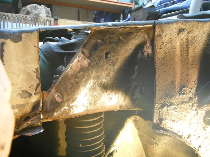

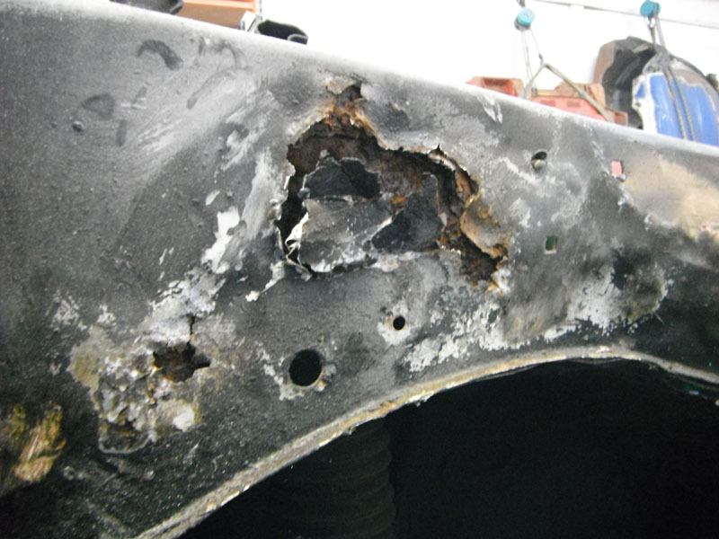

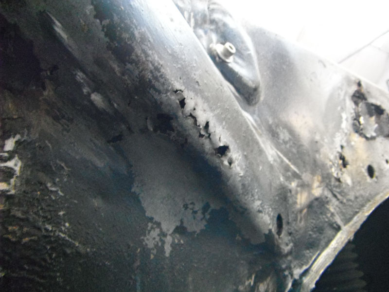

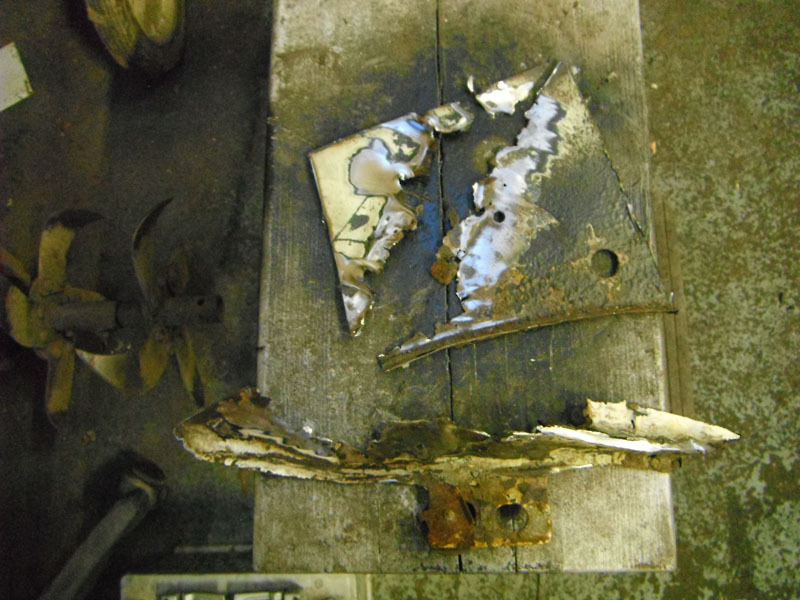

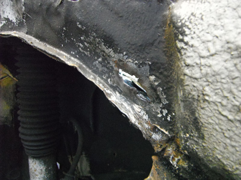

With things explored, I had enough time to start chopping out the rusty bits. Almost every piece I need to replace is flat, with excellent access, so this should be about as enjoyable as these jobs get. I chopped out quite a large square for the piece next to the suspension. This was so it would be easier to both clean up the inner skin which needs a small patch letting in, and so I could more easily weld in the repair patch which I'll make out of fresh steel.
I then started cutting back the rust in the inner arch. Again, this is a much simpler shape than it first appears since it's essentially a long curved rectangle for the most part and won't be difficult to fabricate.
From inside the engine bay you can get an idea of access a bit better, especially now I've moved the wires out of the way. The little outrigger type piece under the car is still really solid so I just need to finish trimming out the platform that goes between the headlight and the inner arch where it's rotten so I can let a new square in. That bit will be a little trickier just because I can't dismantle things further for access, other than that it should be easy enough to repair since it's just another rectangle to go in here with no fussy bends and wiggles.
I saved the pieces I cut off for reference, even though I can template from the other side if needed, there's nothing of them I can really use again beyond that.
Then it was time to go home. Car looks a bit forlorn with all the front stripped down.

Talk about getting stuck in, nothing but respect, admiration (&, just maybe, a little envy) - good luck!
That rear No: plate font isn't legal now BUT, in reality, unlikely to be a problem as it's been there since before the Regs. changed. If you want a matching front one, photocopy at least the centre section of the back plate, send it to customerservice@myshowplates.com & explain what you want. They'll do the necessary & send you a "proof" for approval, before actually making up the plate.
Can't agree with a 3rd fixing on the back or, more importantly,drilling another hole in the bodywork; I'd suggest a discrete frame, to provide some rigidity.
