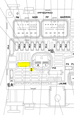

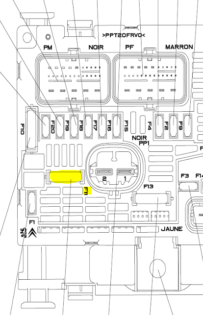

- x 6957
Re: Fan ressistor c5 2009
Yes, it's F11 and a 40 Amp fuse, located in the Engine Fuse Box: I've marked it in yellow on the second diagram.
