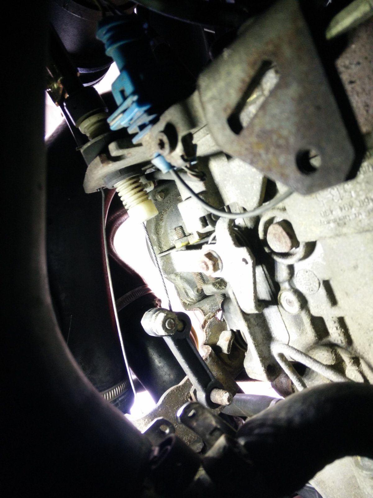

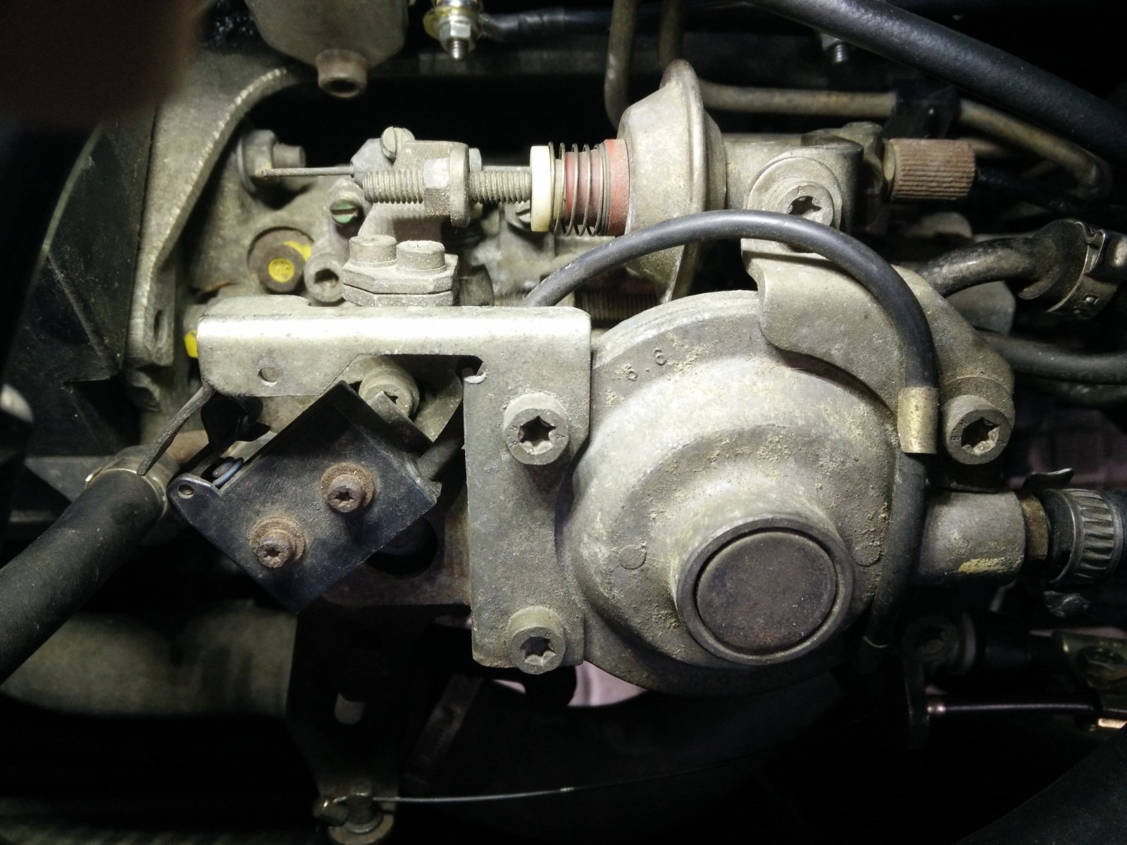

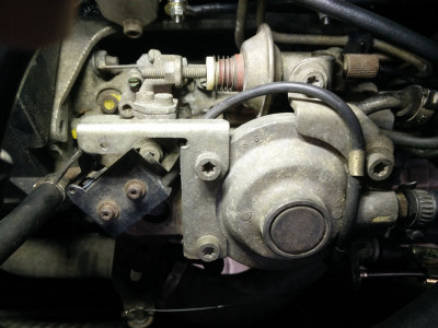

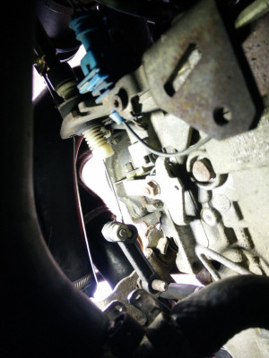

The injection pump shows the big number 513-5. It is almost impossible to read the small numbers on it. Please let me know if this is sufficient to identofy the pump.
Regarding electronics in the pump:
I had to remove the immobilizer electronics that control the main valve because the car did not start anymore. Now this valve is controlled by the ignition switch directly. This piece of electronics was under a metal piece of several millimeters thick. As far as I can see this was the only electronics circuitry I could identify. Although there is still the blue connector in the picture. And some kind of black switch on the top.
I also attached some pictures of the pump. Maybe this helps to identify it.

This photo shows (circled in red) an electrovalve fitted to the timing port (with the two torx bolts) of the Bosch pump.
This is just one variant but gives you an idea where the timing device would be, if attached.

Definitely found this valve. What does it do? Can I check it? Could it be the cause of the smoke when cold?

I believe it is a cold-start timing device. ie, the pump still needs to be timed correctly for the device to work as accurately as intended.
The proper way to set the timing requires a measurement set by rotating the pump within it's slotted mount holes.
You could experiment (trial and error) by scribing the current position, then making adjustments and see what difference it makes.
The cold-start device changes the fuel pressure operating on the timing piston, according to other engine data.
I would say get a Lexia/PP2000 on it but I'm not sure it can be fooled into believing it's interrogating a Citroen/Puegeot. Worth a try if available?
One quick test you could do with the engine off, apply 12v+ to the terminal and listen for the valve click indicating the solenoid is being energised moving the valve.
You could also detach the solenoid power cable and see if the engine seems different after a cold start? ie, difference in starting, smoke or engine noise? If you do notice a difference, presumably for the worse, that would indicate it is functional and able to respond to ECU demands.

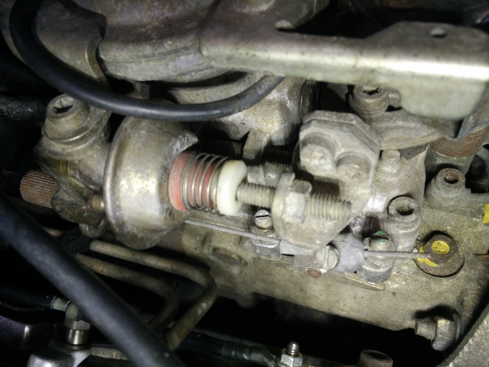

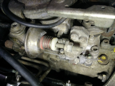

Just checked the wax-stat cable again and although it seems to work and move freely I found that the settings for idle were so that there was very little movement possible of the wax-stat cable because of the screws for adjusting cold and hot idling.
The cold idle was around 800-900 rpm. I do not know what it should be when cold but I decided to increase it to make the wax-stat movement some more.
Now the cold idle is around 1100 rpm. Although there is still smoke, there is absolutely a difference but difficult to explain:
- When cold idle is 800-900 it gives almost continuous puffs of smoke and a continuous rough noise.
- When cold idle is 1100 it seems like after starting it gives puffs of smoke and a rough noise for short periods with an interval of about 1 second.
What should cold idle be adjusted to ideally? What is the max. to adjust it to?
Carlo
