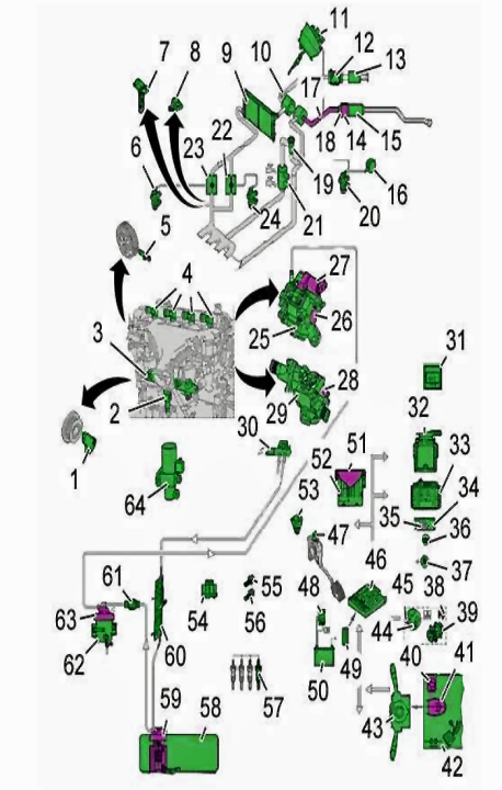

Ok, so here are the main components of the Siemens Injection Engine Management System with designations in the following table I've constructed:
Click Diagrams to Zoom
ReferenceDesignationReferenceDesignation
1Engine speed sensor33Stability control ECU
2High pressure fuel sensor34Trip computer
3Fuel high pressure common injection rail35Service LED
4Diesel injectors36Pre-heating warning light
5Camshaft position sensor37Diagnostic warning lamp
6Cold air circuit electrovalve38Fan assembly/chopper
7Air intake temperature sensor39air conditioning compressor
8Inlet manifold pressure sensor40Cruise control safety switch
9air/air heat exchanger41Cruise control switch
10Variable geometry turbocharger42Cruise control switch
11Boost pressure regulation pneumatic capsule Boost pressure regulation repeat sensor43Switch module (at the steering wheel)
12Air flow meter44Engine coolant temperature gauge
13Air cleaner45Fuel level indicator
14catalytic converter46Built-in systems interface
15Particle filter47Accelerator pedal position sensor
16vacuum pump48Double injection relay
17pre-catalyst49Centralised diagnostic socket
18Exhaust gas temperature sensors50Battery
19Electrically controlled EGR electrovalve51injection ECU
20Turbocharging pressure regulation solenoid valve52Atmospheric pressure sensor incorporated in the injection ECU
21Exhaust gas/water exchanger53Vehicle speed sensor
22Hot air butterfly housing54Pre-post heat box
23Cold air butterfly housing55Clutch pedal switch
24Hot air circuit electrovalve56Brake pedal switch
25High pressure fuel regulator57Pre-heater plugs
26high pressure fuel pump58Fuel tank
27Fuel flow actuator59Tank unit/fuel pump module
28engine coolant temperature sensor60Fuel cooler
29Coolant flow electrovalve (by pass)61Manual fuel primer pump
30Fuel temperature sensor62Fuel filter
31Heated rear screen63Electric fuel heater
32automatic gearbox ECU64Coolant degas solenoid valve

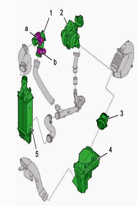

Here are the Air System Parts:
" a" Hot air.
" b" Cold air.
(1) Air mixer (MAGNETTI MARELLI).
(2) turbocharger (GARRET GT 1749V).
(3) Air flow meter (SIEMENS).
(4) Air cleaner (PSA 4190).
(5) heat exchanger (VALEO).

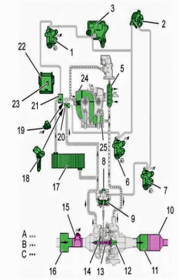

Here is a more detailed view of the Air System for this Engine:
Air circulation (as per arrows):
A: Outside air intake
B: Exhaust gas + Air
C: Exhaust gas
1Throttle Housing Control Electrovalve (EGR)13Variable Geometry Turbocharger
2Vacuum Pump14Air Inlet Turbine
3Vacuum Reservoir15Air Flow Meter + Air Temperature Sensor
4Exhaust Gas Recycling Valve (EGR)16Air Cleaner
5Exhaust Gas/Water Exchanger17Air/Air Heat Exchanger
6Air/Air Heat Exchanger Bypass Butterfly Control Electrovalve18Air Intake Temperature Sensor
7Turbocharging Pressure Regulation Solenoid Valve19Inlet Manifold Pressure Sensor
8Turbo Position Copy Sensor20Air/Air Heat Exchanger Bypass Butterfly
9Pneumatic Capsule For The Pressure Regulator Control Arm21Throttle Butterfly Housing (EGR)
10Particle Filter + Catalytic Converter22Injection ECU
11Pre-Catalyst23Atmospheric Pressure Sensor (Integrated In The Injection ECU)
12Exhaust Turbine24Air Inlet Manifold
--25Exhaust Gas Manifold

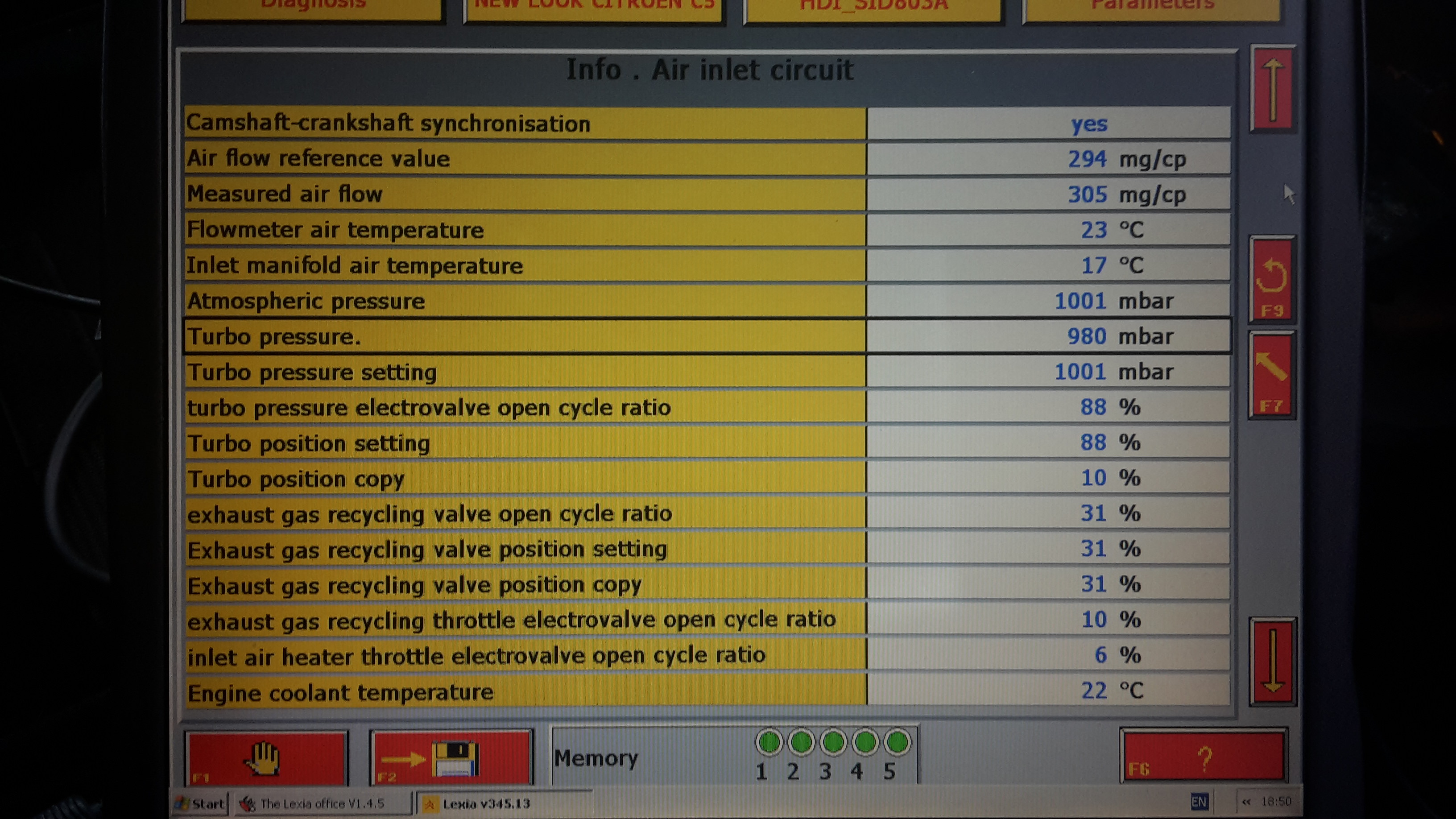

in other news i now have dialog with the car and am currently having a root around...first impressions are no vacuum...quellle surprise
and i have seen somewhere something about particle level full... :shock: well may be not that shocked
quick actuator test as well...EGR was heard to make some noise
see you all later :-D

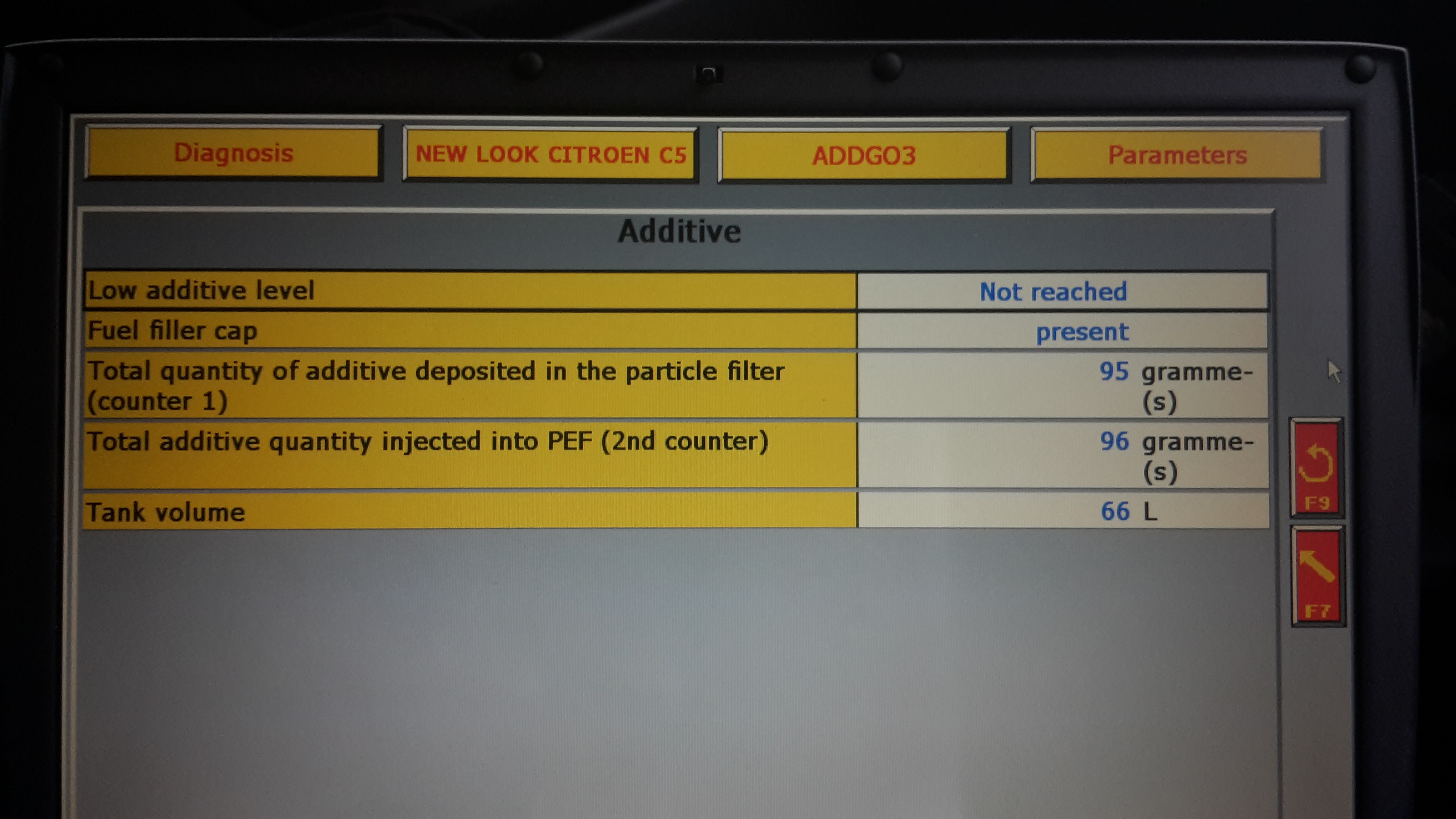

Re: 'HDi's for Dummies' diagrams?
Unread post by old'uns »

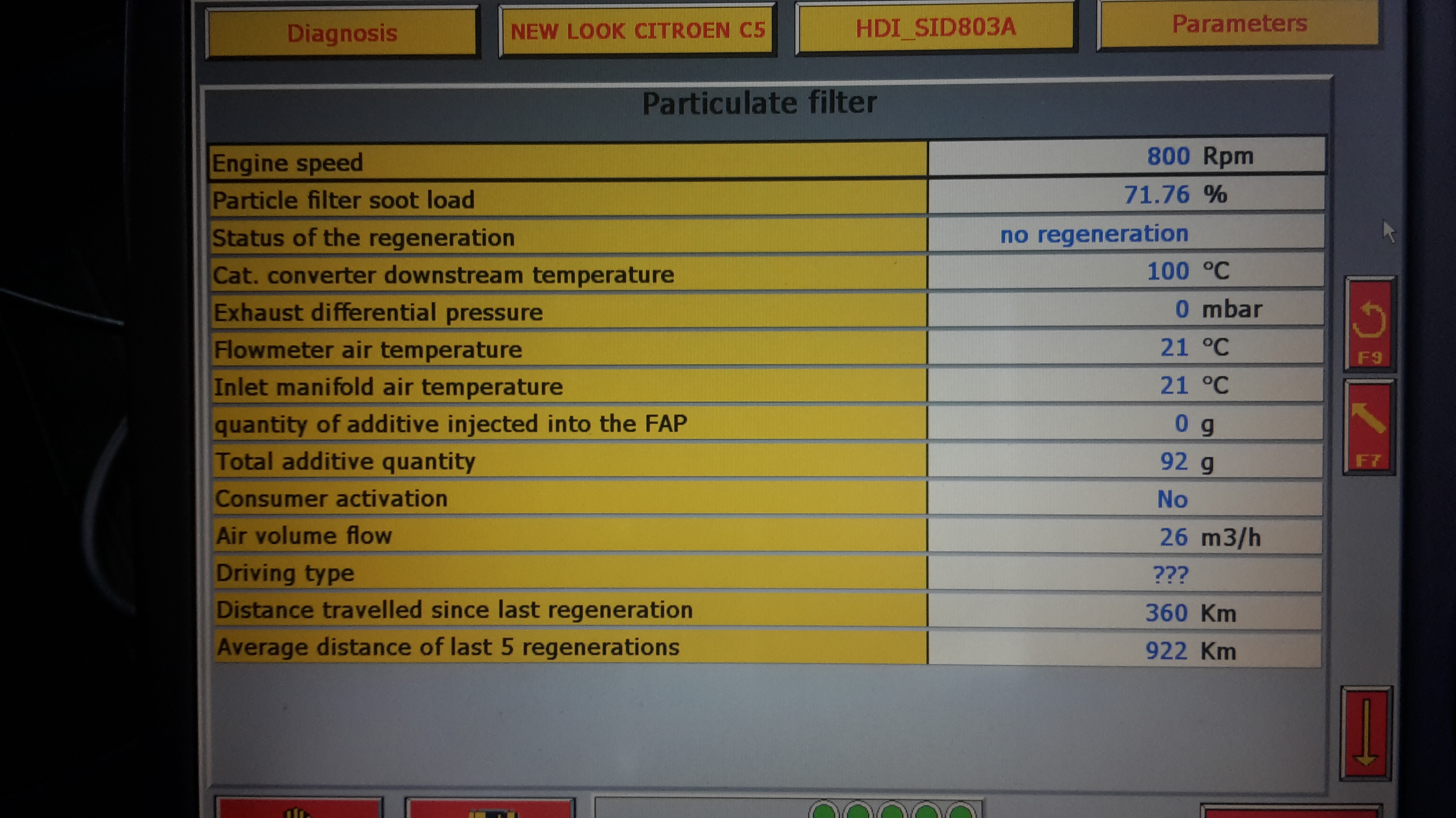

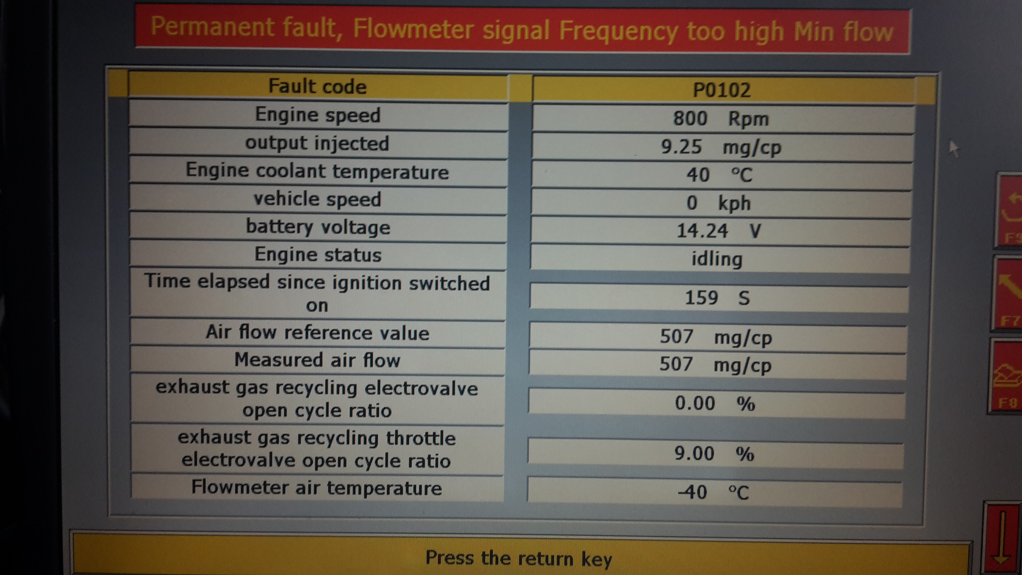

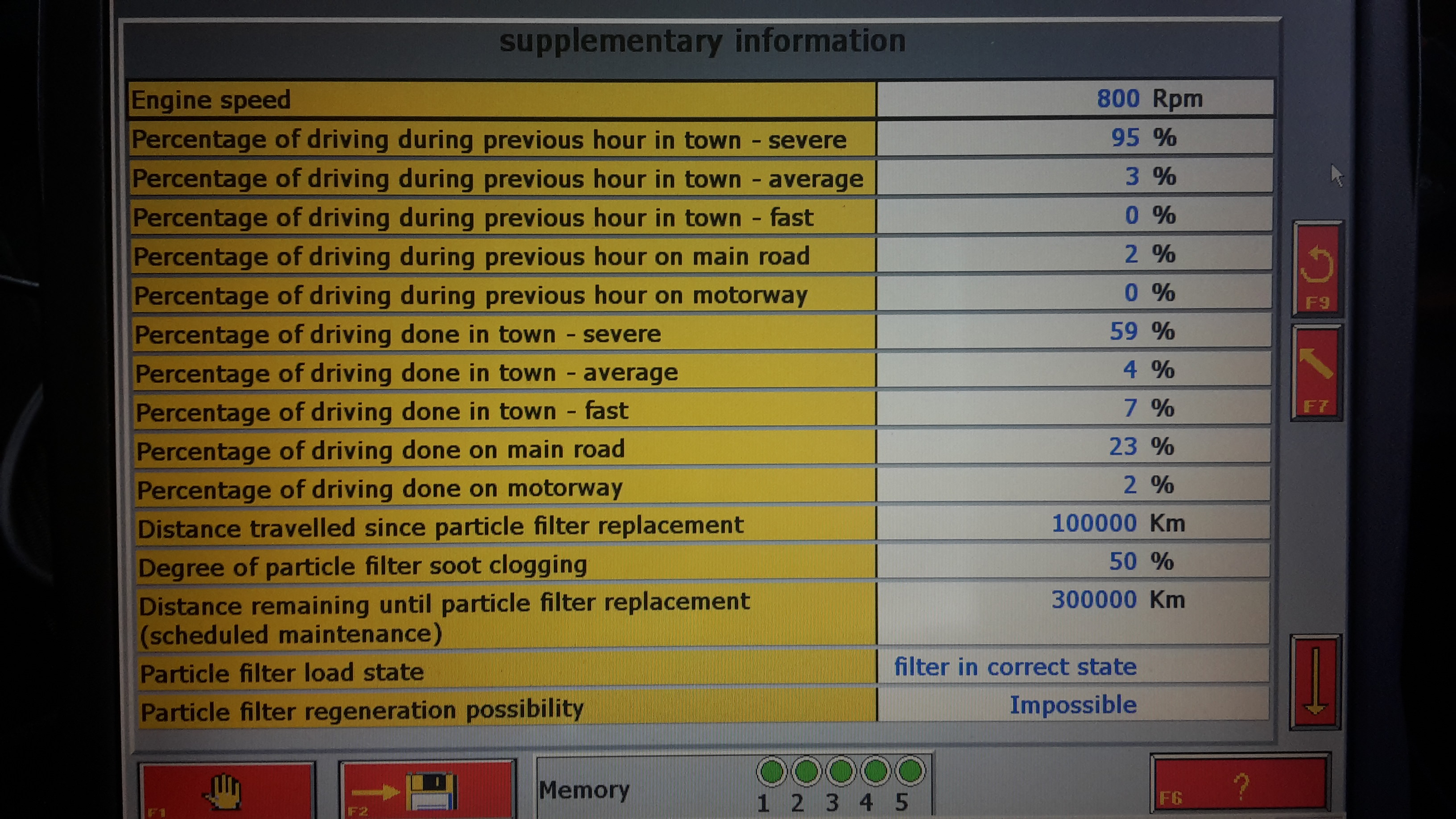

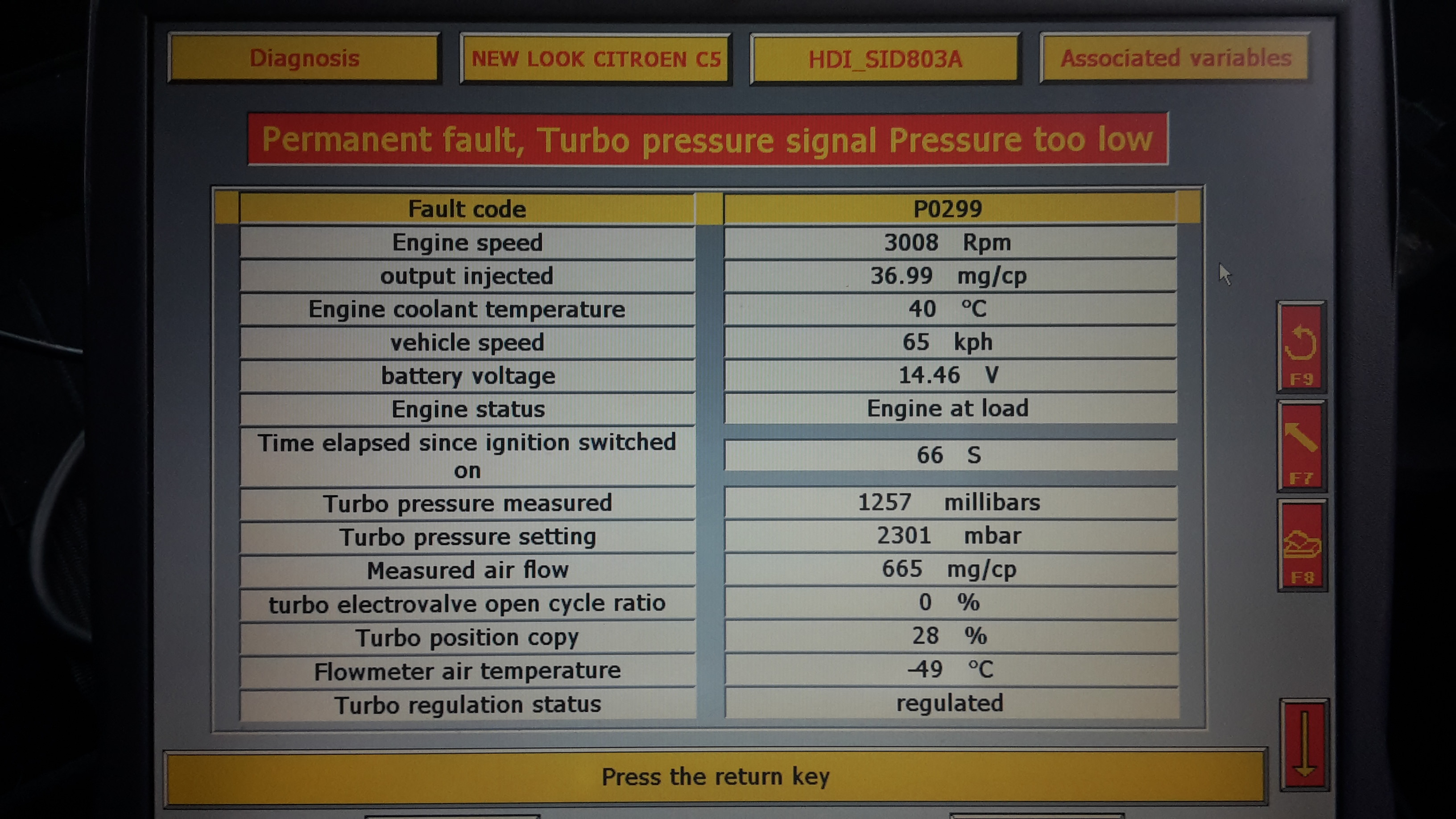

a bit of technical reading for someone.....
no vacuum?
flowmeter air temperature -49 ?
DPF not blocked? airflow air temp now +21 ? good or bad?
additive injector tested and sounds heard so OK?
airflow air temp now back to -40
just as an after thought, is it a possibility that the vacuum pump has failed hence why someone previous 'bodged' the lines?
x 6946
I shall have a squizz at those codes tomorrow Dave
