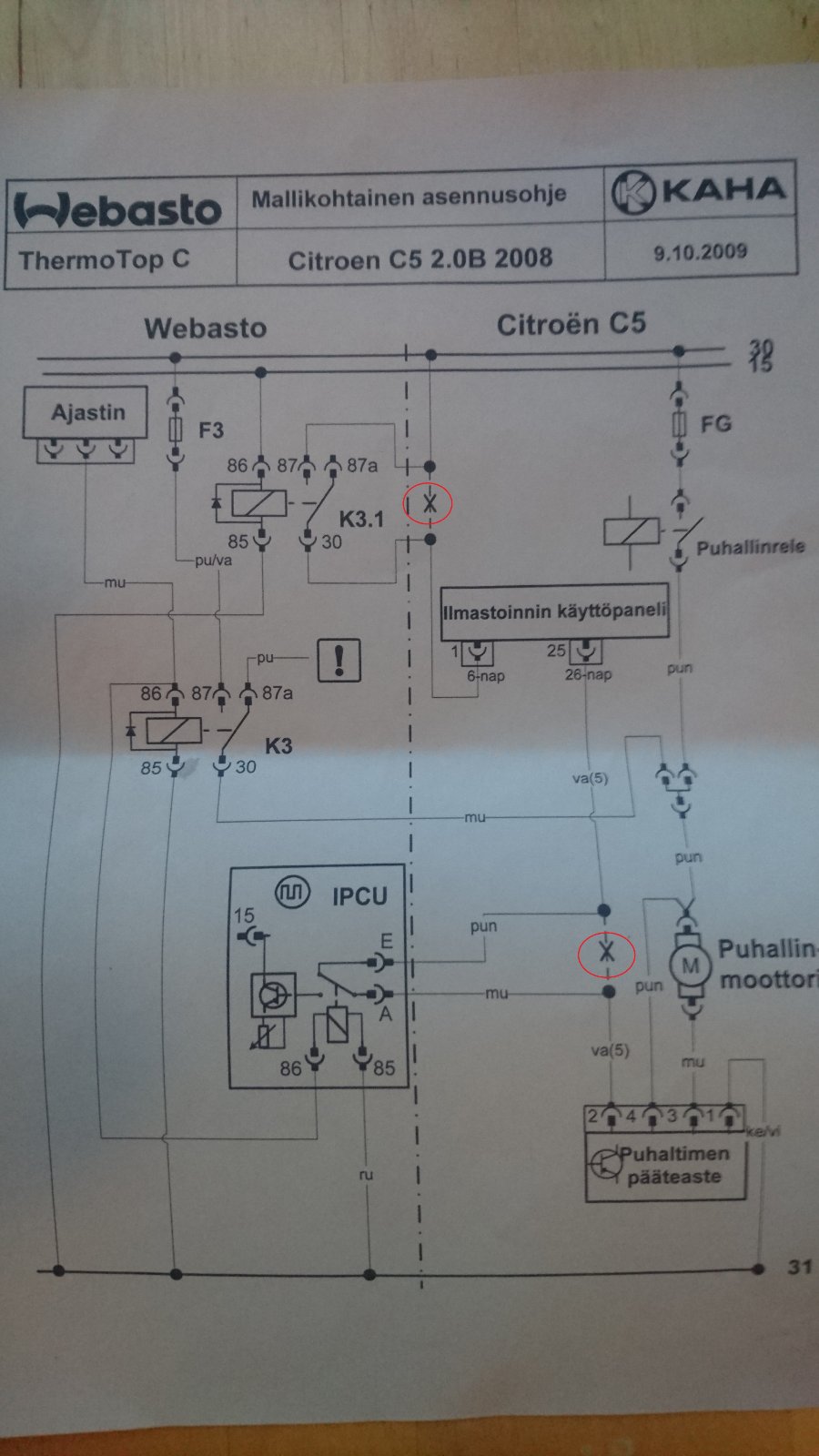

Well, looks like car electrical components are totally ok, except: webasto relays cold be someway burned, ralays wont work like should. When i connect those wires (red circles) direct ac and blower works fine?! Really weird thing??!! What could burn those relays while installing wires?!! I have not touched those wires??
