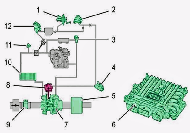

GiveMeABreak wrote: 10 Jun 2018, 23:46 This is for the Siemens System fitted to this vehicle. Number (9) is the Pneumatic capsule.
Click to Zoom
Air circulation (as per arrows):
A: Outside air intake
B: Exhaust gas + Air
C: Exhaust gas
Legend
No intention on hijacking the thread but this diagram shows clearly that the Air Doser is indeed part of the EGR system (Components 1 and 21)
Is this likely to be any different between the Siemens ECU as fitted to this car and the Delphi ECU that other DW10B engines have?

Re: C5 Mk2 2.0 HDi fuel tank gives pollution error, .. resolved at last
Some differences as you can See Elis:
EGR Circuit C5 X7 DW10BTED4 FAP with Delphi 3.4 Injection
Unread post by EDC5 »
Great, thanks for digging that out Marc.
That's all the confirmation I need that the intake throttle is part of the EGR system.
