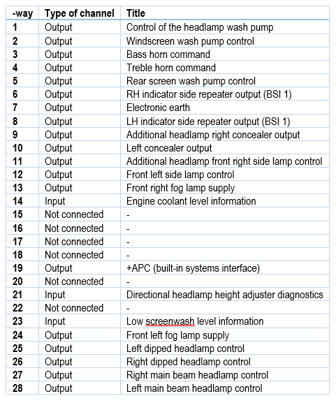

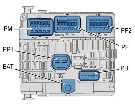

The engine fusebox Module 2 supplies the power to these systems and communicates with the BSI. In the table below, you will see Connector PF that shows the pins which carry the signals to the components in the large table:
Click to Zoom
Connector PF Table Pin DesignationsPF Connector
So I would check the pin connections for 7 for the electrical earth, 9 & 10 for the Concealer/ shutter function, then 25-28 for the Main / Dipped operation. Always disconnect the battery first and also be aware that Xenons can retain capacitive current after the battery is disconnected. Follow the BSI procedure when reconnecting the battery.

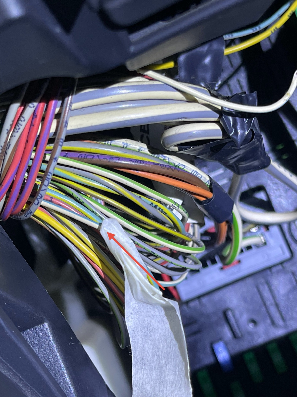

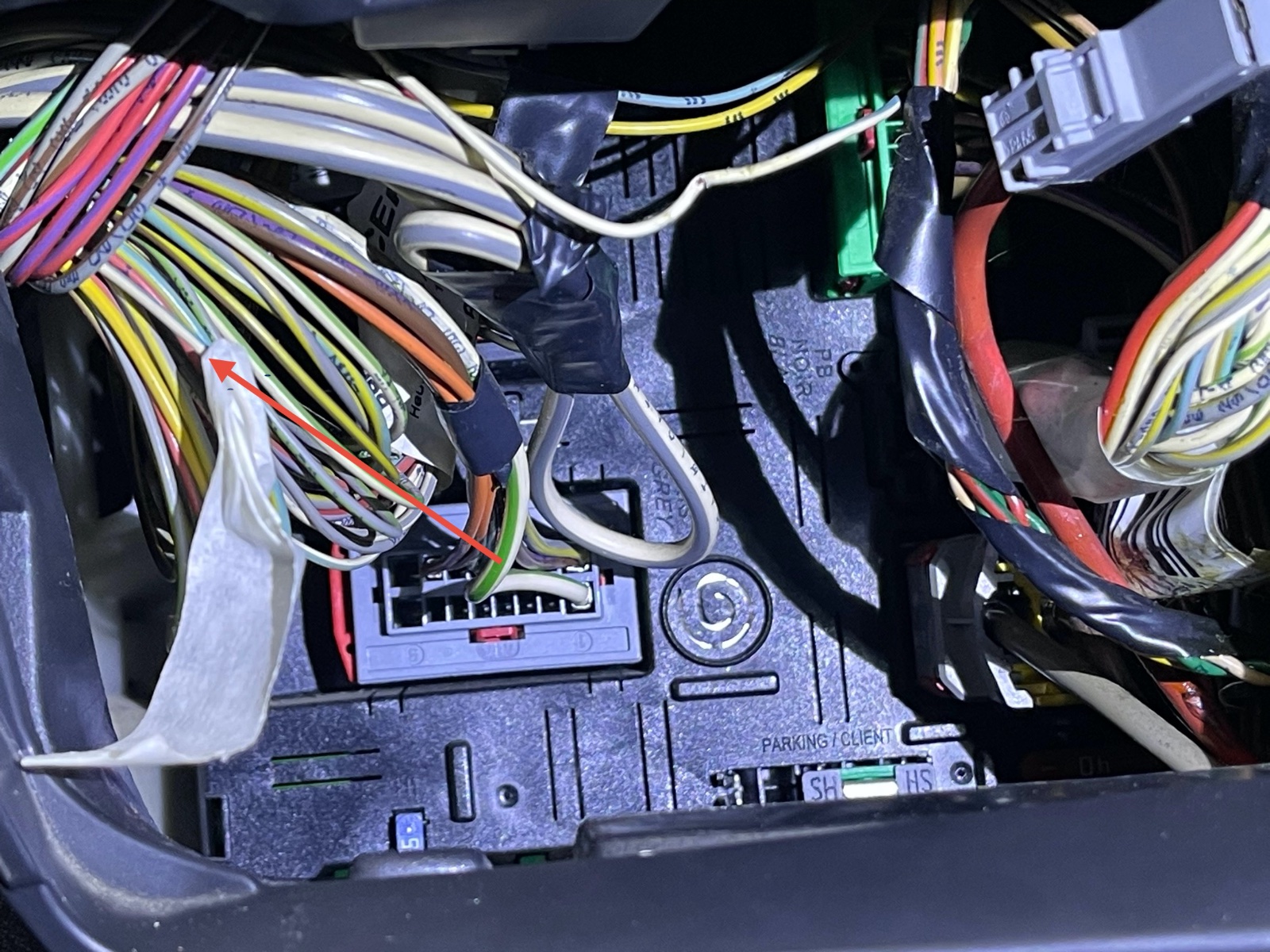

I found the ONE...
cable of roof light (not fuse F7) the one that dims
