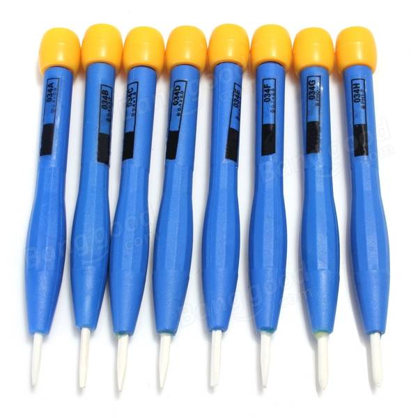

There are three seals for each ram, when disassembled I could find only two grooves with the seals in, after a bit of looking the third seal was under one of the others. Very tricky picking out the old seals from the grooves without scoring the bore, take care here, I used a paper clip sharpened at the end plus one of those very small screwdrivers to pick the seals out.
I find these antistatic screwdrivers useful for such tasks
I got mine from eBay possibly a different seller though
https://www.ebay.co.uk/itm/7Pcs-Full-Ty ... Swz2tZnq3I
The tips are ceramic so won't damage the ram if used with caution - they are easy to break though

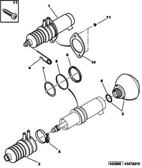

Spiff - I listed the parts back on the first page, but repeated here for convenience:
Number 6 is the Sphere Seal and is Part 5272 15 - £5.10
Number 7 is the O-Ring and is Part 5272 28 - £1.69
Number 8 is the Suspension Cylinder Sliding Seal and is Part 5272 30 - £4.54
Number 9 is the Weatherstrip and is Part 5272 32 - £2.78
All the above are VAT inclusive prices and are for single items.
The same seal (Number 6), Part 5272 15, is also used for the Centre Rigidity Regulator Spheres

To stop the ram from leaking I had read there were three seals, two of which are used together.
I see 7 8 & 9 which look to be three separate ones ?
Are these the parts I require

Spiff, these are the Citroen main dealer part numbers, so you can call your nearest dealer, give them these numbers and they will order them in if they don’t already have them in stock. I can’t help you with regards to the seal you need without seeing it, so you have the lot here for reference.
Yes they are all separate to answer you question and if you look on the diagram they each go in a particular location on the ram. So it might be prudent to order one of each of 7,8 & 9.
