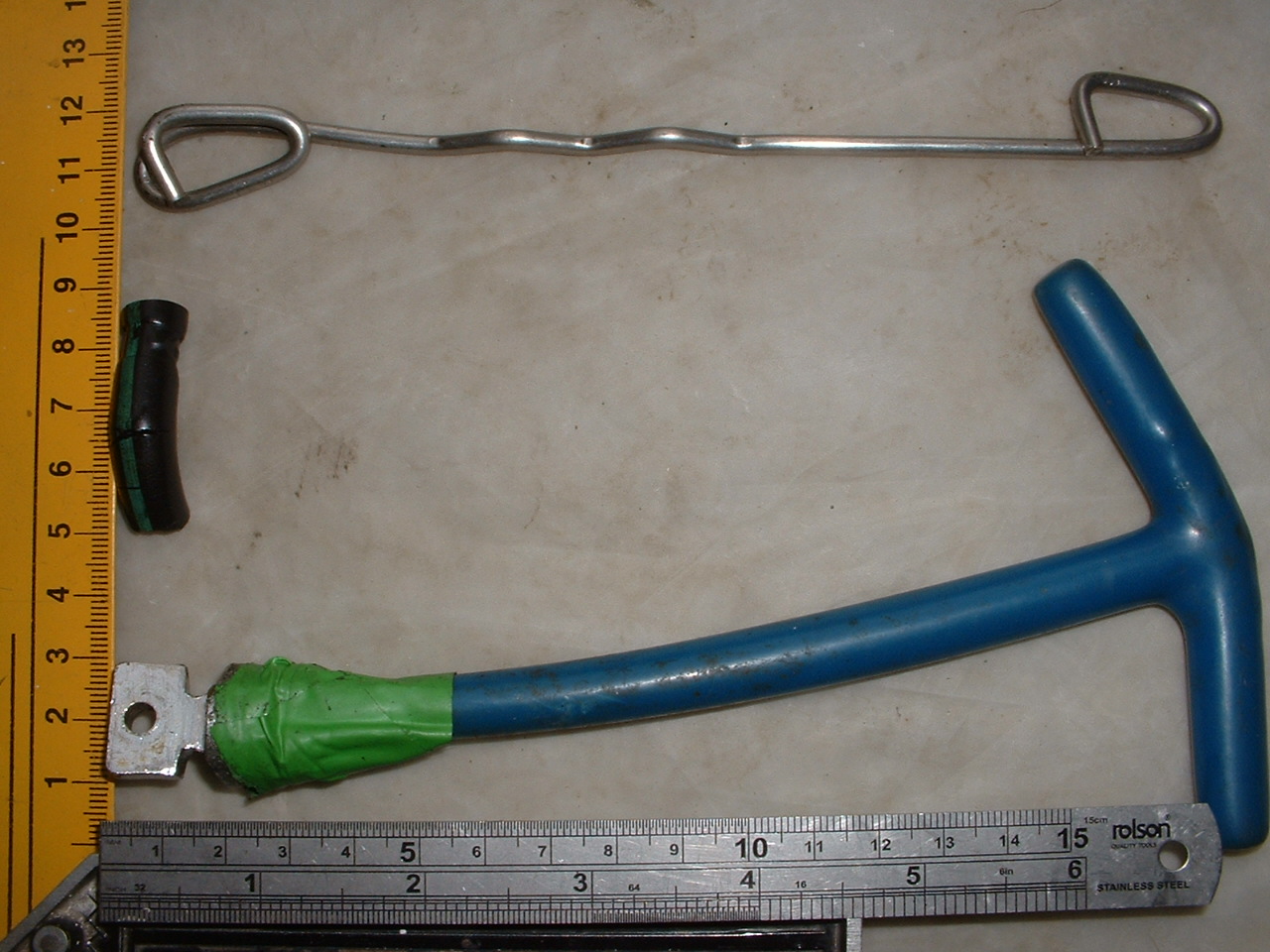

Slowly slowly ....had to make another tool for the clutch as the force required to engage the snap ring onto the pressure plate was immense ... clutch slave cylinder engaged....foot pressure 'feels' good

Clutch tools
Top - is a wall-tie bent to suit but couldn't grip enough to apply the force required.
Bottom - is a modified (engineered by angle grinder) swivel socket tool that done the job (just).
Middle - low pressure rubber return line.

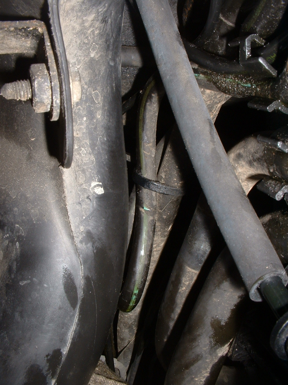

Rubber low pressure return pipe was the culprit, started her up today and found it, luckily it was near the join with the metal pipe so I was able to cut the damaged end off and re-bore the plastic pipe in situ with a drill bit. Looking closely at the pipe it was on the back of the pipe and I guess just disturbing the LHM reservoir was the final straw. If you can see on the 'tools' photo there is a split on the bend and another couple of cracks developing so all in all it was a good time for it to show up - not too much to remove for access and the car was at home anyway
The 2nd photo also shows up another potential leak point where a plastic tie has been used

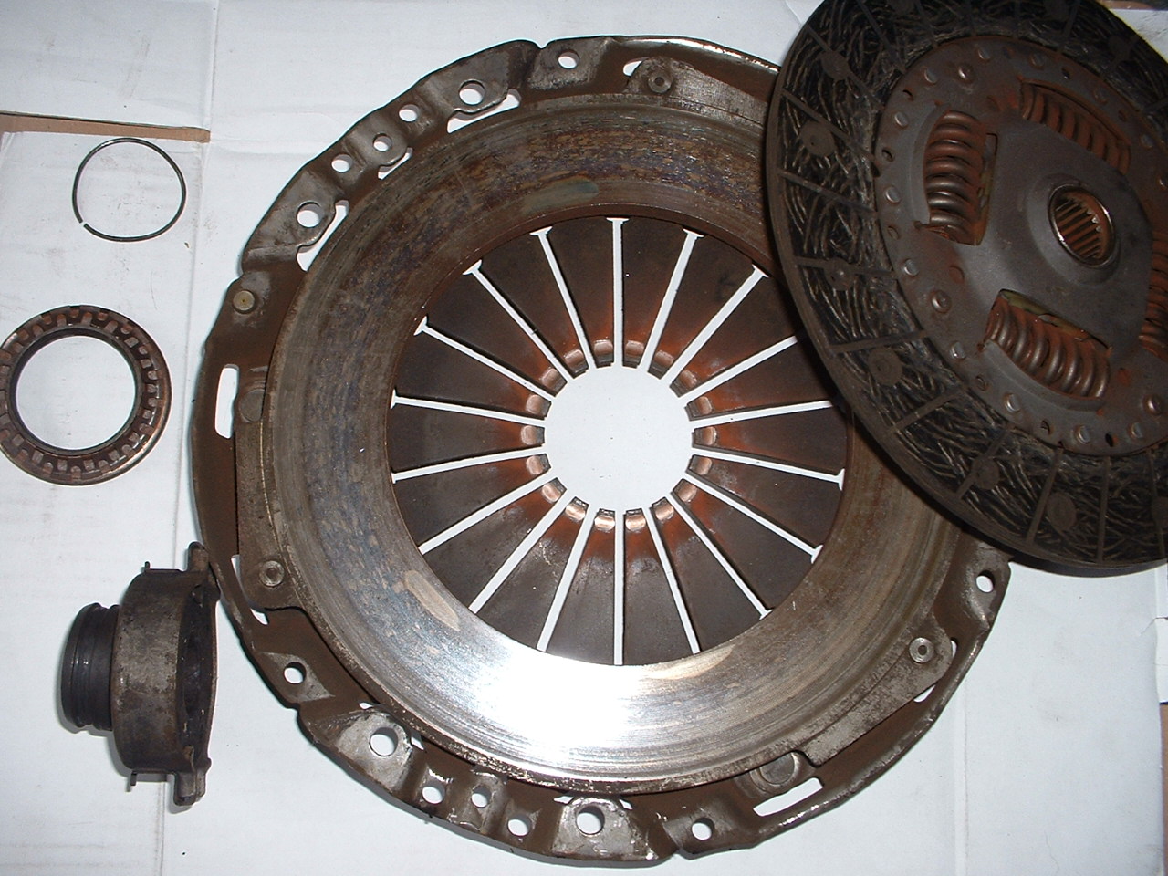

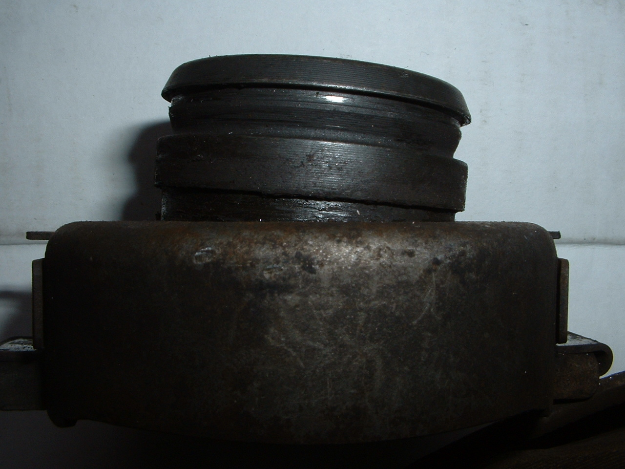

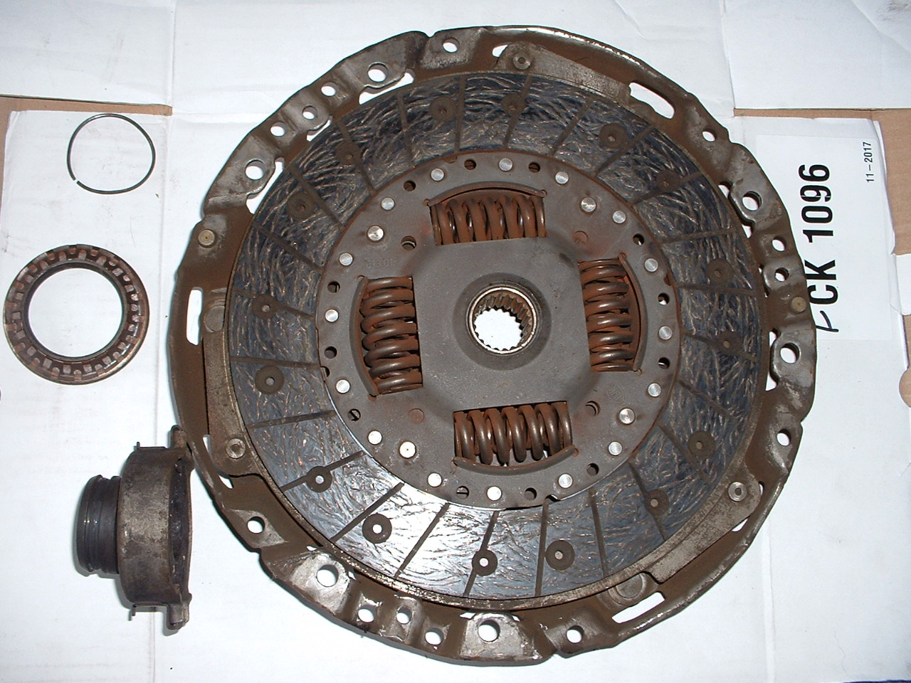

2nd hand clutch/pressure plate anyone - 130,000 miles old
Release bearing seems a bit bent (could have been done during removal though)
More delays ...It seems she's enjoying her holiday. Taken me 3 weeks tomorrow

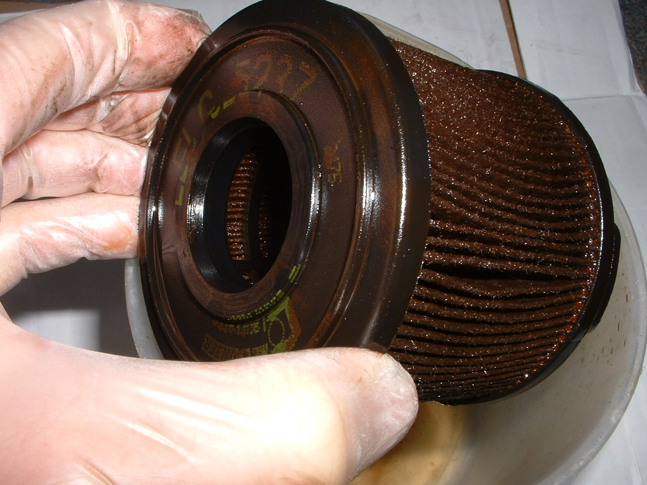

). Then I thought I'd get her in normal height and just test the clutch on the driveway. When I moved the height lever the fuel filter spurted diesel everywhere. I had prior to striping down been trying to trace the leak which I thought was coming from the fuel/water drain off tap. Hindsight is a wonderful thing and I now think that the fuel filter is restricting flow and the extra flow to raise the suspension was too much for the seal to take, so I've ordered a new one. The fact that when I drained the filter housing and removed the (filthy and slightly distorted) filter there was still about an inch of fuel inside the housing which without the filter in was then free to drain off.
Will check service history to see if I can date last change .... but looks like the original

Skull, excellent work so far... Yours certainly had failed in the classic way...

Fuel filter fitted and sorted (last record of a change was 56K so that one pictured might have done 75K
