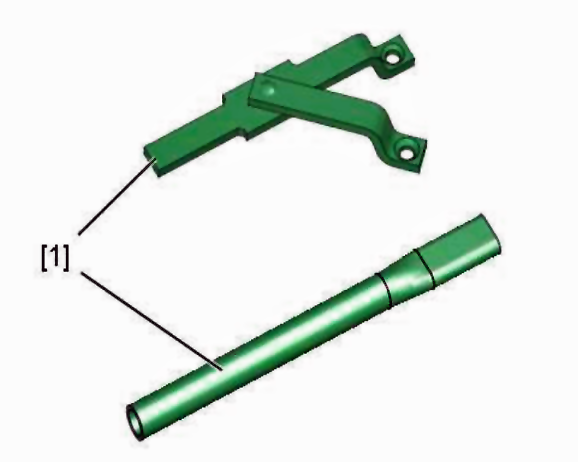

x 6962
Re: C5 X7 suspension strut fluid leak - Replacement mini guide page 2

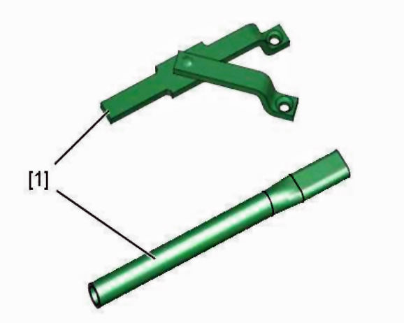

Part 6310-T - Hub Immobilising Tool:
I got mine fitted by Citroen for £186 and bought the strut from Poland for about £140 ish less. But this is the tool they use if you're feeling brave :-D
EDC5
Posts: 1218
Joined: 01 Jul 2017, 21:48
x 131
Unread post by EDC5 »

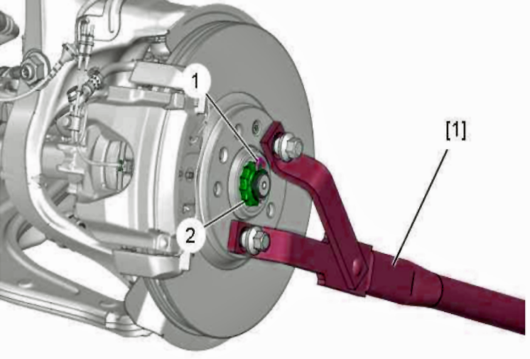

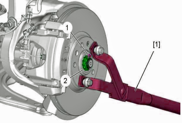

Hmm, I'm wondering how they use that to pull the hub off the driveshaft. Do they secure it to the hub and just pull on the end of the long bar? Seems like the hard way of doing it :P
x 6962
It's used to stop the hub rotating whilst undoing he driveshaft nut.

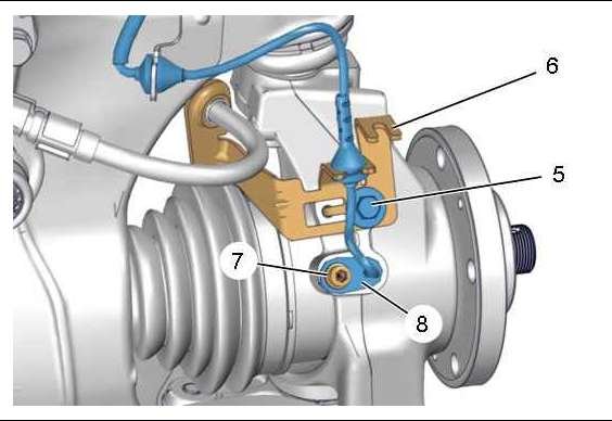

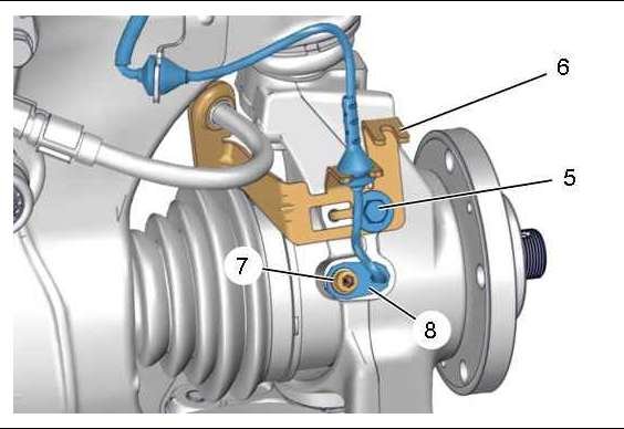

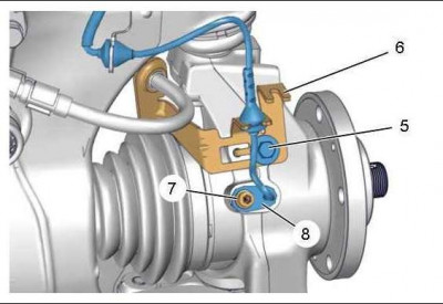

If you undo the hub nut, remove the brake disc and caliper and associated gubbins, you should be left with this :
Front hub - PSA, fair use

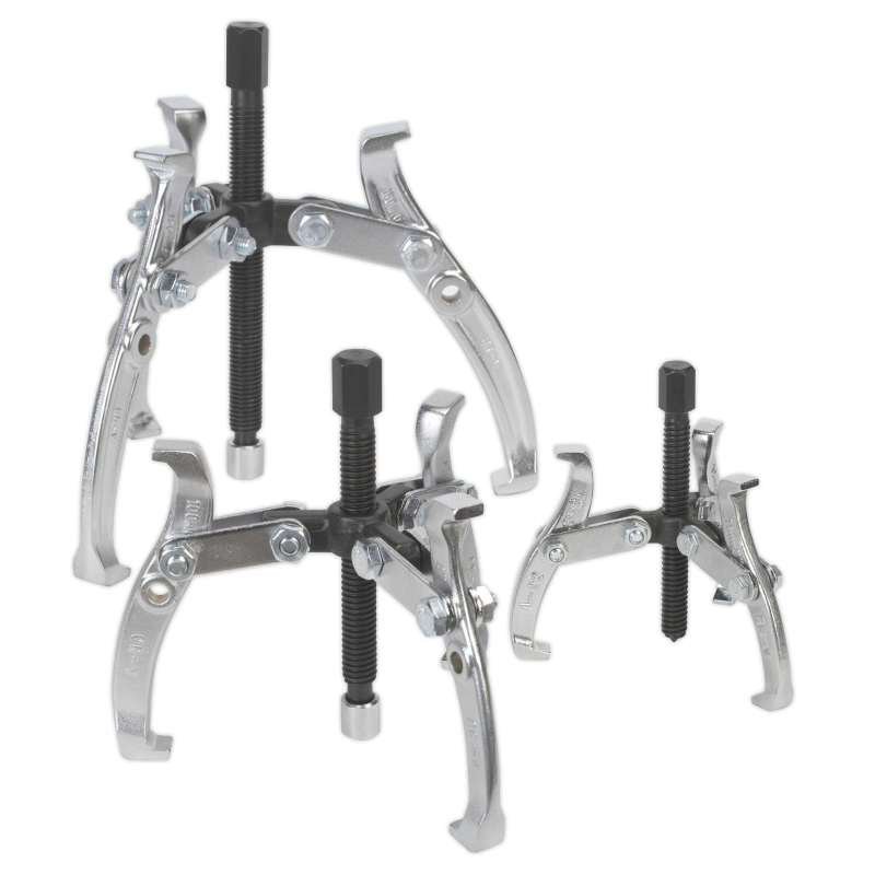

which might allow you to get a 3 legged puller on to the hub flange :
3 legged puller
3 legged puller
