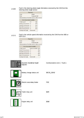

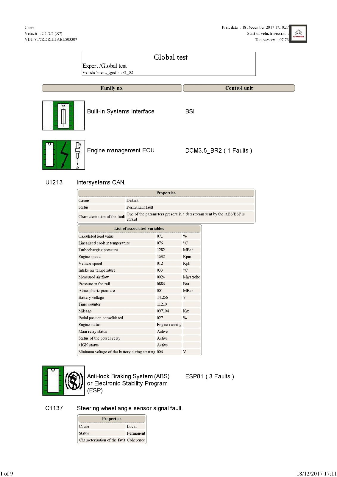

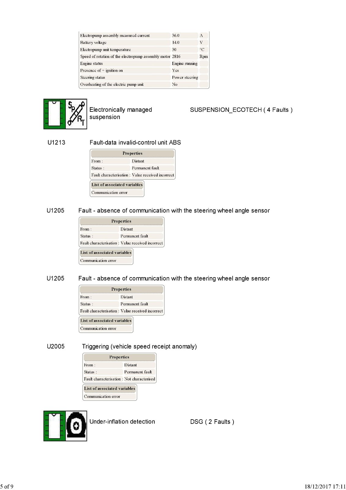

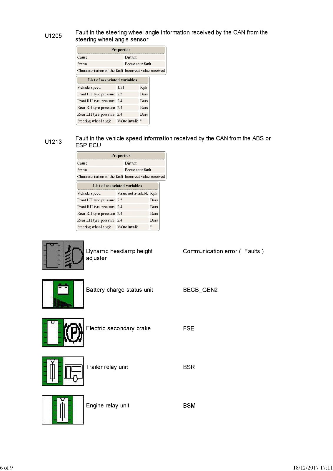

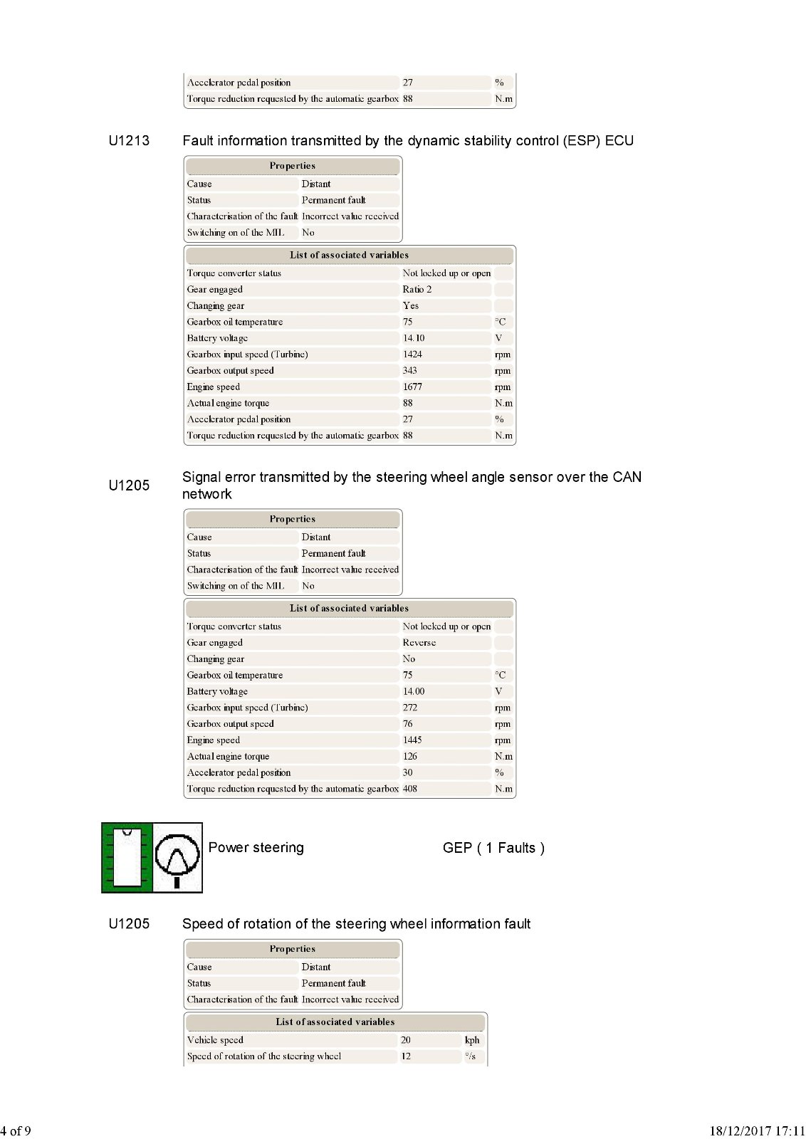

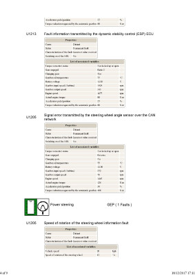

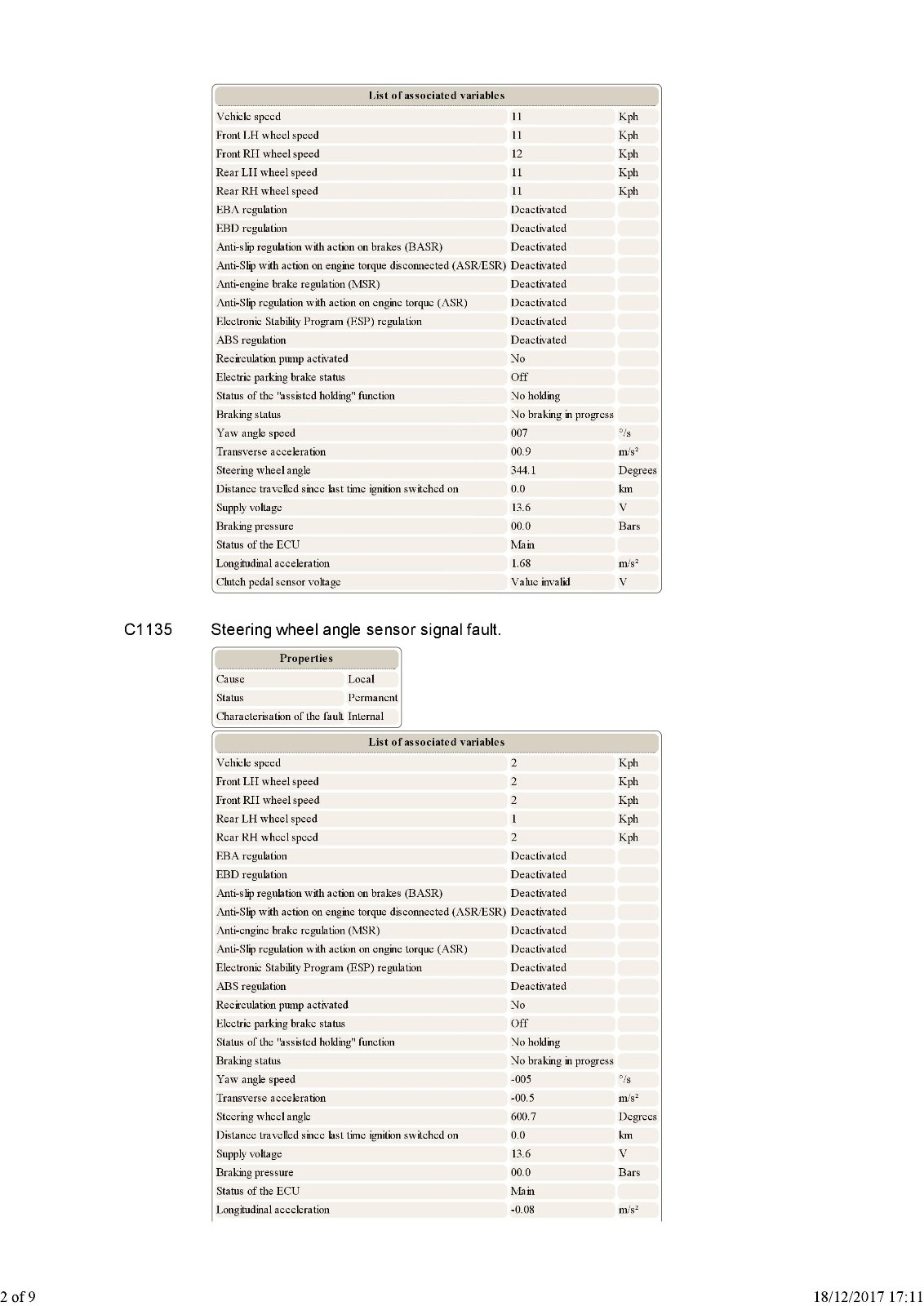

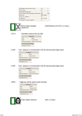

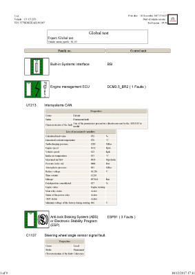

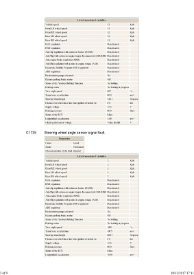

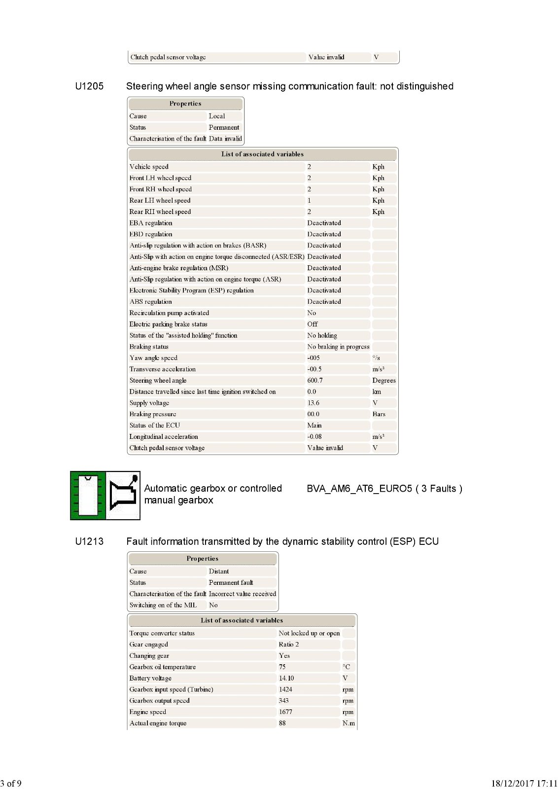

Hi All,
I now have a steering wheel that is in the correct position to the road wheels, the other rack was assembled incorrectly - to be sorted another day!!
However, I now would Like a little help working out what is wrong - please.
I have a Steering Angle Sensor fault, and this is sending the whole system (and me) crazy!
I have attached a print out of the errors I have, do any of you have any thoughts?
Additional information
- When I check the output of the SAS by moving the steering wheel either direction the value changes from 0 degrees, surely this means everything is working?
- Yesterday when I checked the SAS, my Diagbox says the unit is "not calibrated"
- When trying to calibrate the SAS I get a screen saying either there is a fault with the unit "Fault Linked to the steering wheel angle sensor has been notified by the ECU. Deal with this fault first and start the wheel angle calibration again" or I am doing something I shouldn't while the process is running like moving teh car or steering wheel.
- Anti-lock Braking System (ABS), or Electronic Stability Program (ESP) says the steering wheel angle is 344.1 degrees, but the steering wheel angle sensor signal fault says the steering wheel angle is 600.7 degrees
- I have just carried out a full BSI reset, no change.

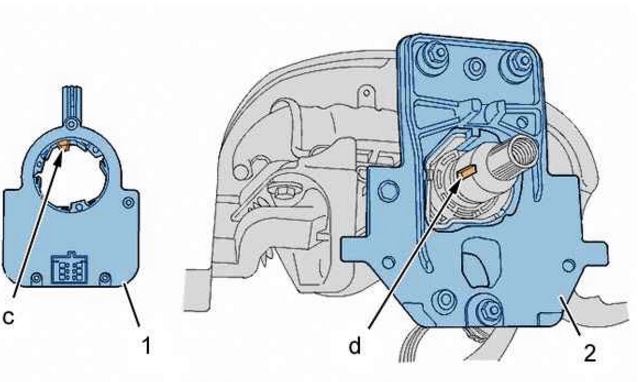

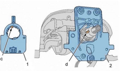

Just wanted to check the alignment Stu:
Align the foolproof "c" of the steering wheel angle sensor (1) with the groove "d" of the steering column (2). And just to confirm:

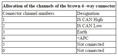

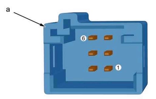

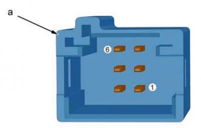

Here are the Pin Outs - in case you need to check for signal / comms issues:
Calibration is required in the following circumstances:
Removing - refitting: Flywheel angle sensor
Track adjustment
Replacement of the dynamic stability control (ESP) ECU
Replacement of the switch module at the steering wheel
Work carried out on the steering column or mounting
Does it not require you to be driving the car to calibrate it Stu? AFAIK it can't be done stationary.

Have not checked any alignment, because the steering wheel is in line with the wheels, and unless it all does something silly I can not see how the alignment can get wrong, I may get time to check tomorrow afternoon.GiveMeABreak wrote: 18 Dec 2017, 18:39 Just wanted to check the alignment Stu:

The symptoms I have are.
- ESP/ASR faulty
- Brakes activate for split second when pulling away the first time on each journey
- Suspension not at its best.

I have found some videos of the sensor, and one particularly shows what is in side.......watch the yellow dot on the small wheel at the top right. the large center wheel is the angle and the smaller one is how many time past 0.
Reading on the Peugeot forums, others have had similar issues and I now need to find out how to fix mine. What you see in the video makes sense,
I have two options.
The steering wheel angle range is +/-610 degrees. My diagnostic is saying it is either +344 or +600 which means that the wheel has been rotated between 0.95 & 1.6 turns too far to the right, I am sure I have read somewhere that a minus figure means to the left. Then recheck with the diagnostics
As to how, it could have been me trying to get the steering re-coupled upside down and forgetting where I started, or sensor over travel.
Cheers
I have two options.
- Take the steering wheel off, look at the sensor and see if there is an alignment tell tale, and make sure it is right. Apparently some Peugeot sensors have a window where you can see the dot.
- Disconnect the lower coupling and rotate the steering wheel to the right 2 turns, then see where the car thinks it is.
