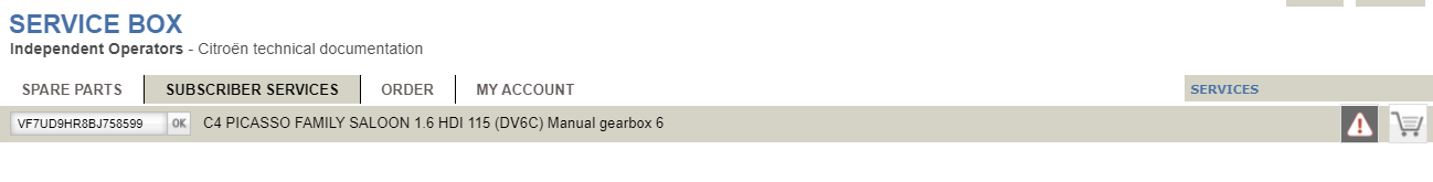

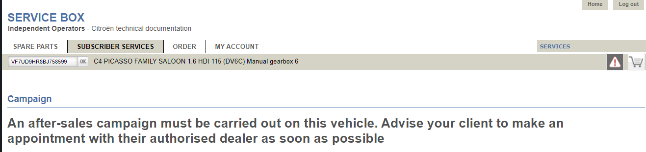

Re: Limp Grand C4 Picasso - Injector Failure
The idiots - honestly, it makes me wonder how they stay in business.
All they have to do is put the VIN into their system (tell them Citroen ServiceBox) and then the warning will come up - first in a red flashing triangle as at top right of the first picture below, and secondly when the triangle is clicked, you can see the warning in the second picture and lastly, you can see your VIN over to the left.
Click images to zoom I think I'm going to have to go and get a bl**dy job with Citroen in the training department and sort them out.

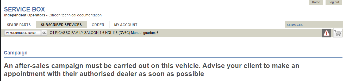

GiveMeABreak wrote: 06 Aug 2019, 17:45 The idiots - honestly, it makes me wonder how they stay in business.
Is there any chance that's just this timing belt recall that the guy was on about or is that specifically the injector related recall you spoke of earlier?
Do you have a screenshot available with more info on that little red warning triangle please?
Thanks!
Adam.
- x 6957
That is the message in the second picture Adam.
The content is only revealed on the dealer system, so I cannot tell you exactly what it is for, but I separately mentioned in the earlier post that there is a TSB (technical service bulletin) and quoted the reference for the specific combination of faults codes that you quoted in your previous post. When I searched on the specific TSB, it was all to do with he injector problems that are a cause of faults that you are experiencing.
All you need to do on that front is tell them you have the 2 codes coming up together and that there is a TSB for this issue. Tell him to look on service box under the air and fuel supply section, then go to the Diagnosis, section and it is listed there. Tell him to look for the one near the top of the list that says when these 2 codes appear. That involves replacing injectors and components as you can see from my rough translation earlier of the TSB.
