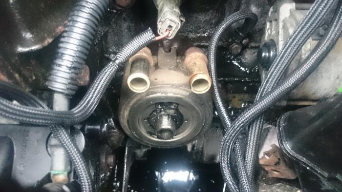

Re: 1999 1.9D DW8 Dispatch: Thick black sludge in the coolant, no mayo in the engine. Head gasket?
Got home, fitted the cooler, put the filter back on.
The new one's thinner, Which means the threaded bolt that goes through the middle is too long and doesn't hold it on securely. Dammit.
Back to the scrappy tomorrow to see if I can get its shorter bolt.
Yes, they come in a variety of thicknesses, each with a matching length through-bolt.

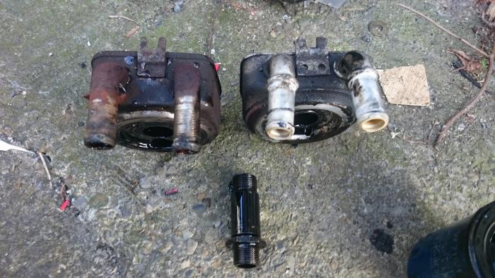

On the plus side, that cooler does look a lot nicer internally from what can be seen of it so hopefully this one hasn't suffered any corrosion internally.
Interesting comparison really, showing the long term results of not paying attention to coolant strength & replacing before the corrosion inhibitors fail Vs. how it looks if one takes care of their cooling system from the get go... (obviously not saying you're at fault here Ken, rather the previous owners to you over many years!)
I know our American counterparts can appear a bit anal over stuff like coolant replacement, (from videos ive seen anyhow!) but then I guess they'll experience corroded cooling system parts much less frequently as a result.
ekjdm14 wrote: 23 Jun 2017, 10:08 Interesting comparison really, showing the long term results of not paying attention to coolant strength & replacing before the corrosion inhibitors fail Vs. how it looks if one takes care of their cooling system from the get go... (obviously not saying you're at fault here Ken, rather the previous owners to you over many years!)
I notice the newer one is a *lot* lighter than the old one, so I assume it's aluminium rather than the older steel one, so it might be a bit apples and oranges to compare the corrosion in the two in this case. But you're right regardless - the corrosion on the *inside* of the older one serves as a warning (to me as much as anyone) about how important it is to flush coolant regularly.
- x 1746
New one does look ali on the outside. Check with a magnet.
If it is ali, and almost certainly Valeo brand, then I'd advise being thorough with good coolant, and replacing it on schedule.
My experience with Valeo ali oil coolers isn't good, but limited to the very deep one on the XM. These have a reputation for perforating.
If replacing coolant, do a complete drain down and flush out. Final flush with deionised/demineralised/distilled water, if possible. Fill with a known good brand, and never mix types or brands. Colour of mix means nothing: there are no standards for coolant colour. In this age of engine, avoid using OAT (organic acid) (long-life) types, as the installation wasn't designed for them. Stick to standard glycol mix, and do all topping up with the exact same. Keep tapwater out of the system.
Sorry to lay this on with a trowel, but mixing types can lead to all sorts of problems if you are unlucky.
Woohoo! Replacement cooler fitted:
Turns out the thinner aluminium ones are *not* interchangeable, even with a smaller bolt because the gasket on the back where it mates with the engine block is about 4mm wider, so when fitted it pours oil out underneath.
Went to another scrapper and got the steel one and it fits perfectly.
Now to do a bit of a test drive and coolant flush.

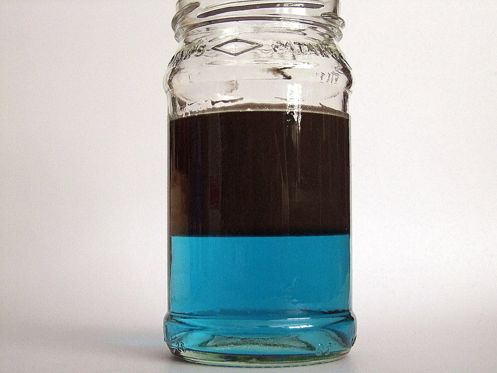

There are plenty of reports of the accidental mixing of different types of coolant/antifreeze mix producing various nasties, including sedimentation, syrupy deposits, and goo. Bluecol (who know a thing or two about coolant) publish some very firm guidelines on their site about not mixing types or brands.
Photo above shows what I removed from our XM header tank a few years ago. The blue is clean coolant, but floating on top of it was a thick, dark-grey layer of sticky goo, with the consistency of marmite/evostik.
The grey goo could be laboriously fished out of the header tank with paper towel and a scoop, but I was staggered to find that the layer re-formed where the coolant found itself in contact with air. Nightmare! The sobering conclusion was that this could be happening anywhere in the cooling system where there was an air pocket. Fortunately, the system had been properly bled as part of the previous refilling, so the goo formation was only found in the header tank.
It had occurred only because two types of coolant had become mixed, when I attempted to switch the system to a long-life brew, without completely removing all the previous mix.
I spent a long time cleaning and flushing the system, with bio detergents etc, involving removing the header tank several times. Cleaning was finished it off with the Liqui Moly cleaner, which left everything pretty much spotless.
Much googling revealed that this problem is not unknown, and hence the advice above. I now run with PSA's own ready-mixed "Pro" coolant, a traditional glycol mix with good anti-corrosion properties. It even smells of Fernox.
