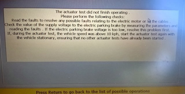

C1556 is an Electric motor control fault on the parking brake - a short circuit to either earth or positive. Could this then be causing fault code C1559 which is System locked - Electric motor, cables or calipers?

As for the epb if there is a short so it's not working where is the shorting problem? But when I've tested it through Lexia I can hear a whirring noise which stops and diagnostics says it cannot complete the task. That gives the assumption that the epb motor is working
Need to get under and have a look whilst it's whirring away.
I did read that another epb had to be calibrated to the car and could only be done at Citroen. Any truth in that?
