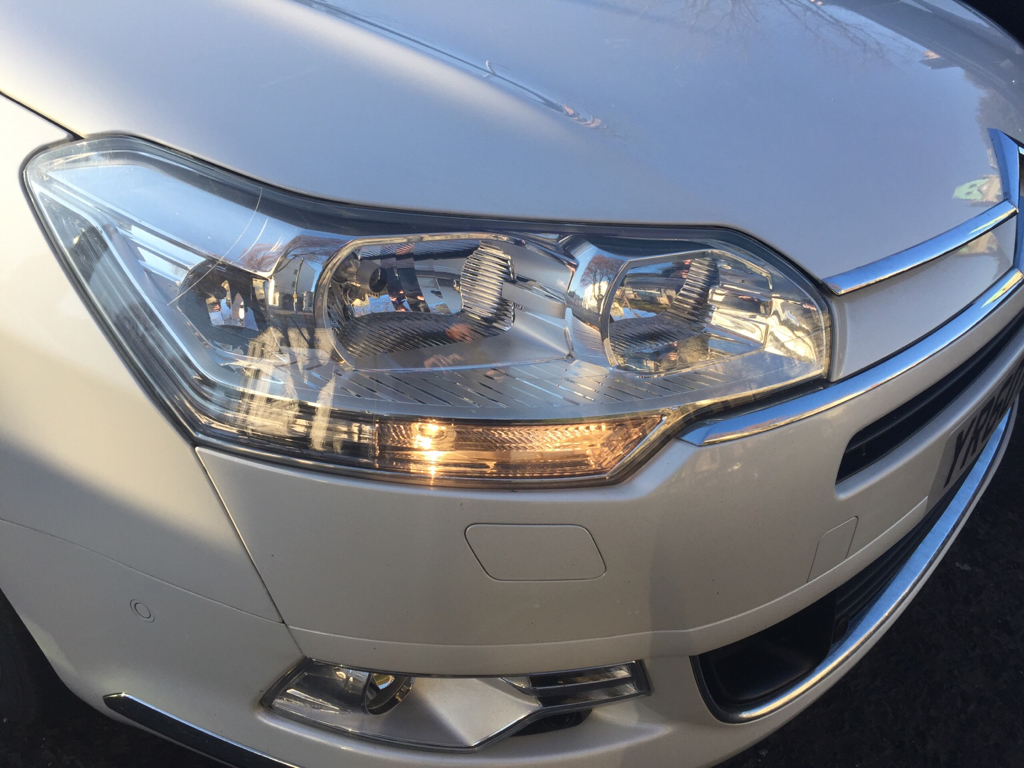

GiveMeABreak wrote:They don't look right, I'll look them up in a bit. Your DRLs are at the bottom, where the bodywork meets in the picture and are probably not enabled - a Lexia can enable them, if there is no option to turn them on via the left hand steering wheel (wheel button) in the lighting menu.
Boom! DRL wasn't selected in the lighting menu and neither was guide me home lights [emoji3]

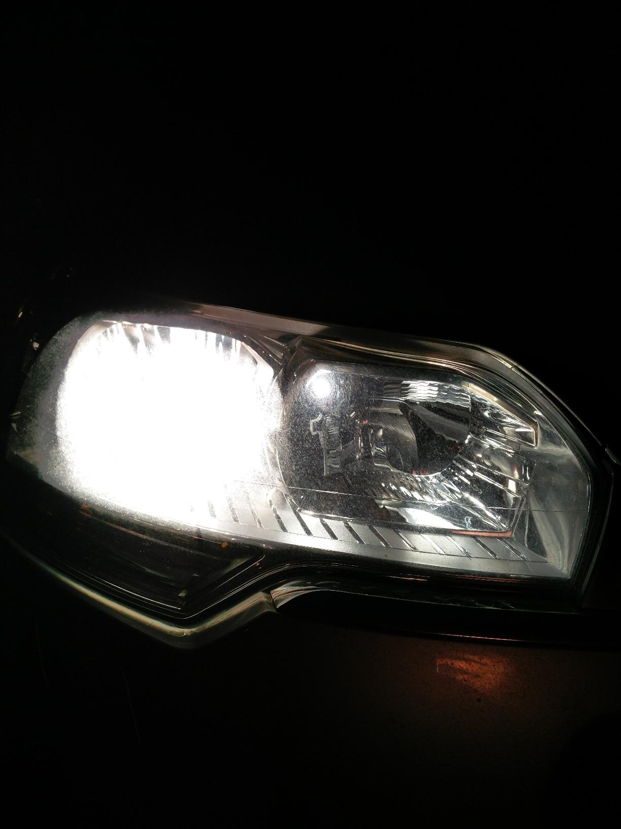

Those are aftermarket LEDs and should be an MOT / police fail as you say Sticky. If you zoom in on the close up you can see quite clearly now that it is an aftermarket LED cob which aren't road legal.

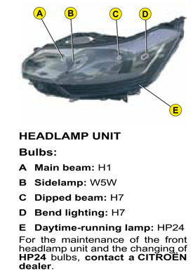

Ok, these are the bulb types and their locations in the picture below. So that particular one is in the sidelamp position. Now normally, on the Mark II C5 for example, the side lamp was in a separate compartment and sat behind an off white coloured plastic.
On the Halogen version of the X7 (Hogger's car), it sits in the same compartment as the H7 bulb and is not screened. So the LED is not going to be shielded at all and at night is very likely going to be a dazzler!
If the sidelight was self contained behind an opaque lens, then an after market LED might be acceptable, so long as it wasn't too bright, as the light would be scattered and semi-blocked out. The one you have currently fitted Ben is not shielded and an on-coming driver will likely be distracted.

GiveMeABreak wrote:Ok, these are the bulb types and their locations in the picture below. So that particular one is in the sidelamp position. Now normally, on the Mark II C5 for example, the side lamp was in a separate compartment and sat behind an off white coloured plastic.
Why does it say visit main dealer for main headlight maintenance- are they difficult to fit??
Sent from my iPhone using Tapatalk
x 6956
Re: Daytime running lights
Generally, you need to be Mr Fantastic, have twiglet fingers and the skin of a crocodile! I have Xenons, so not as bad as there are less lights, so you should be fine. The DRLs (HP24W) are another matter as access to these is underneath the headlamp units, hence dealer recommended - but the other bulbs on your car should be ok with a bit patience! A lot of modern cars require bumper partially or fully off to replace bulbs these days. I'm sure some X7 halogen owners here will have done the job themselves though, as I can't see a Citroen Dealer fitting non-approved bulbs (as in your sidelight picture), so should be accessible. Do you have your manual?

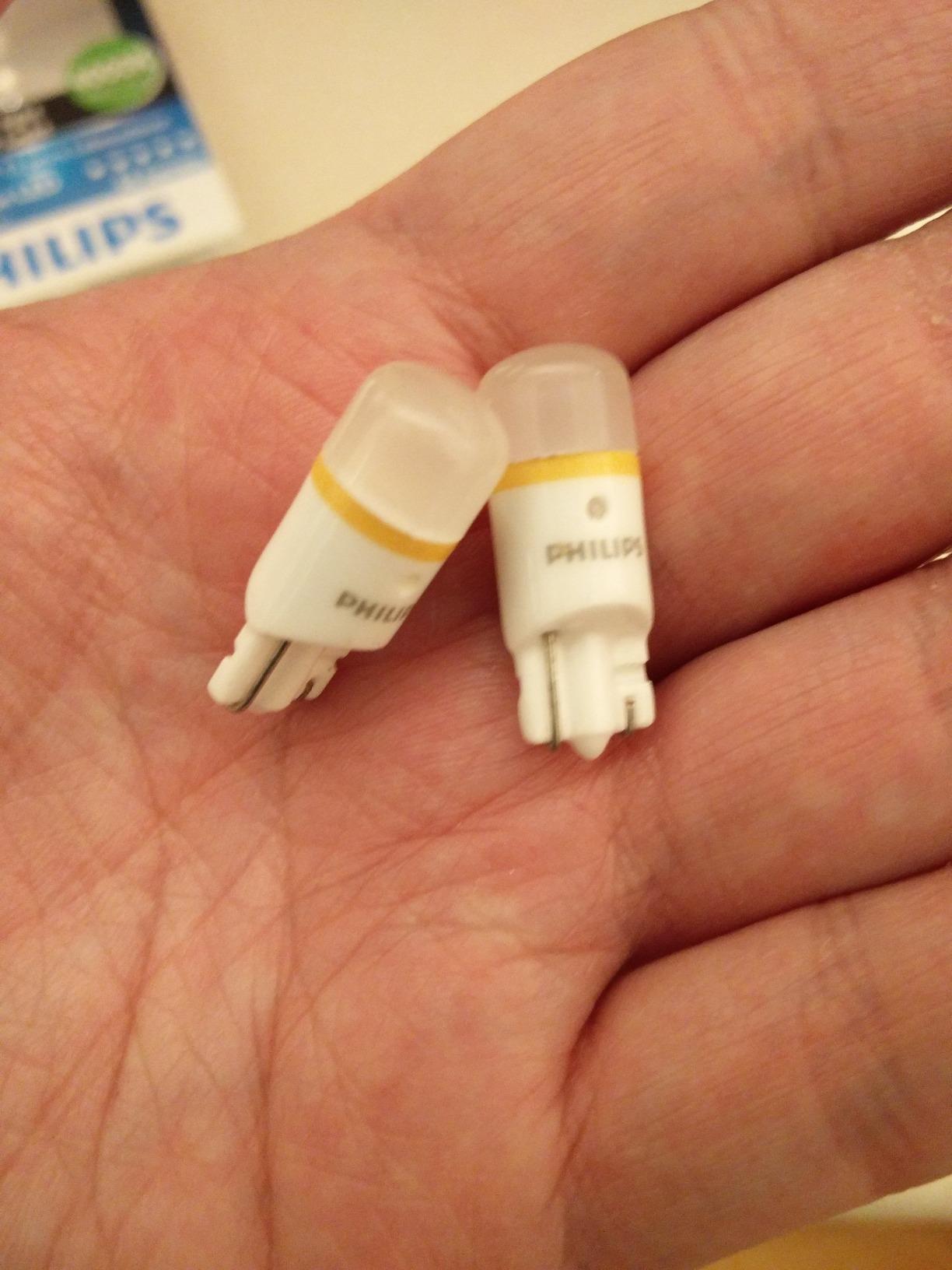

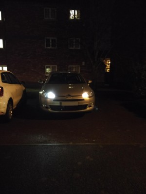

I think he is referring to his sidelights.

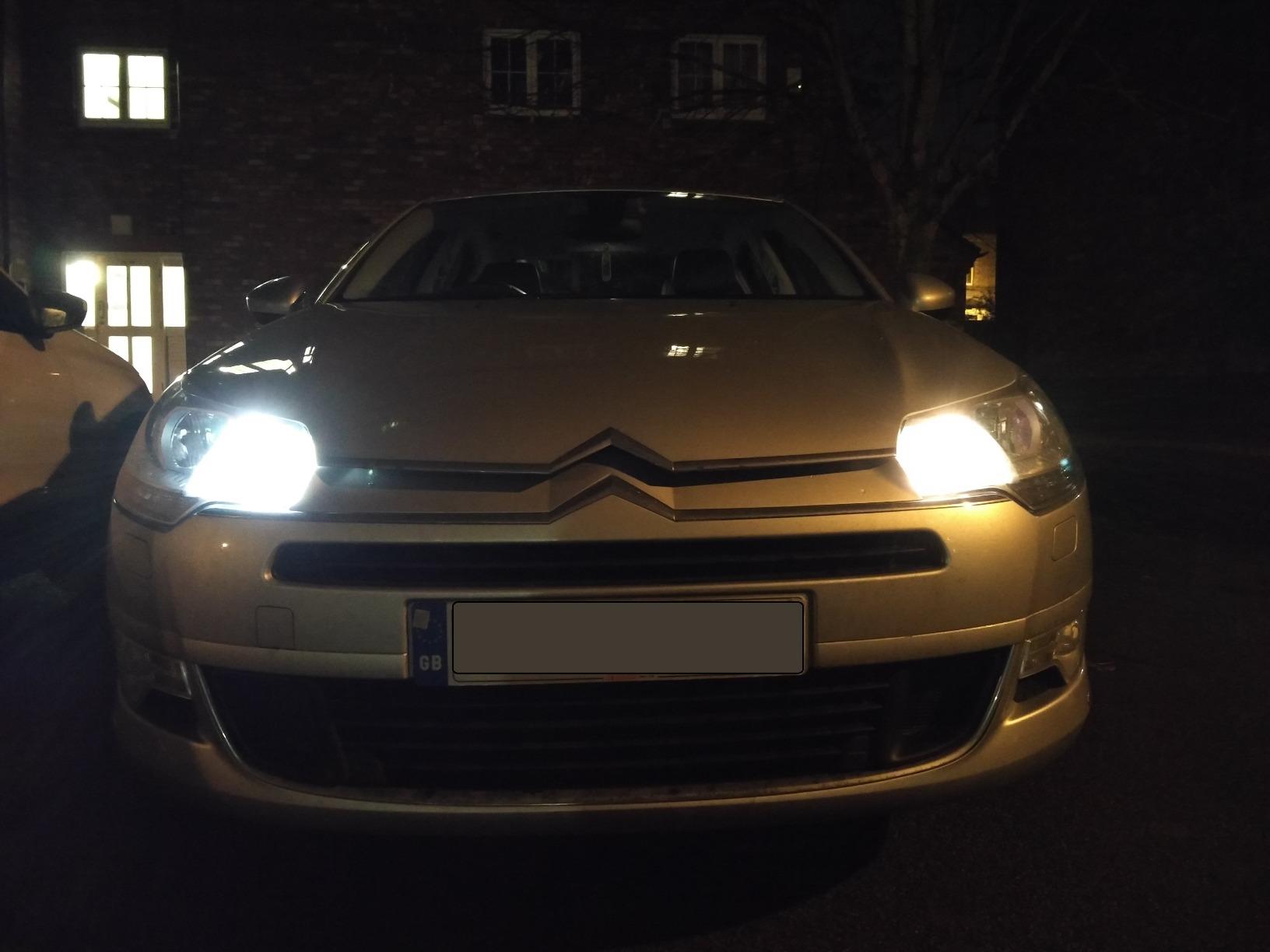

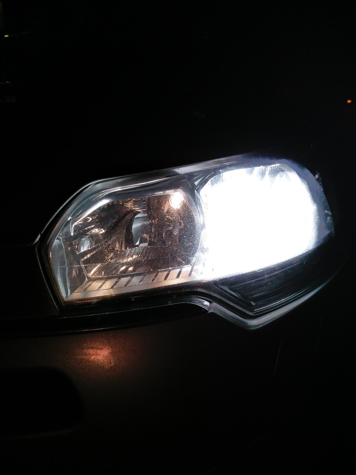

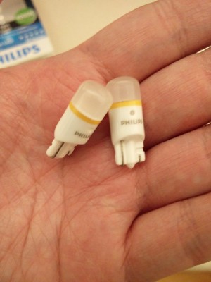

Although they are not road legal and you can face an MOT failure I've replaced the W5W from my C5 with Philips LED bulbs. Their color is quite similar to the H7 Philips Xtreme that I have in my dipped beam, they look inconspicuous and they give out an even glow. You wouldn't be able to see very clearly that it is not a filament one.
Although they are marked as Warm White, I quite like them as I do not want that bluish tint usually associated with LEDs. I prefer the pure white color.
As you can see, there is a dome covering the lap wich helps the light to blend in and makes the bulb more discrete.

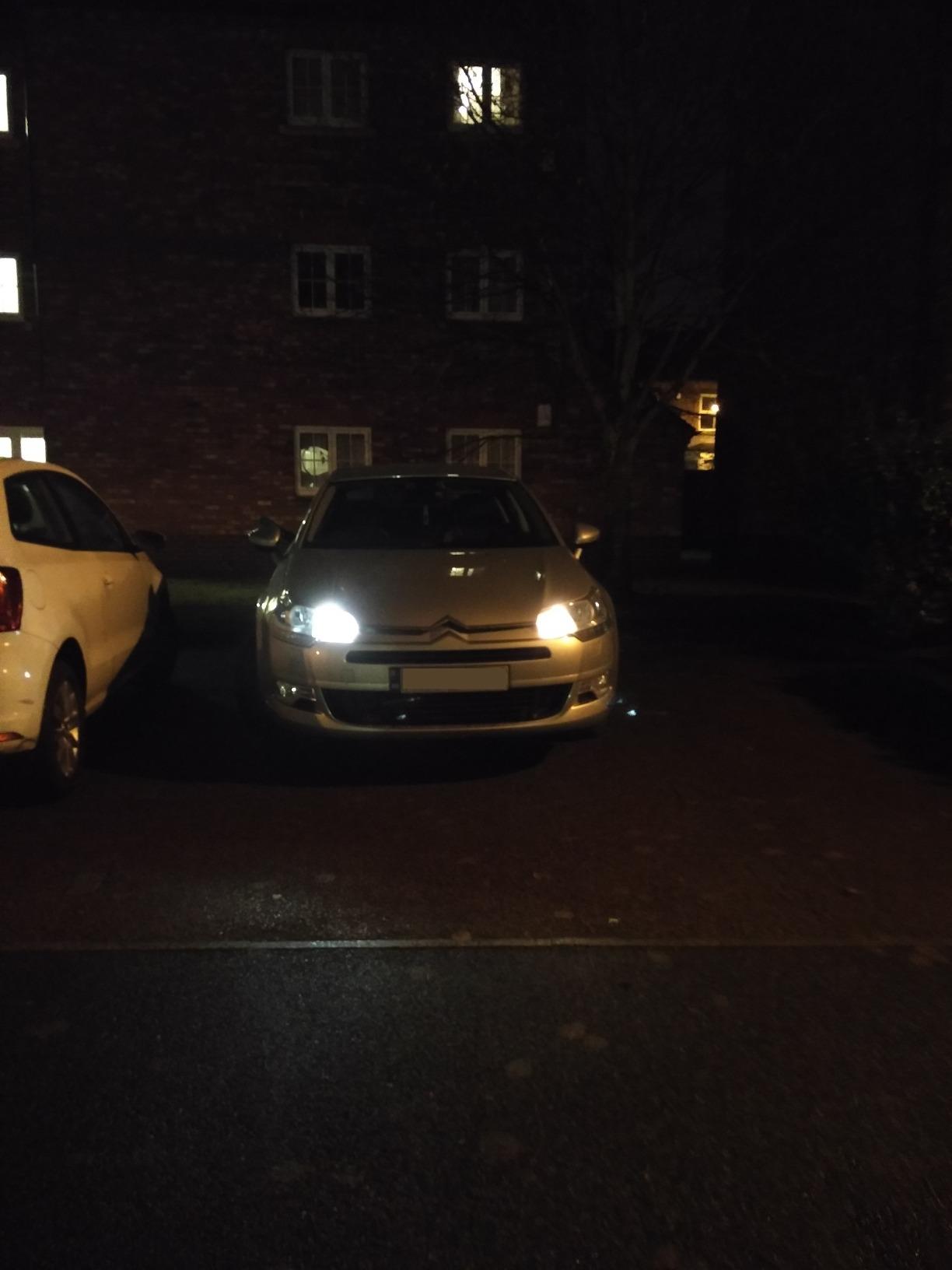

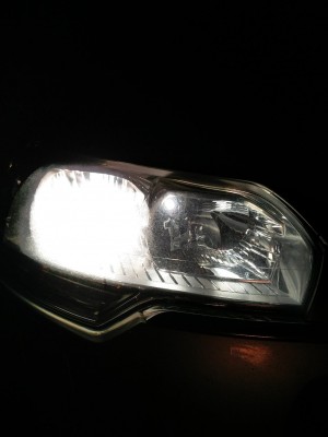

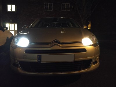

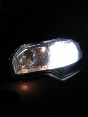

You can see the filament sidelight...
...and the LED one on.
Here you can see how much the filament bulb (on the right) can influence the look of the car, even with whiter dipped beam bulbs.
I'll try to get a picture during daylight to see how it looks to the naked eye.
