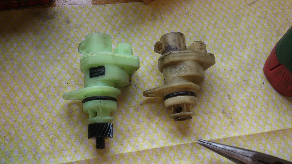

Fixed!
The speed sensor was there at GSF this morning at 10am and I picked up the speedo cable yesterday.
Out with the old speed sensor and here's the new:
The bit of broken-off square drive in the pinion thing was stuck in so had to use progressivley larger drills in the dremel until I could use a little 'easy out' on it - worked a treat. The replacement speedo sensor went in fine and the small part of the cable too (after cleaning it and squeezing in some grease) But removing the old upper cable!.... that was a chore. If anyone's seen this on a Mk1 Xantia (i.e that still uses a drive cable) on a RHD car (coz I just KNOW the LHD will be simple and neat) it is a nightmare. The cable emerges from the bulkhead right above and behind the brake doseur valve and all its pipes. The thing is very hard to access and to make matters worse, the big rubber ' ball' that's part of the cable's bulkhead aperture seal was stuck solid in the hole. Barely touchable by any tool and certainly no leverage space with the back of the engine and turbo pipes all so close. I opted in the end to remove the turbo pipes and move the fuel feed and return pipes to help with access. EVENTUALLY I got it to move and after a lot of lost skin got it slowly emerging from the aperture hole. It took well over an hour, fitting the new cable took 5 min.
Knackered after that but I was rewarded with the immediate return of the hydractive functioning and now a nice steady speedometer needle! Simple(ish ) pleasures.

So, bet you're pleased with all that!
And - the car no longer thinks it's standing still, which has obviously made something of a difference to suspension behaviour.
Great job, and quickly done.
New Year's resolution: No More Speedo Cables.
