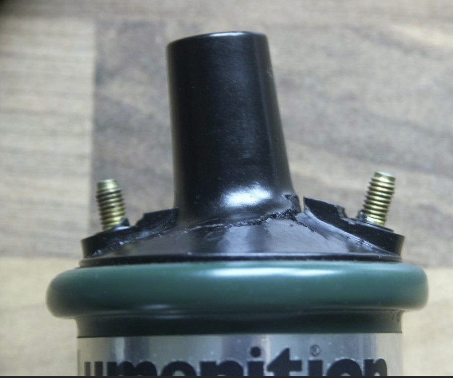

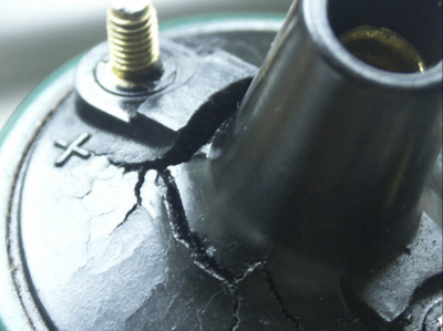

During the very cold weather, snow, ice, and rain of December, Jan, and Feb, the car started fine - and then didn't. It fired on two, picking up on four after some coaxing with choke and throttle. When one morning it failed completely, checking connections found the top of the Lumention coil cracked. The crack was considerable, more like an eruption from within (see image). After smearing silicon sealant in the 'chasm' and spraying with WD40 she fired up. The car ran for a couple of weeks then failed completely. I contacted Autocar, the manufacturers and suppliers in South London, and despite the coil being out of warantee they supplied a new one. Still no life in the car. Dead.
Despite Autocar claiming that their coils are not prone to failure, I cannot help but deduce that the failed coil had somehow 'cooked' the electronic control box. In our house move I have misplaced my original CB points coil, and so have purchased a new coil from Accuspark (the Red one), refitted the distributor with points and capacitor, and she fired up instantly after over a month idle and untouched (weather foul).
I will be sending the failed coil and electronic gubbins back to Autocar (they didn't initially want the failed coil for inspection) and ask if they might be able to test all, and point to the cause of the total failure. I'll keep you posted.

Will be interesting to see what they offer. Not something you'd expect to fail like that.
IIRC, most of the electronic ignition kits feed the coil primary not with DC like traditional CBs, but with a high-frequency, low current but high voltage pulse. This produces a good fat spark, by operating the coil more efficiently, without straining it.
I used Electronize EI kits for some years, both with the originally-intended CBs, but later with an inductive sensor in place of the breaker points. It transformed how a Rover V8 started and ran.
