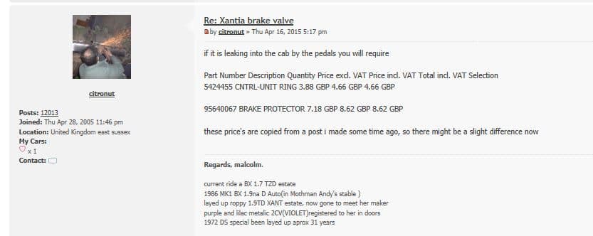

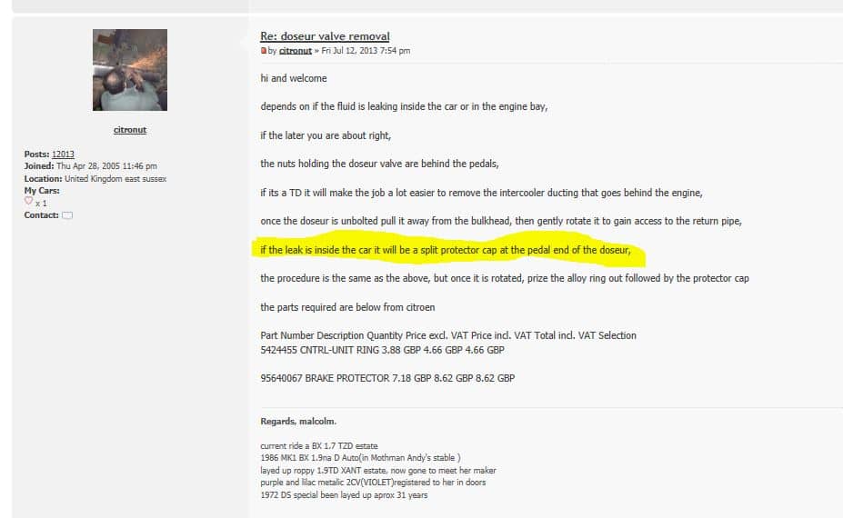

superloopy
- Posts: 3344
- Joined: 30 Mar 2005, 03:25
- x 19
Re: 1996 313kmile Xantia 1.9TD lost pops popping out of 5th fifth gear
Doseur valve's up there i believe. Could be dripping lhm. There's a lot of posts on the forum as your 'starter for 10'. Can someone confirm my thinking please.

KennyW
- Posts: 2615
- Joined: 17 Jan 2006, 21:22
- x 165
Romie,
There are hydraulic pipes which run along the bulkhead to the brake valve, they're not prone to rust and also the off side strut.
I can't think of any other hydraulic pipes in that area.
Kenny
Xantiamanic I see you have suggested the same area.
Kenny

romie
- Posts: 451
- Joined: 07 May 2010, 14:02
- x 2
uhuhhhhhhhhhhhhhhh.............. this is sounding interesting. Thanks for the initial pointer!
Great, I'll start prodding around. Ta!
