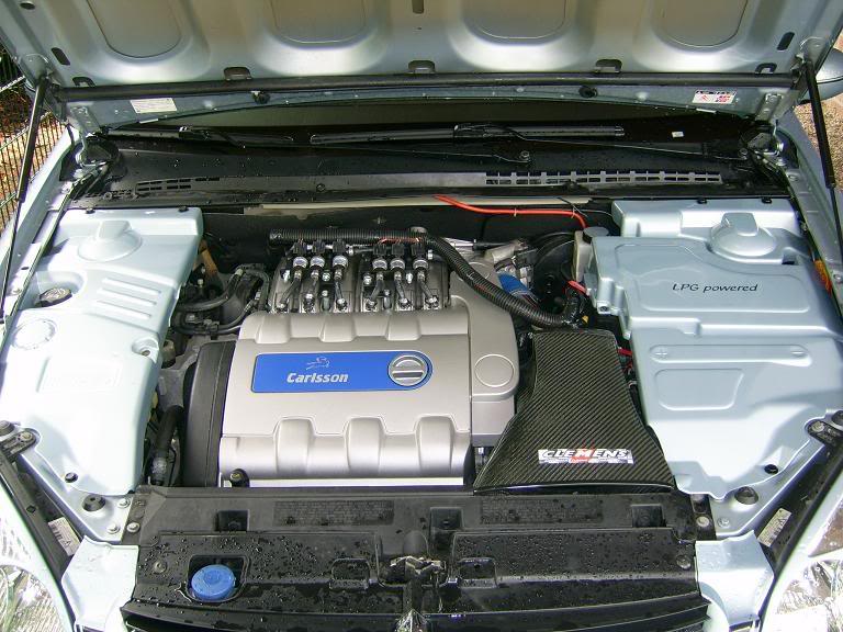

just as it is interesting....V6 C5 Carlsson
Posts: 10918
Joined: 09 Nov 2005, 22:03
x 1438
Re: Xantia V6 fuel pressure regulator upgrade.
Unread post by xantia_v6 »
I think that the visible modifications in the photo are an LPG kit, not necessarily by Carlsson. I don't think that they ever did much more than a re-map and cosmetics on the C5.
