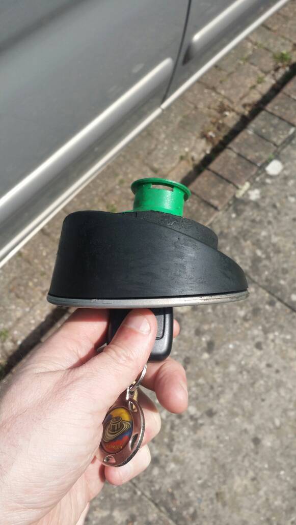

I put petrol in my diesel Berlingo about 4 years and 55k ago. So far no ill effects.
I love Citroens colour coded warning of my *diesel* filler cap insert though... Image
