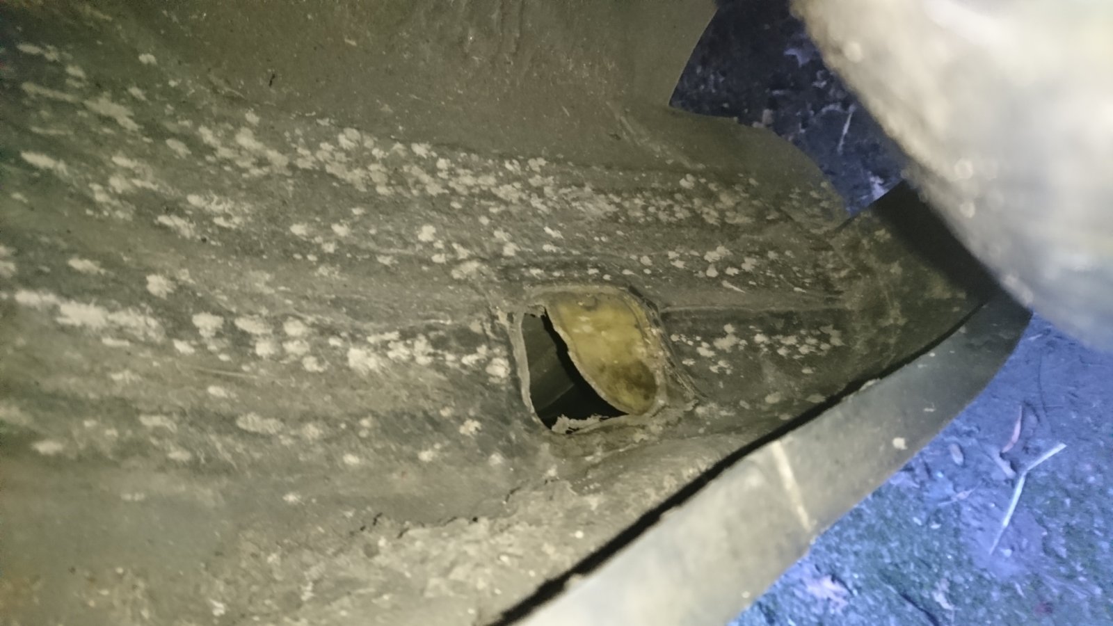

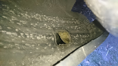

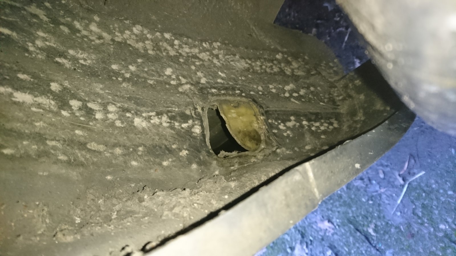

So i checked the passenger side rear wheel arch and there is a plastic bung/cover that is broken, i think this is where the problem lies.
Will try and get some pics but any ideas on if the part is available still or do i need to find an alternative solution ?

First 2 pics show the broken seal ? on the passenger side rear wheel arch.

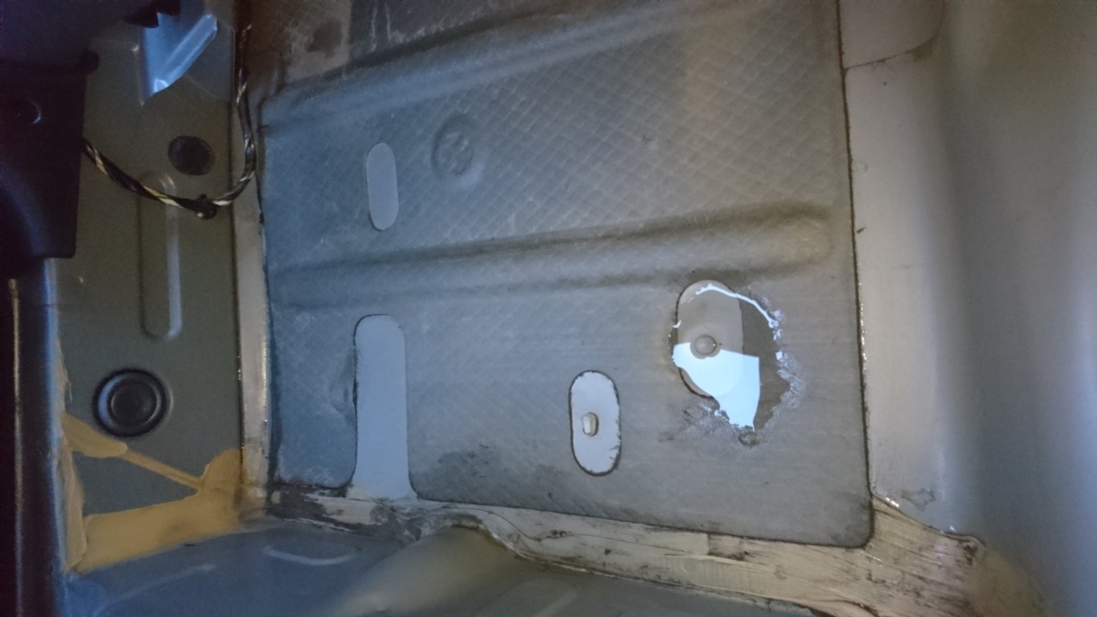

The last pic shows the now cleaned floor pan but you can see water pooling in the lowest point, although no water running to it on the floor pan, so my guess is water is still lying within the panels/subframe ?

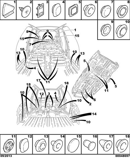

Just a quick question, can anyone confirm the part number for the bung in question is 96 130 325.
Do not want to order them if it is the wrong part.
Item #5
Item #5

Just for posterity the part number is correct as is the item #5.

Clean the hole and spray a lot of rust inhibitor there. Else the frame will rot from inside out as it happens on all xantias.
