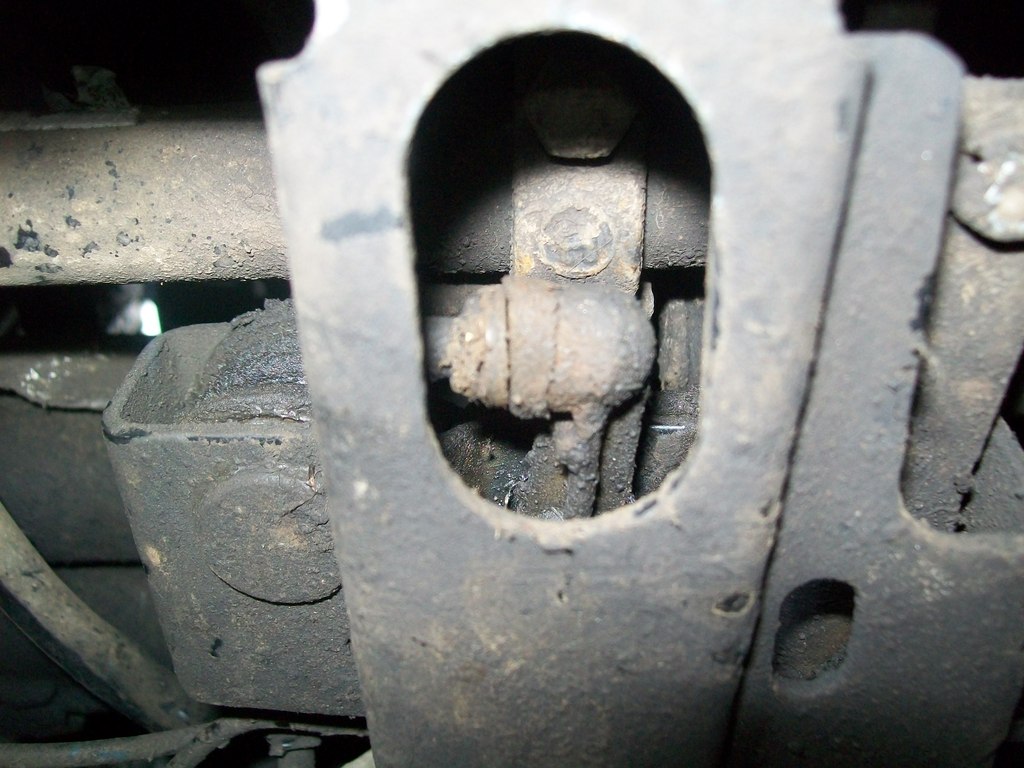

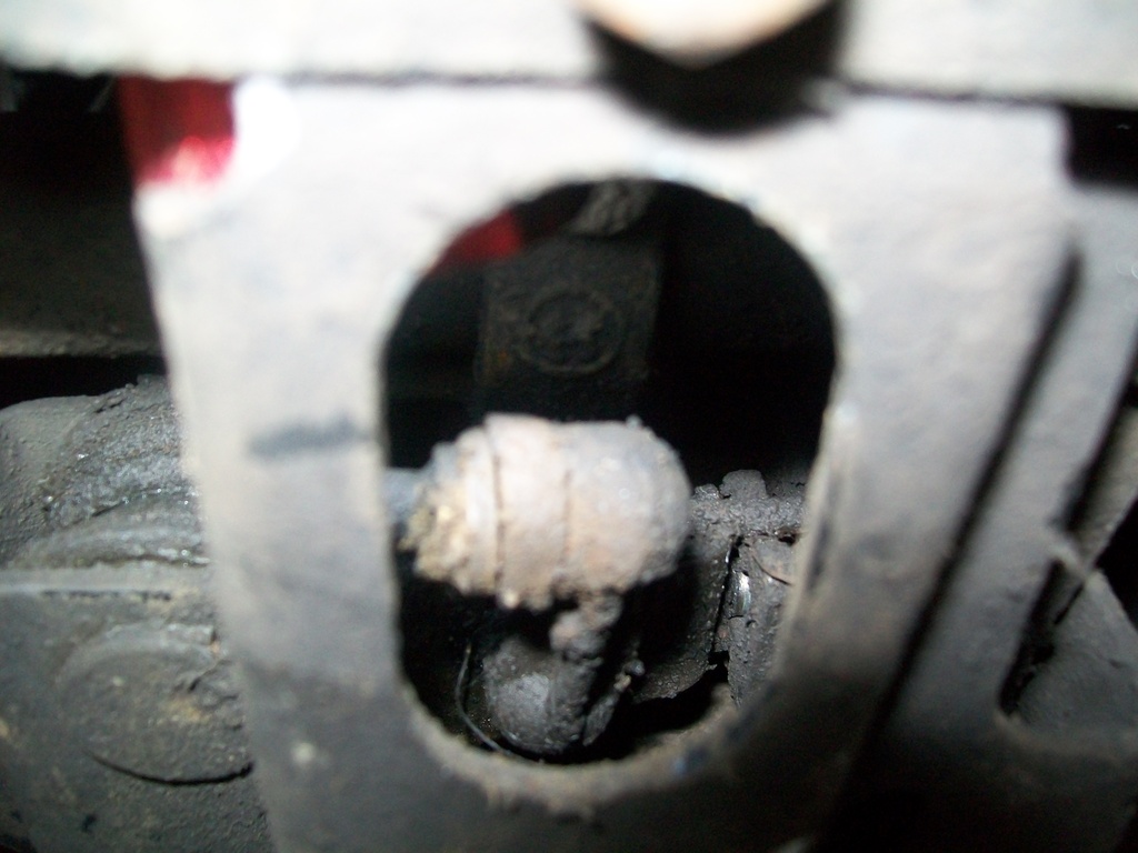

In happy news the front corrector dog bone link is intact and still connected. I have taken 2 photo's and it's the best I could get in the space there is available!
These are both before I cleaned and greased the springs, dogbone and linkage (please excuse the dirt)
As you can see it was all really dirty around that part. I can say that the dogbone is now white and the sprigs are clean and lithium greased!
The only thing this has changed is the lever action between "normal" and "intermediate", The action is now very smooth and light. However to get into "high" and "low" settings is still a little stiff
How does the car sit now then ??? Well in short pretty much as it did before
but the ride is a little smoother than it was before!

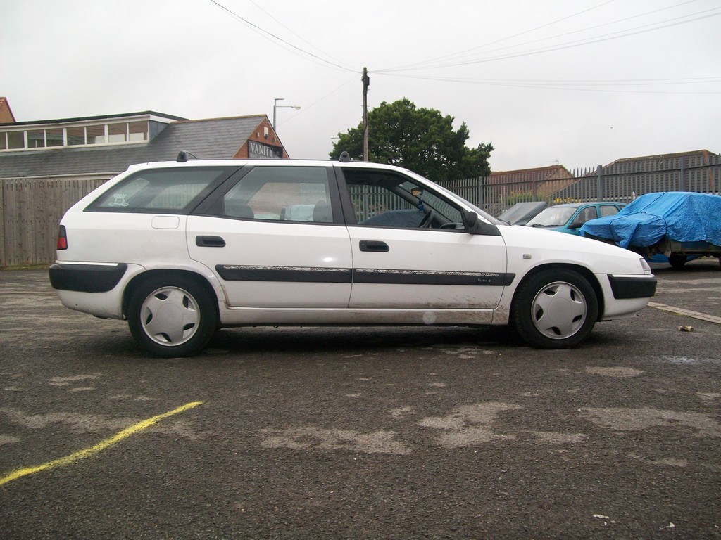

Here is a picture as it stood after cleaning on the "normal" position on mostly level ground ... to me the rear looks to sit slightly lower than before but that would be the only real difference.
Am I missing something else obvious? Oh I also put some LHM on the front struts but they still creak sometimes and went dry nearly immediately after doing them. From lowest setting to normal driving setting the suspension still takes an age for the nose to lift and usually needs a nudge up to intermediate to get it to go, Front isn't staying stuck in the high setting anymore though, guess that's a bonus then!
Any further thoughts as to the issue, are the height settings off or is something else broken do we think?

You could try cleaning out the LHM tank checking the levels again to see if they have changed since your
lubing session. do some citroen aerobics, with the engine running sit on your drive and lift the suspension and lower it about five times do this once a month to maintain suspension comfort.
The rear end looks a tad better now but harder to see without the front end in the picture as well.
The xantia does have a slight angle to it from rear to front end. Ahh moved the slidy thing at the bottom of the page yep it does look better now. I know what you mean about the speed sensation mine to is an estate 1.9td and it never fails to surprise me just how fast she goes and how comfortable and quiet she is at speed. I can actually feel the seat pushing me forward as the car accelerates.

I have been pondering a lot about the suspension heights the last 24 hours as it really annoys me that it doesn't sit right! I have searched the internet far and wide and found only one thread about the heights which included a post from the late citronut stating that the rear height should be 1 finger between top of tyre and arch, front height should be 3 fingers between top of tyre and arch. This topic also discussed the adjustment of the front height with the clamp on the Arb, So after thinking things over for a while I have decided to have a look at this in better detail tomorrow. Just to see if someone has messed this up in the past.
The front height at the moment is between 1 and 2 fingers from top of tyre to arch which is too low by nearly an inch, However the rear is tons better and is very close to where it should be now! The corrector has had allot of cleaner put on it which removed loads of dirt, The height adjuster in the car moves more like it should and the height corrector mech has plenty of white lithium grease on it now ... seemingly it isn't sticking so the only thing left in my mind is to have a look at the clamp on the Arb to see if she is out of adjustment! Fairly confident that this can be achieved with the ramps we have or even careful use of axle stands and a jack as I now know what I'm looking at
