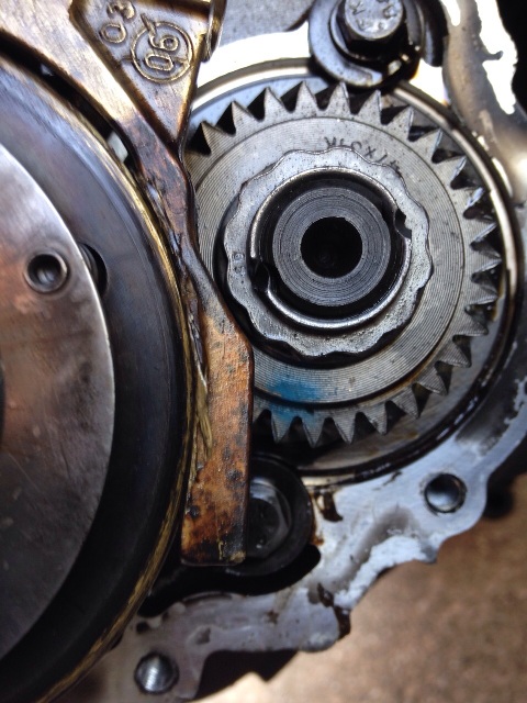

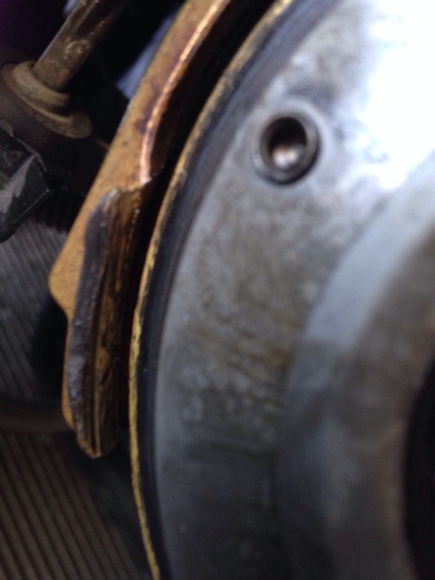

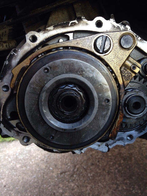

Right guys problem found. It seems the gearbox was losing oil and the brass selector fork has worn. Question can these be bought separately and any idea of part number and cost. I assume if you can buy all the others you can buy this. Depending on price I may end up getting a second hand gearbox. Pictures included below.

Re: Car jumping out of 5th gear and now unable to select it
The cheapest way to get one is from a scrap gearbox, otherwise its likely to be expensive.

- Posts: 12565
- x 1484
Always good to find something, Tom!
Fork comes complete with new shaft and bolt / roll pin etc, it's not too bad....

Thanks Richard, thats £3 less than the second hand box. The mechanic said he didn't know yet whether that should solve the 5th gear issue, but I suggested a second hand box and taking the assembly off that. He said that if it was only £20-£30 for the selector that was OK but any more and it might be better to go the second hand route. I could buy the selector but what if it wasn't enough and I needed to buy more? In your honest opinion do you think it could need more parts?
- Posts: 12565
- x 1484
There's got to be a risk that the synchro is worn, so I think if you can get a box for £80 it would be worth having the full set of parts on hand just in case. As long of course that the SH box 5th gear is OK....
