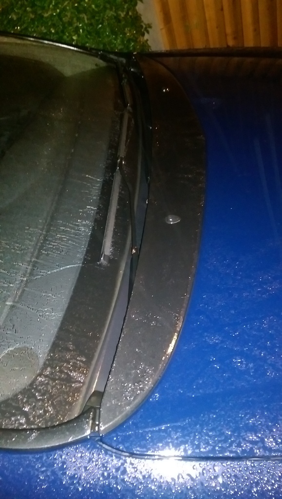

Replaced the windscreen bar. All fixings intact on this one and it's from a later car with the improved bolts fixing in the centre, so it's definitely going no-where! :lol:
I'd noticed this on mine recently and thought it looked a bit odd...
While I was in the scrapyard on Thursday I checked out some others and turns out I was right - there should be a cover over the slave cylinder. So...
Duly fitted 8-)
(Yep, I admit it - largely pointless, but I'm anal and have to do things right on my cars! :lol: )

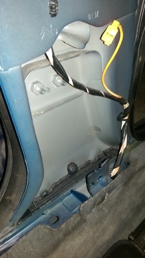

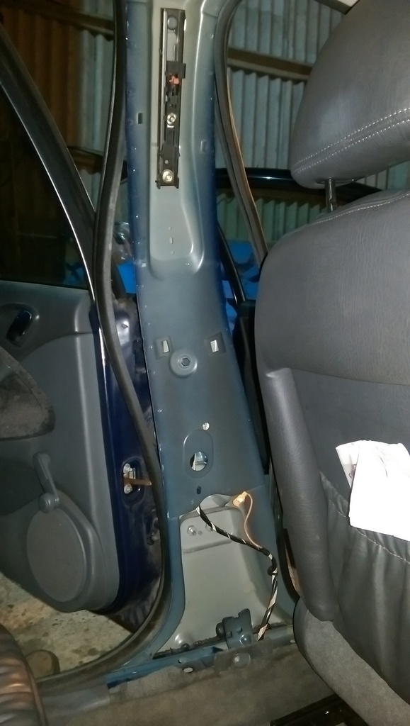

Haynes description of removing the B pillar trim and changing the seatbelts is largely correct, with a couple of notable changes.
Trim-wise, it's not necessary to remove the sill covers - the lower half of the B pillar cover is barely covered by them and can easily be flexed clear.
The upper half of the B pillar cover shouldn't just be yanked out/down - there are 2 clips at the bottom which should be squeezed first, to release them. THEN pull it outwards and then down.
Fixings wise, they have completely forgotten to mention a fixing halfway up, that is held in with rivets :roll: #-o
So glad I started stripping this down when I was 25 mins away from my rivet gun as a result :mecker:

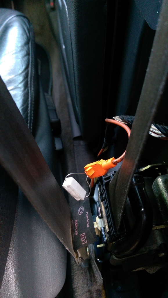

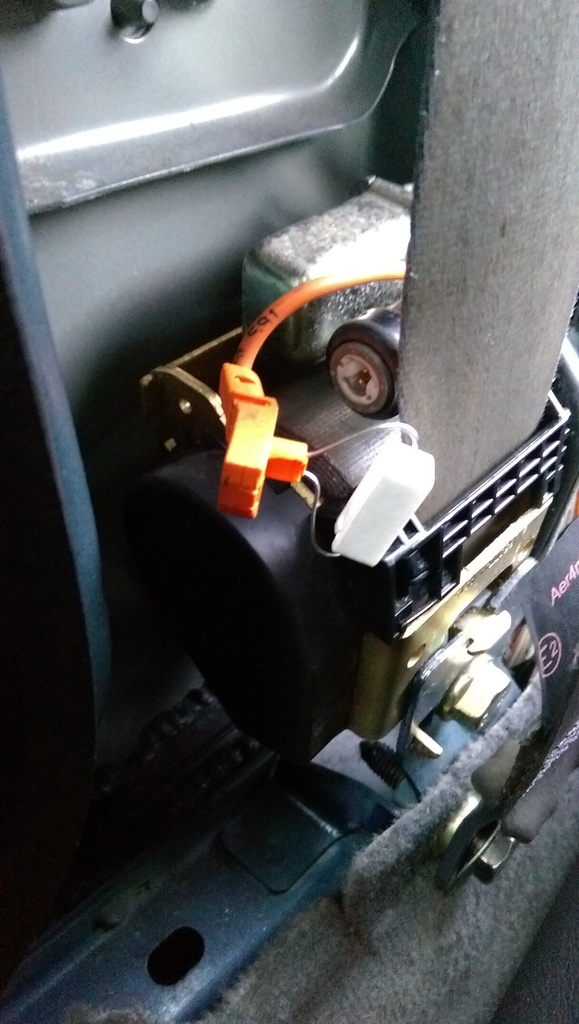

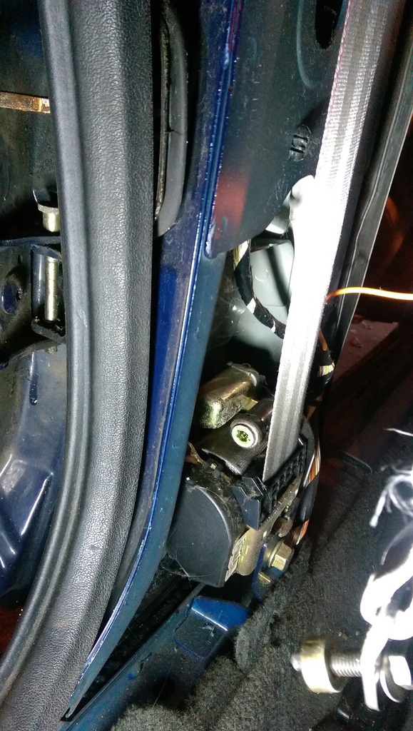

Seatbelt reel with the covers removed;
Said middle seatbelt fixing;
2 rivets holding it on;
Only option is to drill the heads off;
Then knock the back of the rivets through into the pillar (they will fall out the bottom)
You will need short, 4.8mm rivets to replace them.
Important to vacuum up all the swarf generated, so that none of it works its way into the seatbelt mechanism (could potentially damage the belt, jam the mechanism, or cause the pretensioner to be set off).
Everything removed and vacuumed clean;

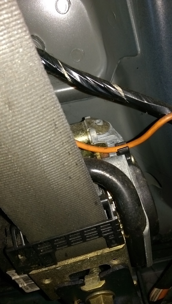

On the passenger side, it's important that the wire for the pretensioner is clipped into a holder and fed behind the belt, to ensure it doesn't get snagged;

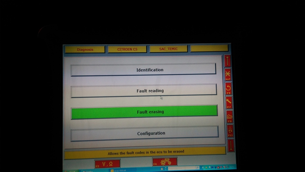

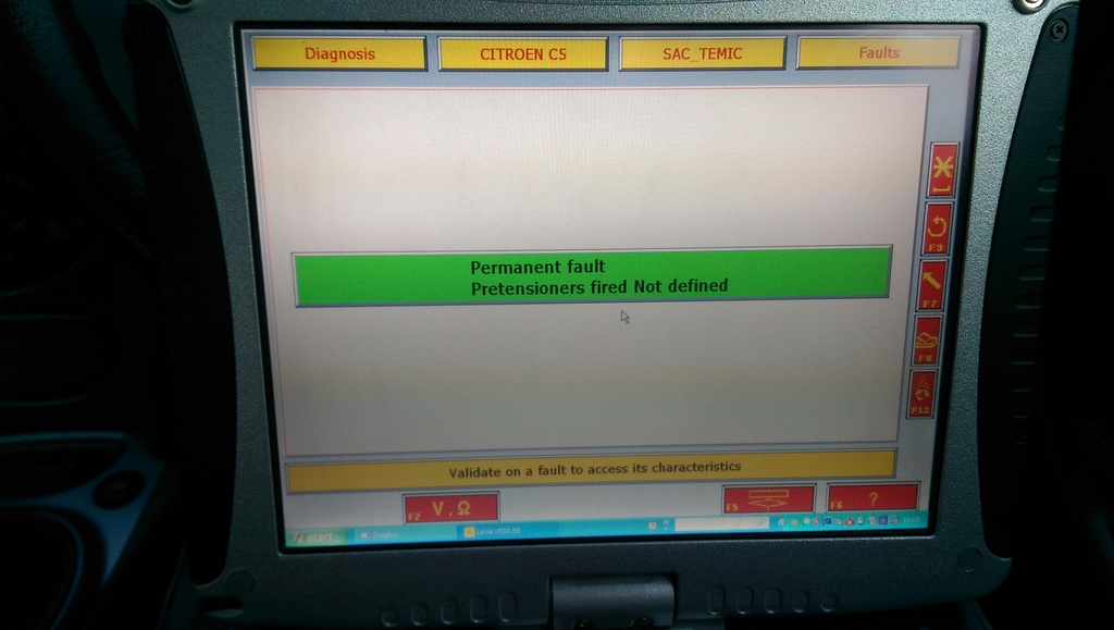

Into Lexia, diagnostics section, Airbag Ecu, this is the fault that will have been logged;
(Ignore the temporary fault open circuits showing here - that's probably 'cause I had run the car with the old pretensioners unplugged, while I drove over to get my rivet gun)
Cleared by simply going into erase faults;
As Haynes describes, you can tell the pre-tensioners have gone off, because the inertia reel units make a noise a bit like bits of broken glass rattling inside a steel can. On mine, the passenger side reel worked as normal, but the drivers side had completely locked up, no movement either way.

Righto, the airbag fault kept appearing, because of the pretensioners having activated. Despite clearing the faults and configuring the Airbag ECU to tell it that it didn't even have pretensioners, the fault reappeared after every ignition off cycle.
The pretensioners on the used seatbelts I fitted have not deployed.
Consulting this thread offered a way of testing the rest of the circuit.
So both sides hooked up with resistors;
(the power rating of that resistor is overkill, but it's the only 2.2Ohm resistors that Maplin had in stock :lol: )
Cleared the faults, re-ran diagnostics...
Bloody thing.
Looks like the ECU is a write-once affair so I'll have to change it :evil:

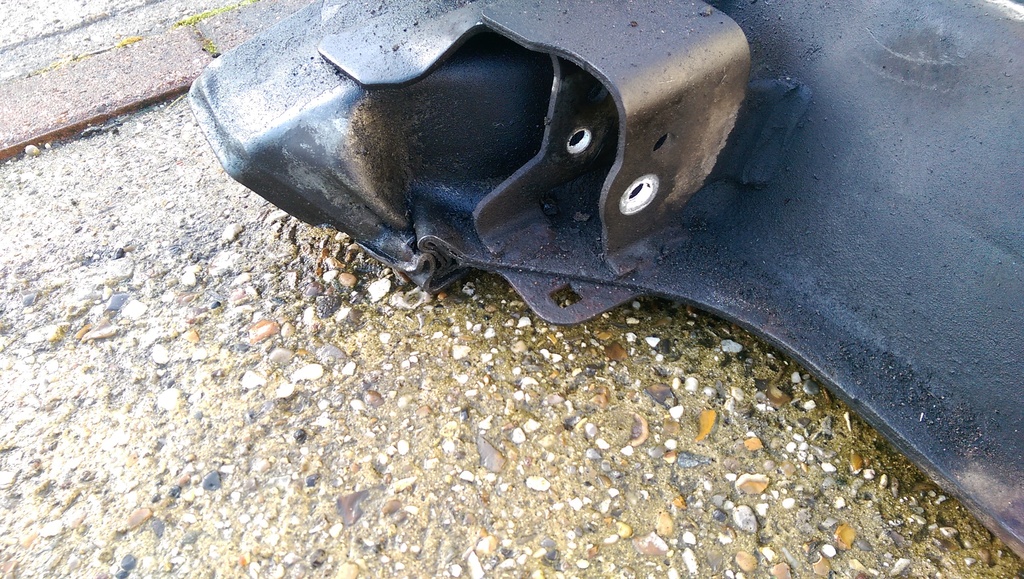

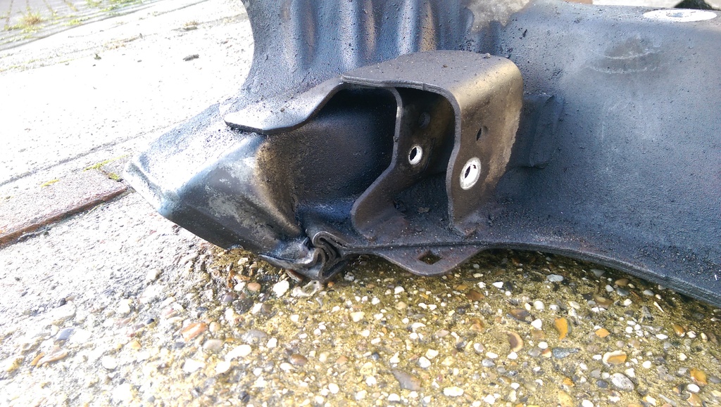

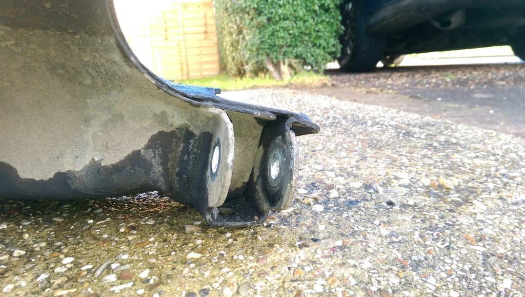

Pics of the dead items;
Sub frame was more bent than I thought :lol:
Crunched back and bent down. Car still drove fine :D Strong old things these C5's...

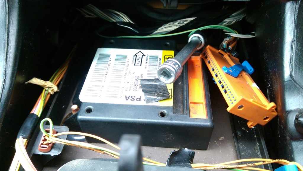

So as far as the accident goes, that just left the pretensioner problem to finally sort (ECU fault came back every single time straight after clearing it).

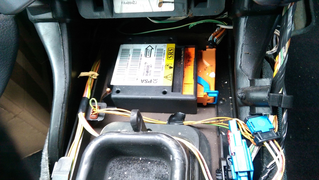

Got a replacement used ECU from my local breakers.
This is where it lurks, in front of the gear shift lever;
Held on by 3 nuts on captive bolts from the transmission tunnel. It's a bit of a pain to get out without dismantling the dash further. The nuts are recessed inside stiffeners on the side of the ECU body, so you need a slender socket. The 2 furthest bolts are then underneath the main dash centre console. I managed to get at them using a universal joint on the socket and an extension. Fiddly, but do-able;

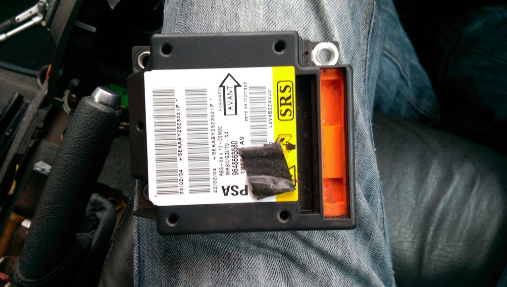

Old and new ECU next to each other. It's the same ECU on saloons/estates and through all the S1 range as far as I could see, checking on service.citroen before I headed off to the breakers (I didn't check the facelift part numbers).
Found an original assembly fail on the part of Citroen. The one I took off at the breakers (an '04 car) was secured with all metal lock nuts, whereas mine had all nyloc nuts.
The eagle eyed among you will have spotted that one of the securing holes is an earth point - so nyloc's are unsuitable! I just re-used the all metal nuts off the breaker.
Worked fine first time, no need to set the ECU up or programme the VIN etc. I didn't disconnect the battery, just turned the ignition off.

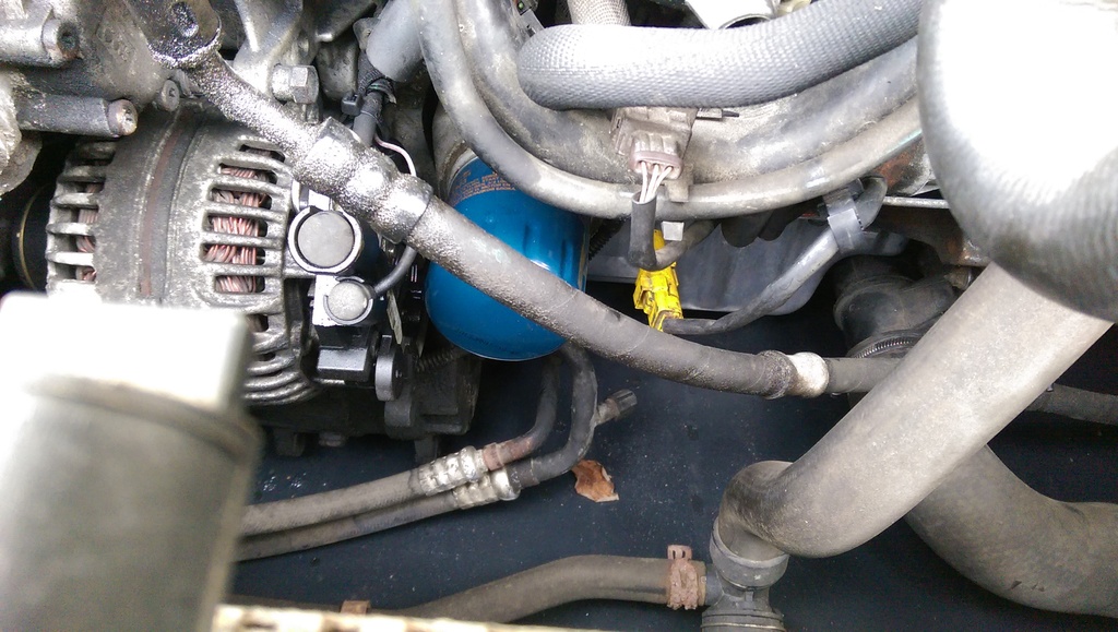

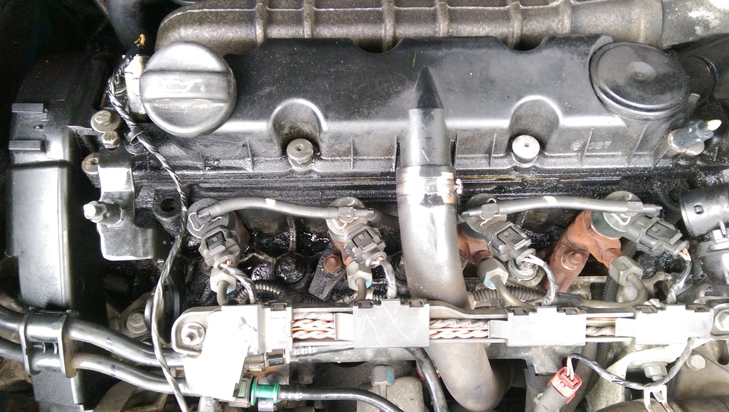

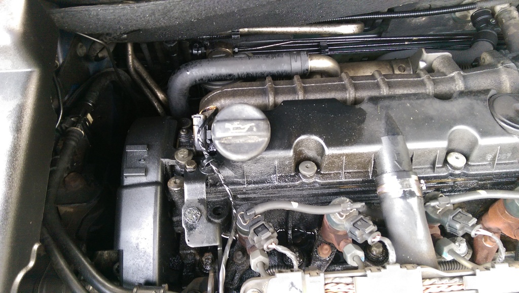

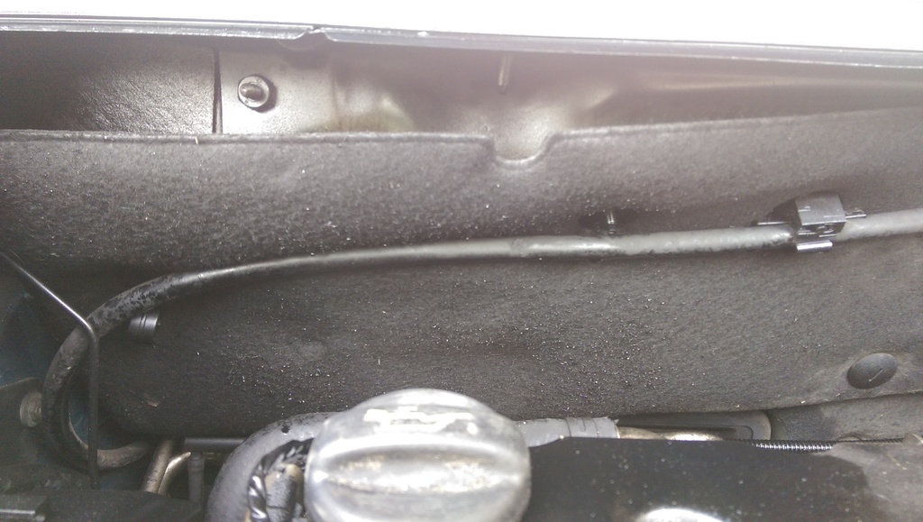

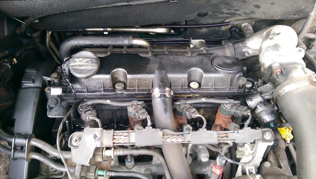

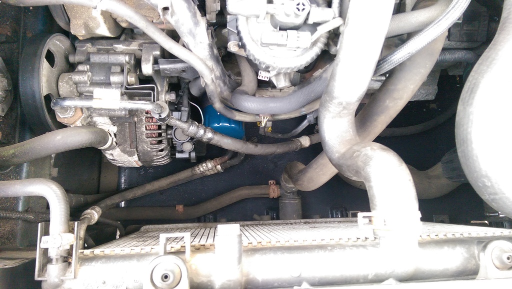

On the way there, the oil filler cap apparently came loose and fell off down the back of the engine :facepalm: garage think it's cause the engine cover was so loose (there was only one of the resilient mount bolts actually in place at that time, so entirely plausible) :oops: :lol:
Not a disaster, but messed up the engine bay around that area. I told them not to replace the bolts 'cause I had a load I'd bought ready to do the job, so it came back with the cover in the boot and the engine bay still to clean up.
Grubby;
Look at the pools of oil in the recesses in front of the rocker cover :lol: (not all from this incident - been like that for a while!)

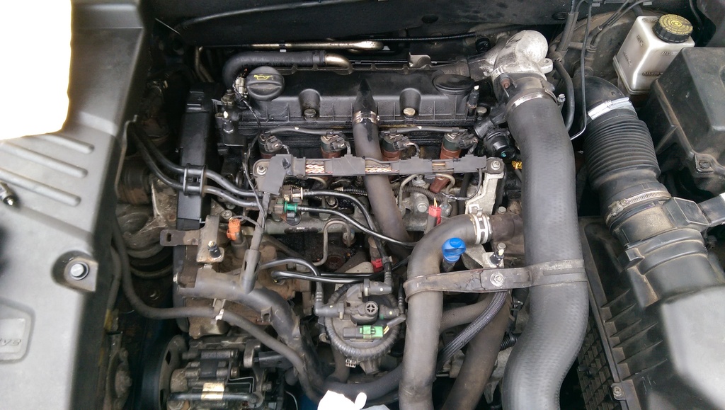

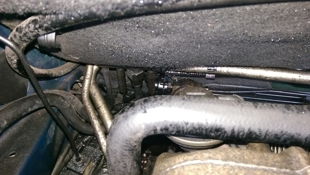

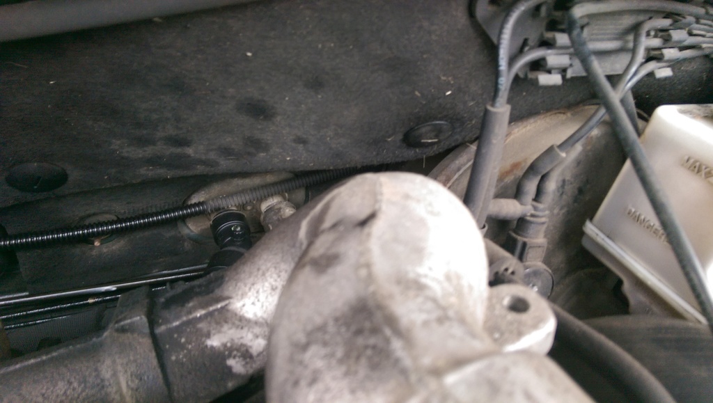

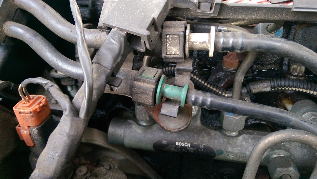

Also I noticed the fuel lines weren't clipped in properly and one was broken;
Doesn't look much better, but believe me, it is.
Also four new resilient bolts for the engine cover ready to go;
One of the firewall insulator clips was missing, so got one off a breakers;
Refitted the cable into the clip on the bulkhead, replaced the broken fuel pipe clip and refitted both lines but I found that the front plastic pipe was then rubbing on the metal fuel line, so I left it unclipped and resting on top. I think they've been refitted in the wrong order when the filter was last changed, so they don't sit right. I might sort that one day...
