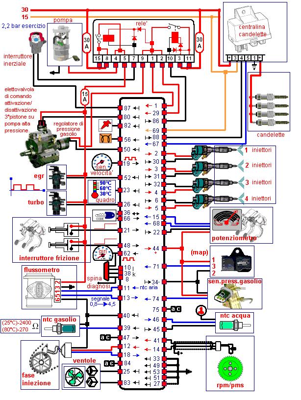

ive had a short problem in a xantia where the imobilers light came on and wouldnt let me start but it was a dodgy conection on ecu conector block...worth a quick wiggle atleast..the signal from the body computer to ecu heres a pinnout that may help
http://www.hdi-tuning.co.uk/downloads/edc15c2pinout.jpg

That's a useful diagram Taffy. Good find.. I like how glowplugs are candlettes :)
