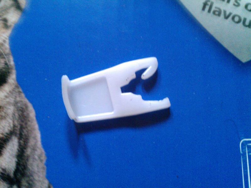

Well that repair didn't last long. Reason being the "repair clip" I bought was a different design and came with a different retaining clip (think of a clothing peg or see pic below) as the repair sliding regulator clip has a different "nipple" design with a wider neck.
What originally happened on initial repair attempt(s) was my assistant broke the replacement clip on trying to force it back on blind so we thought it would be ok to re-use the original wire retaining clip - this I now know was foolish and I was punished with a stuck down wide open window. Lucky it was dry on my return home journey.
We've not got the window back up but I need a new retaining clip.
