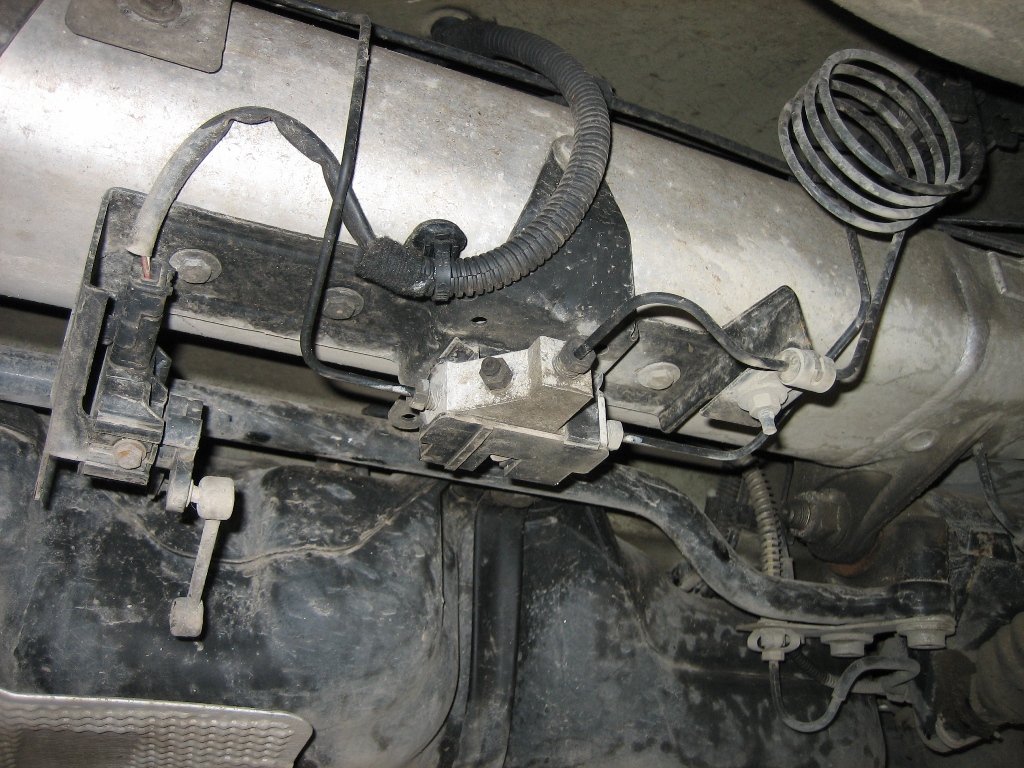

I've been underneath my C5 to replace a corroded/ruptured hydraulic suspension feed pipe to the rear suspension. A pig of a job, hadto remove fuel tank, exhaust, rear subframe and underbody protection covers. Plus disconnect/drain rear brake pipes.
For a while my rear subframe was on my garage floor while the car was outside on axle stands.

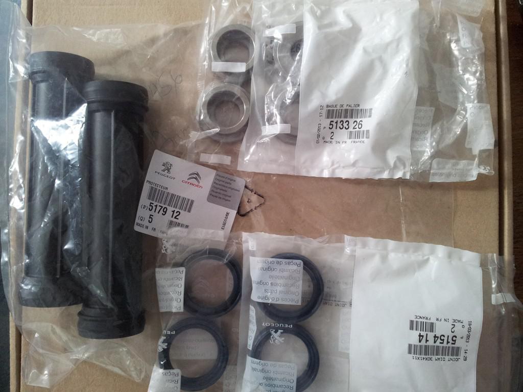

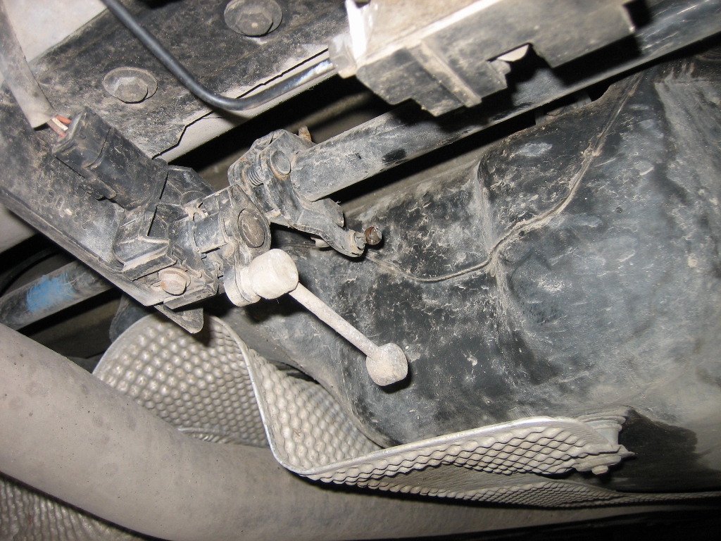

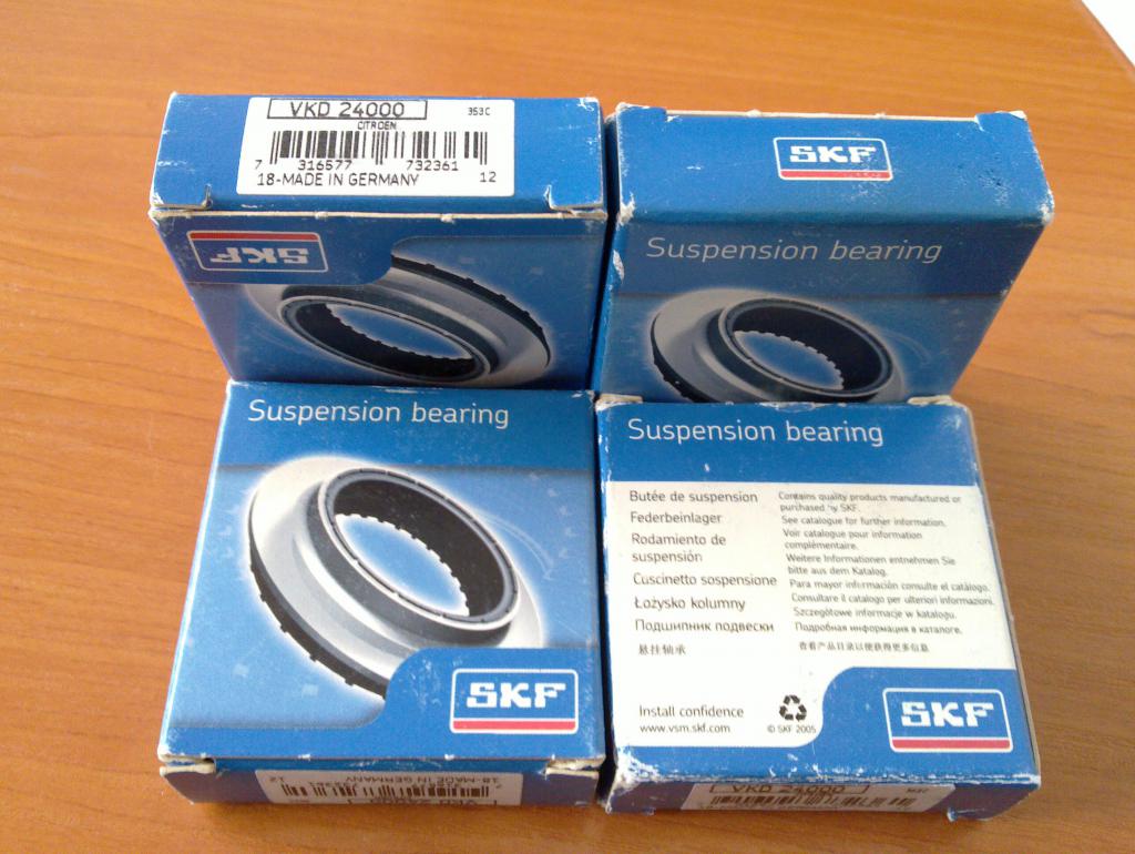

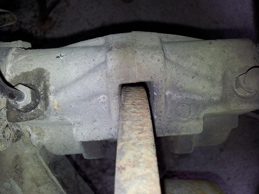

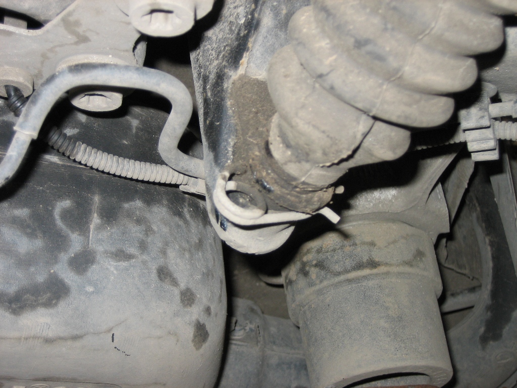

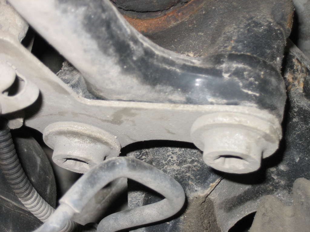

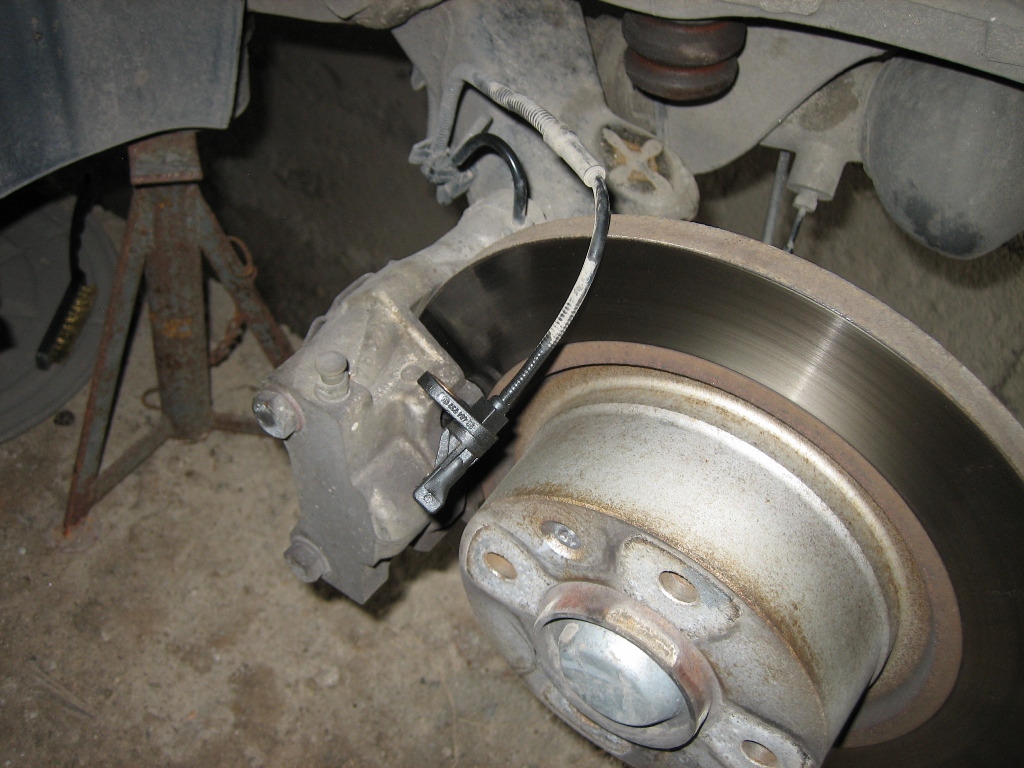

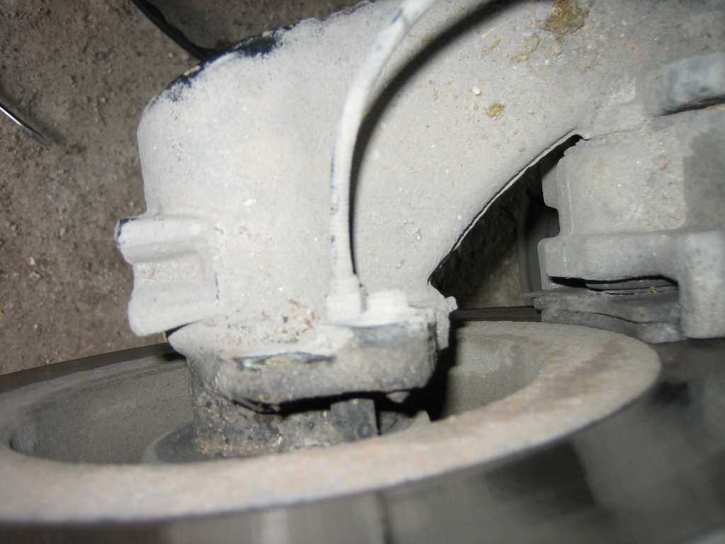

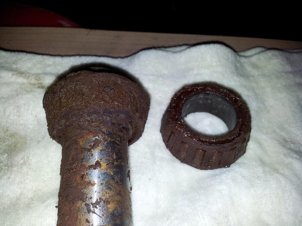

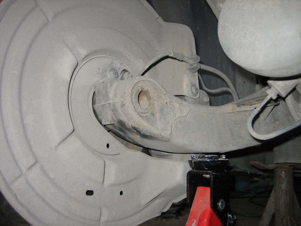

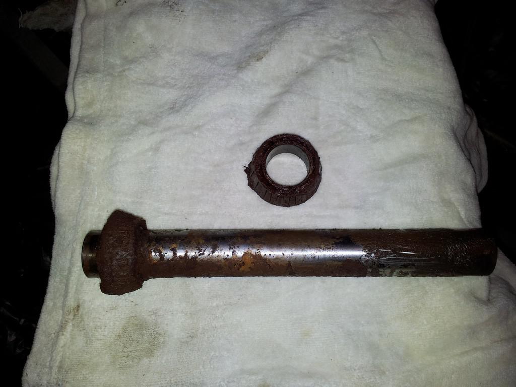

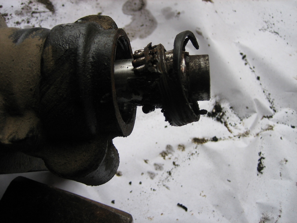

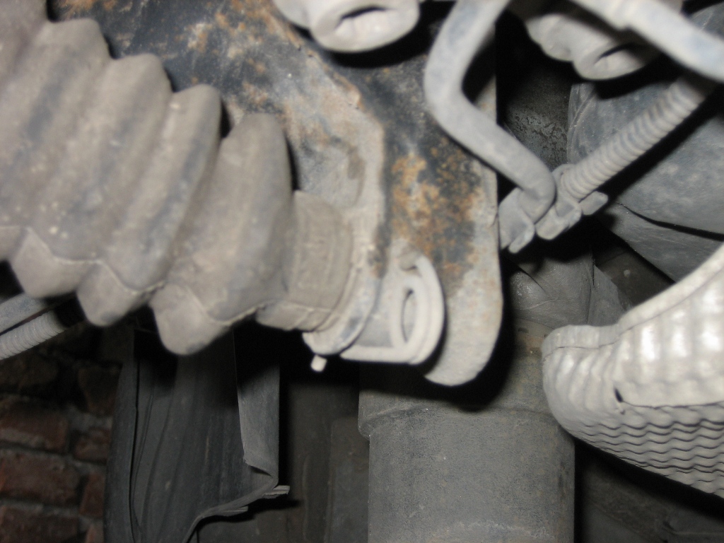

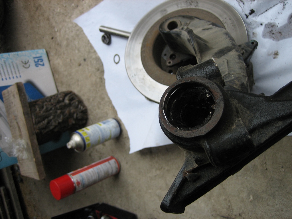

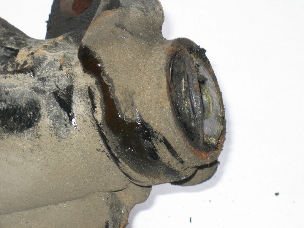

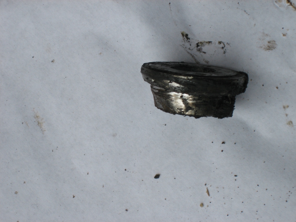

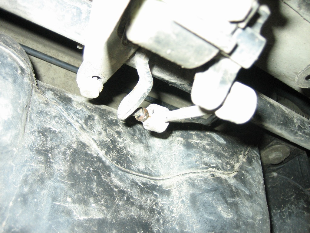

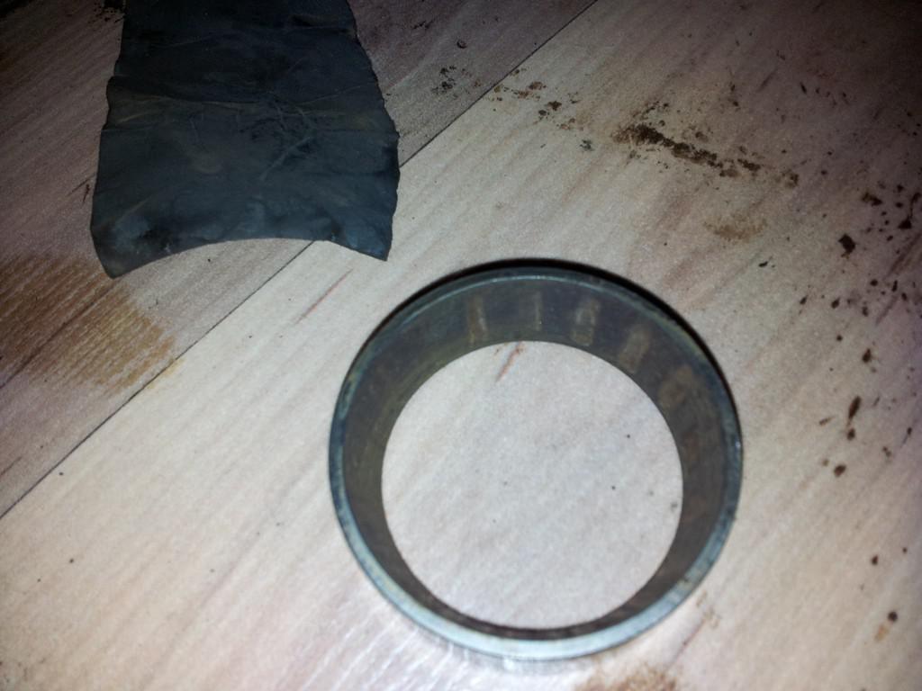

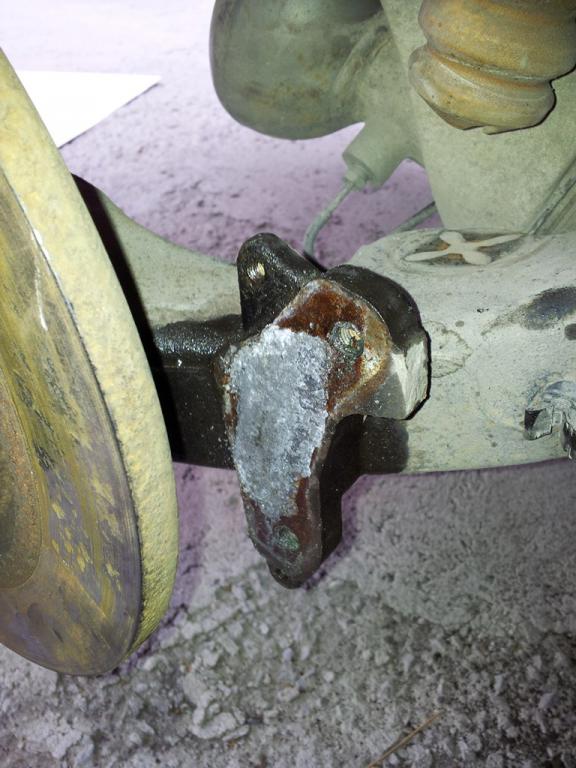

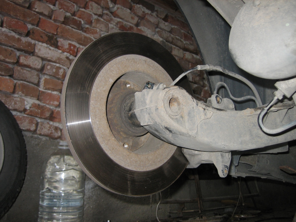

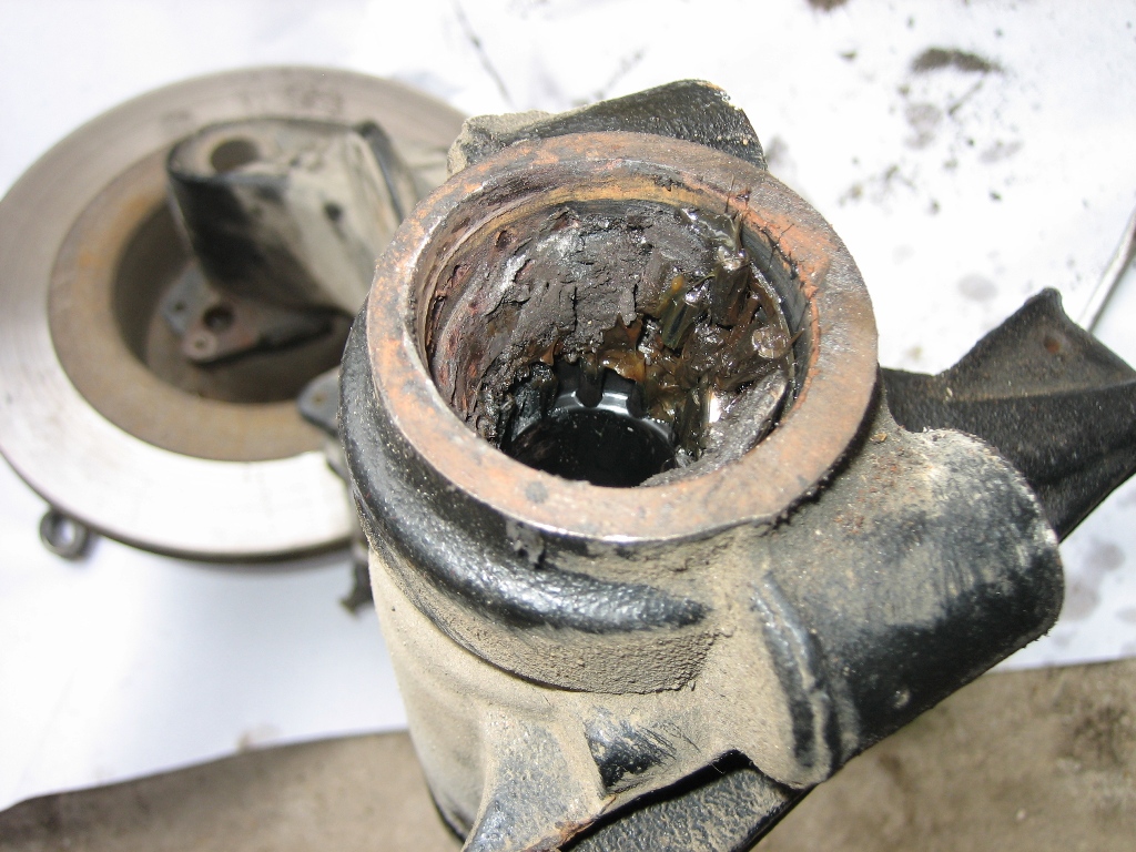

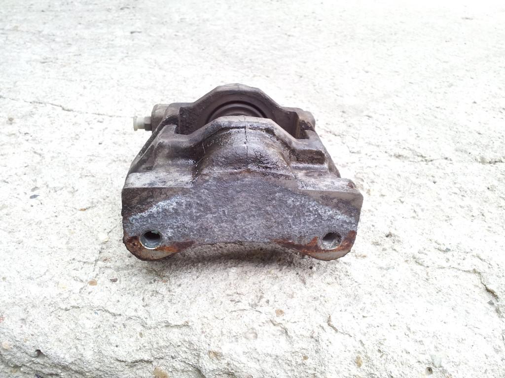

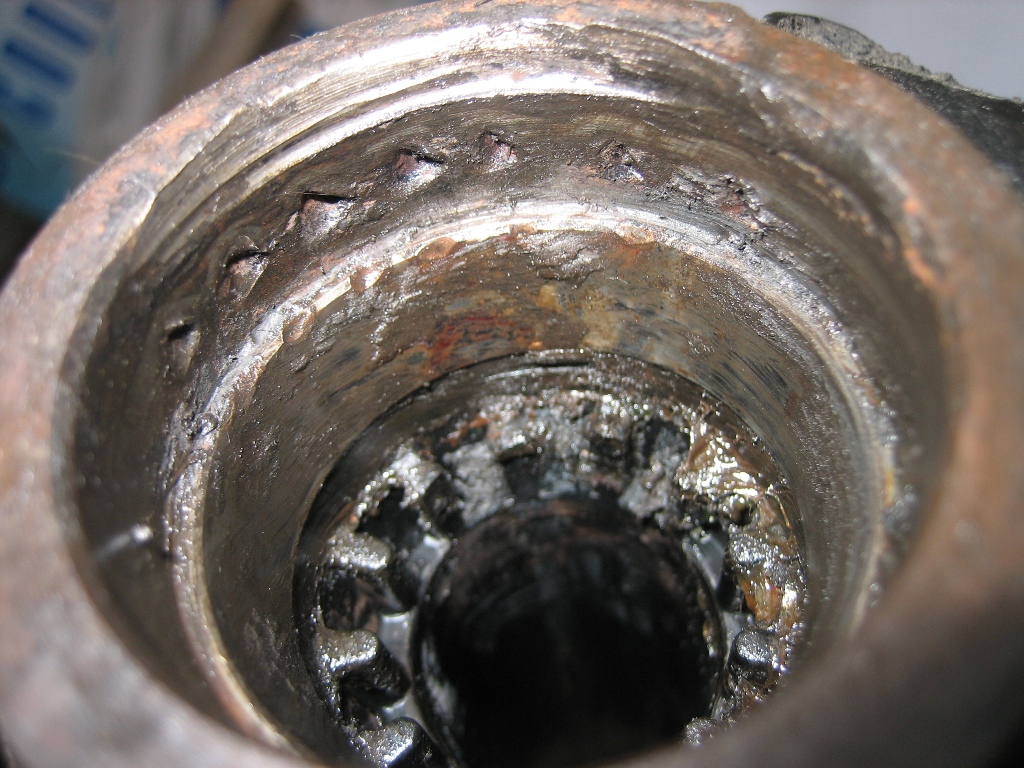

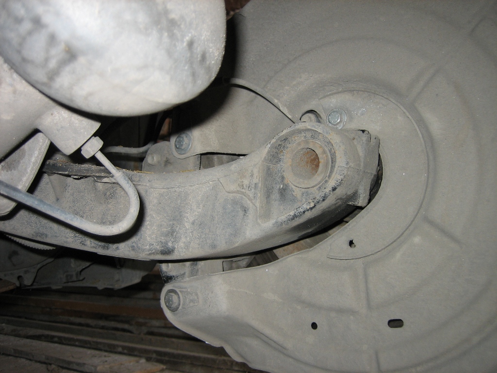

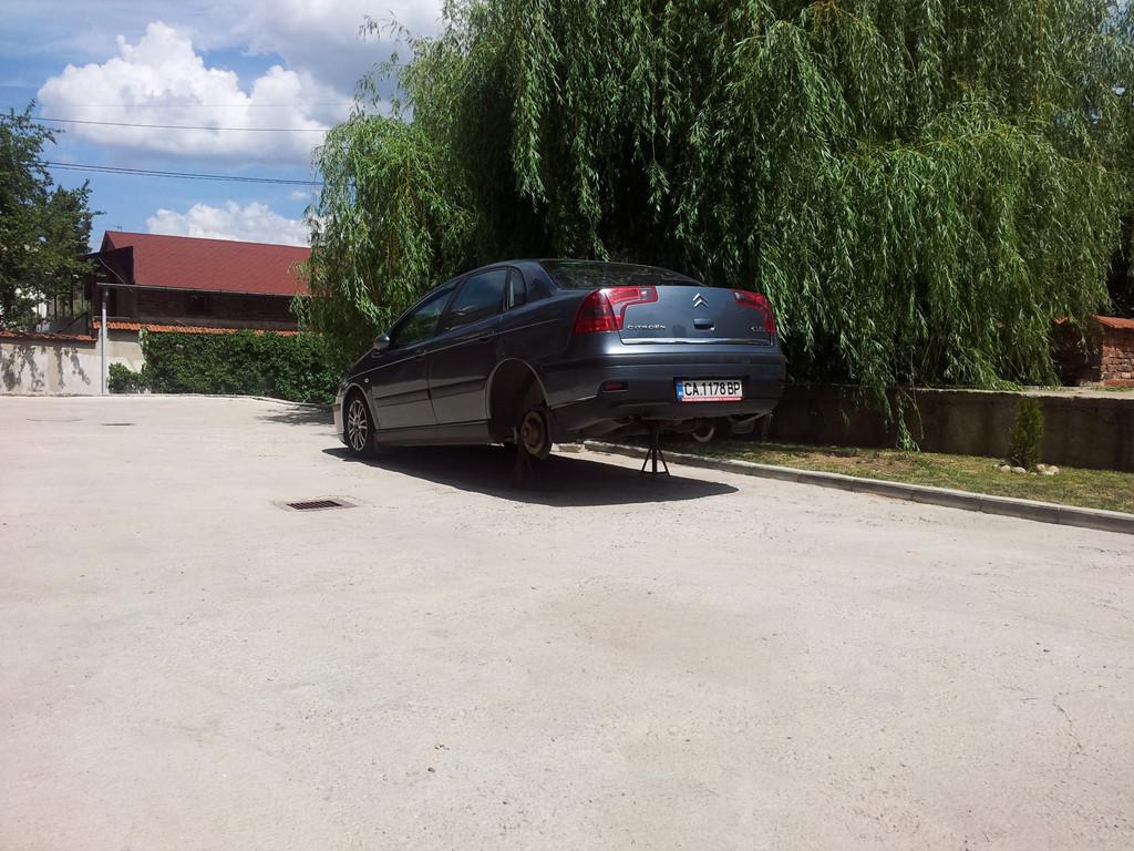

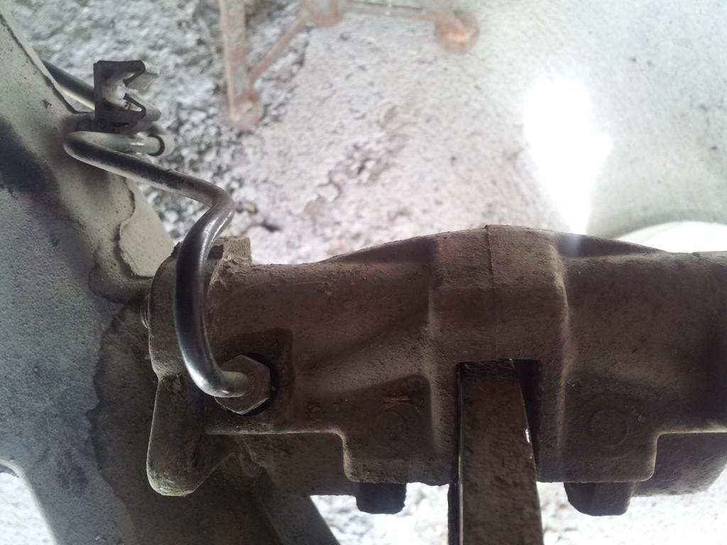

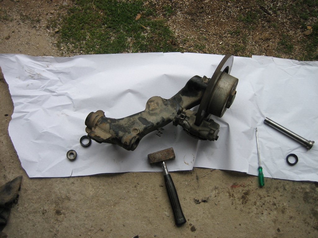

Hello again. I apologize for the necessity of registration, but such is the policy of the forum. I will try anyway to show photographs.

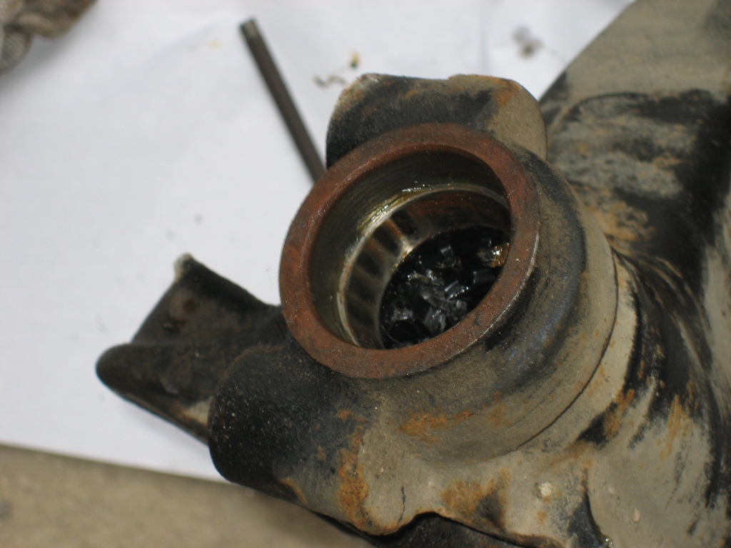

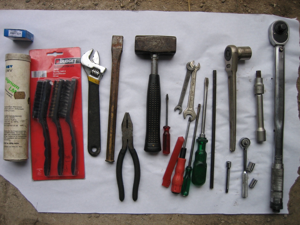

Tools: 2h24 gedore of bolt and nut, 8 and 10 gedore to BRAKE DISC PROTECTOR, 10 and 11 hydraulic keys to BRAKE CALIPER DRAIN SCREW and Pipes, T55 bolt stabilizer bar, torque wrench, a set of screwdrivers, hammer, jack, pliers and rags free time at least 5 hours.
mileage at the moment was 94,000 km.
mileage at the moment was 210,000 km.

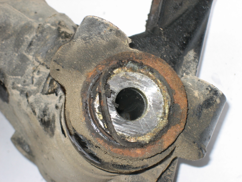

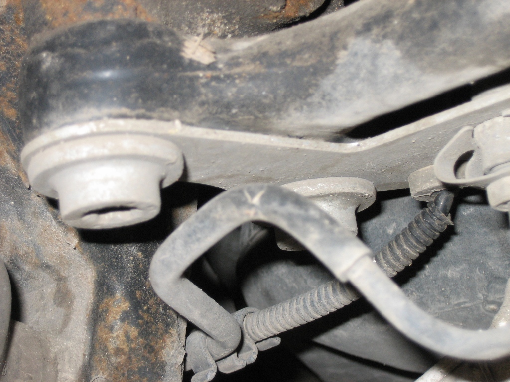

Damage to the fitting of rear brakes
Repair Kit:
I hope I was helpful, I apologize if there are errors - use google translate
Repair Kit:
- Posts: 28724
- x 5673
Re: 2005 C5 weird rear wheel position query - pics added

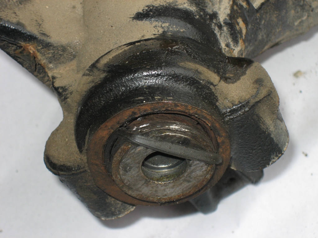

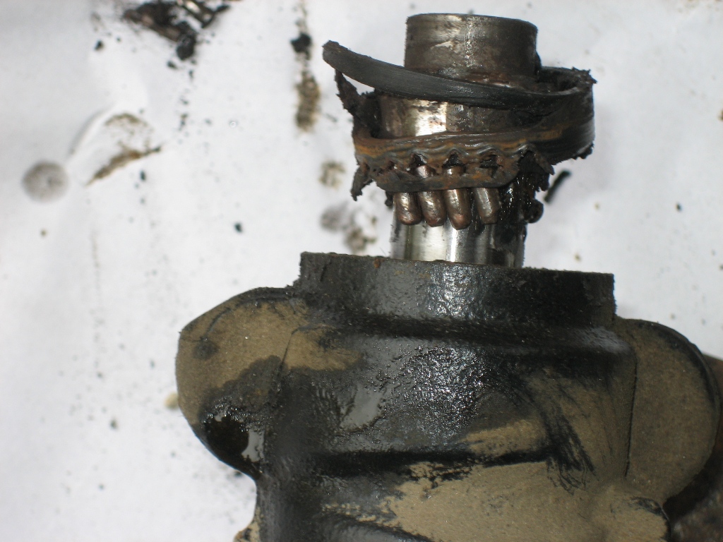

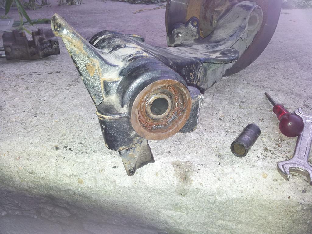

Excellent set of photo's. Should be a big help to anyone tackling this.
Has your car been in water deep enough to cover the axles? It looks as though water has penetrated the bearings and they have corroded away rather than worn down.
Jovani
- Posts: 11
- Joined: 05 May 2012, 13:41
- x 4
Car not swim in deep water , nothing other than normal operation . Factory bearings had very little grease. The first repair trampled them with plenty of black lithium grease OMV, which was , as seen in recent photos not a good idea. Now lubricated with a special water- repellent grease on copper base. Such an arrangement of the suspension is the same as the Xantia, XM, BX, C15 and the same problems - needed repairs in equals approximately 100,000 km .

Good and interesting photos - thank you for posting them. Glad to see you are replacing the bearings
