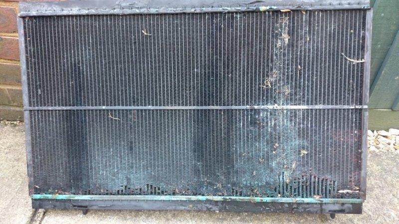

Just to get the thread back on track, I collected my new rad from GSF Heathrow today, a bit eye watering at £130, but I did get it discounted down from £165. Looking at ECP, they wanted £212 for theirs. Could have got it cheaper mail order but no knowing when it would turn up, whether it would arrive in one piece or even if it would be the correct type.
Hope to fit it tomorrow if the rain gives me a break, then we should be back on the road.

It'll be a better day tomorrow they say. The weather stopped me in the middle of a wheel bearing job on my Activa for two hours. It's lovely again now but earlier on it was raining glass stair-rods with a distinctly electrical theme.Stempy wrote: Hope to fit it tomorrow if the rain gives me a break, then we should be back on the road.
That was a good price for a C5 V6 rad Stempy. I thought they were massively expensive - maybe just the genuine Citroen ones...

What was I saying about being a blessing in disguise???!!!!
Will be going for a test drive later, hopefully all new the new parts will work in perfect harmony.

Replacement was not one moment before time then Stempy!
A blessing indeed. Like when I punctured my first V6 rad. That was a blessing as it was full of rad seal to try and stem a heater matrix leak. They must have tried every variety about three times over. It blocked the transmission cooler and may have contributed to the gearbox failing.
Had i reused the rad it may have caused more problems.
