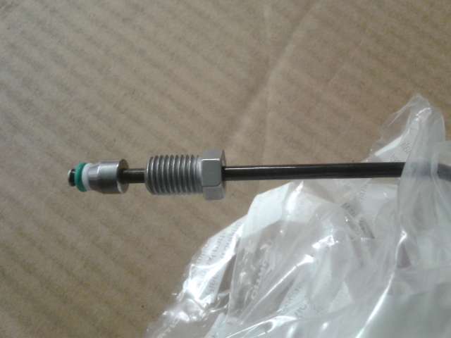

Hi Kenny, You'll know what a Bu**er it is to do then.
The C5 unions don't really look any diffferent to the Xantia ones until you see the "other" side. there is no longer just a seal, but a metal "blob" and a formed end with a seal built in. I do have a picture .. but it's on an e mail and can't save it here.
The important info is that if your car is RPO 8208, 30th April '99 or earlier then you'll have standard unions if it's later than that you'll have, I believe, according to Citroen the C5 unions for your suspension cylinders.
I hope this helps

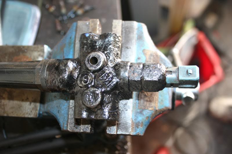

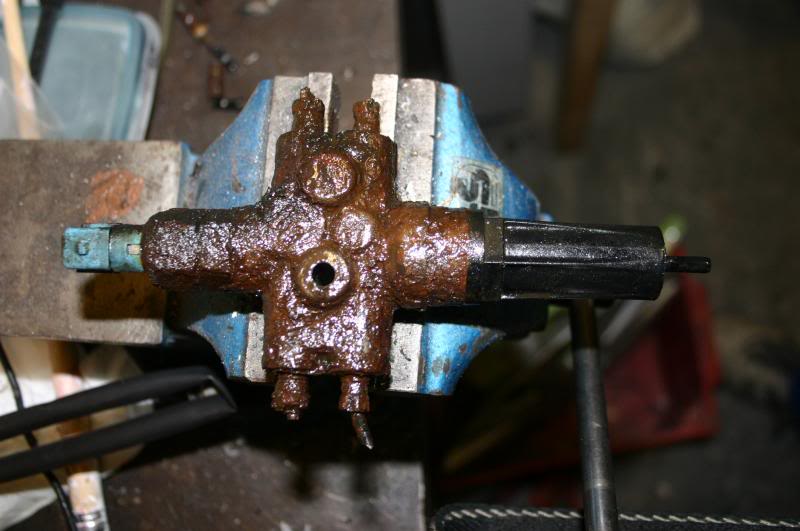

Thanks for posting the inmage for me Steve.
Update today. I spent 6 hours this morning removing the safety valve and associated piping ready for the new stuff.
Before and after of the safety valve 10 minutes of a wire brush on a drill and then Kureust treated.. Must try to protect it better when i reinstall it.
I've come to the conclustion that it's not worth saving any thing when you're replacing pipes.. work out what you need .. order or make it up and then just cut the old pipes off.. remove the K or whatever the pipe connects into and try to reassemble the difficult/hard to reach bits first.. dont worry about the routeing as long as it doesn't rub against anything, protect what does rub with black shrinkwrap sheathing and use cable ties to fasten K's and joiners down.. don't bother with the old rusty or hard to reach bolts.. so its off for 4 nights now.. next update Sunday
