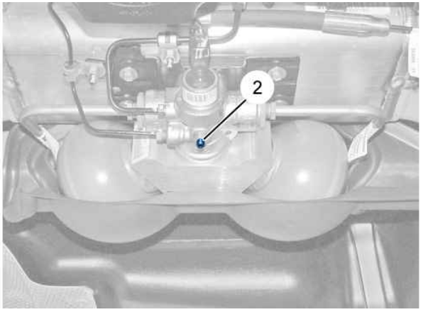

Thanks Marc, I'll give this a go next time I get the C5 in the garageGiveMeABreak wrote: 28 Aug 2017, 18:37EDC5 wrote: 27 Aug 2017, 18:06 I've been tempted to bleed the rear suspension of my C5 and then replace the LDS with fresh at the front. Not for any particular reason but the thought of the LDS moving back and forth by about an inch doesn't give much opportunity for oil replacement through normal use.
Yes X7s are Hydractive 3+, but Elis has a a 2.0 Lt.
If not using Diagbox, manual method is:
Disconnect the battery.
Raise the vehicle and support on axle stands, wheels free.
Put a hose on the pressure release screw (2)
Gradually unscrew the pressure release screw
Wait for the pressure in the circuit to fall fully
