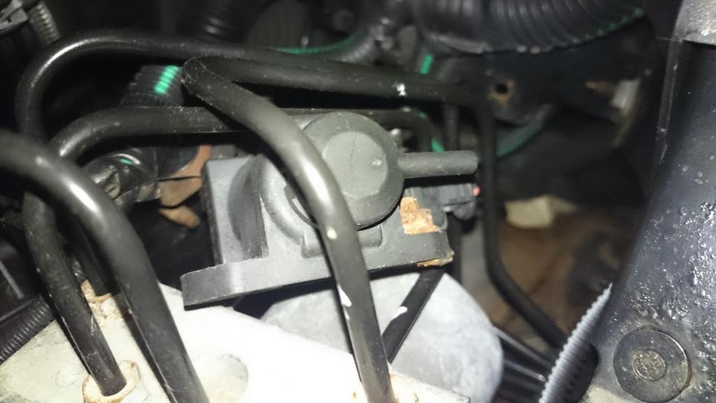

well guys back again, need to sort this car out as the tax runs out end of this month, ive just been tinkering under the bonnet and found what i believe to be a vacuum solenoid or valve of some sort, its broken off its mounting bracket which is located to the right of the airbox, by the jack holder, there seems to be 3 pipes which should be connected but only 1 is, i have found a disconnected pipe but not sure which lug it is supposed to be on so connected it to 1 of them, i now have a vacuum which you can hear and if i put my finger over the end thats sucking in the engine revs drop so its definitely connected and giving a signal to something, i just need to find out where the pipes go to and find the missing pipe.There is another similar valve lower down to which is connected/
If anyone can shed any light on what it controls and where the pipes are that should go to it i would be very grateful!!
