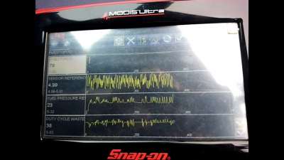

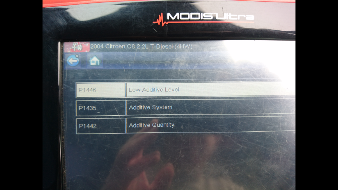

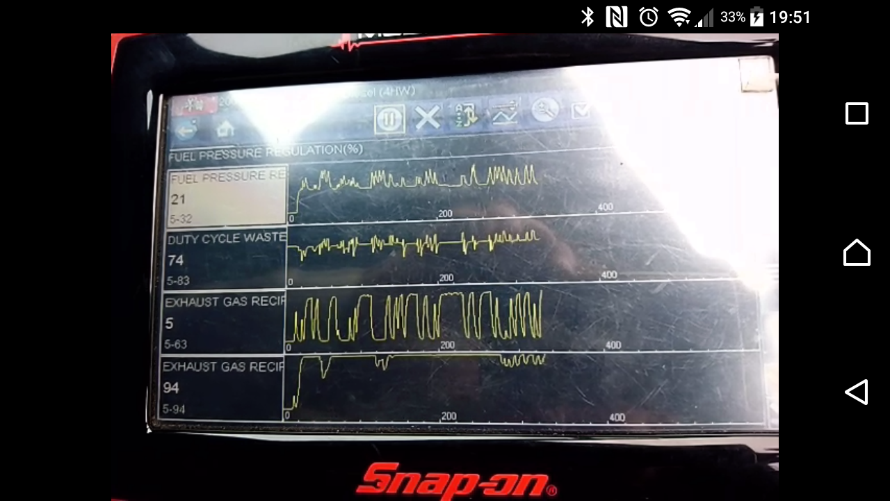

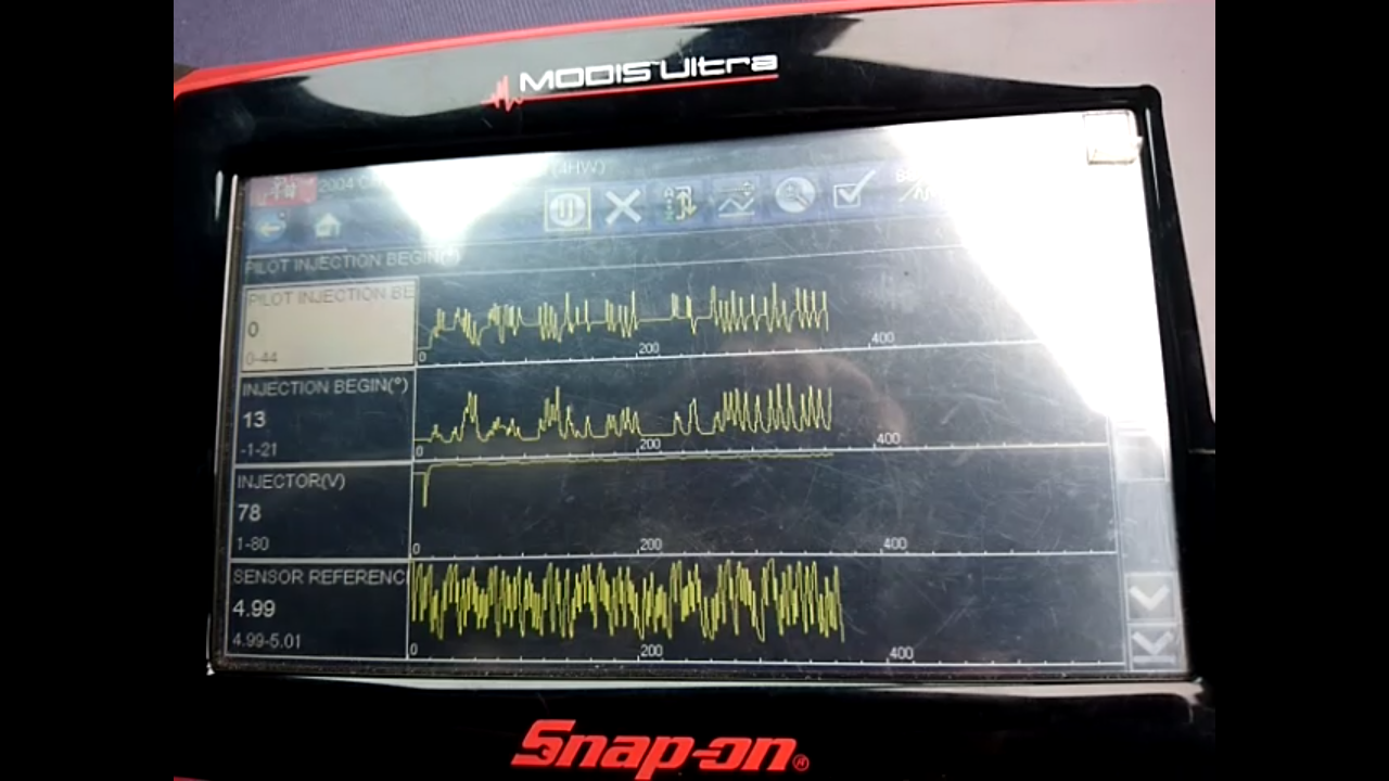

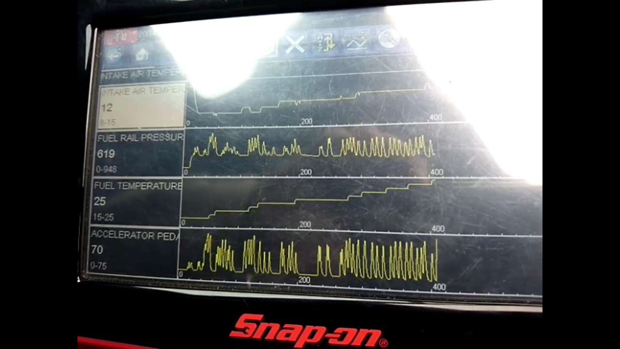

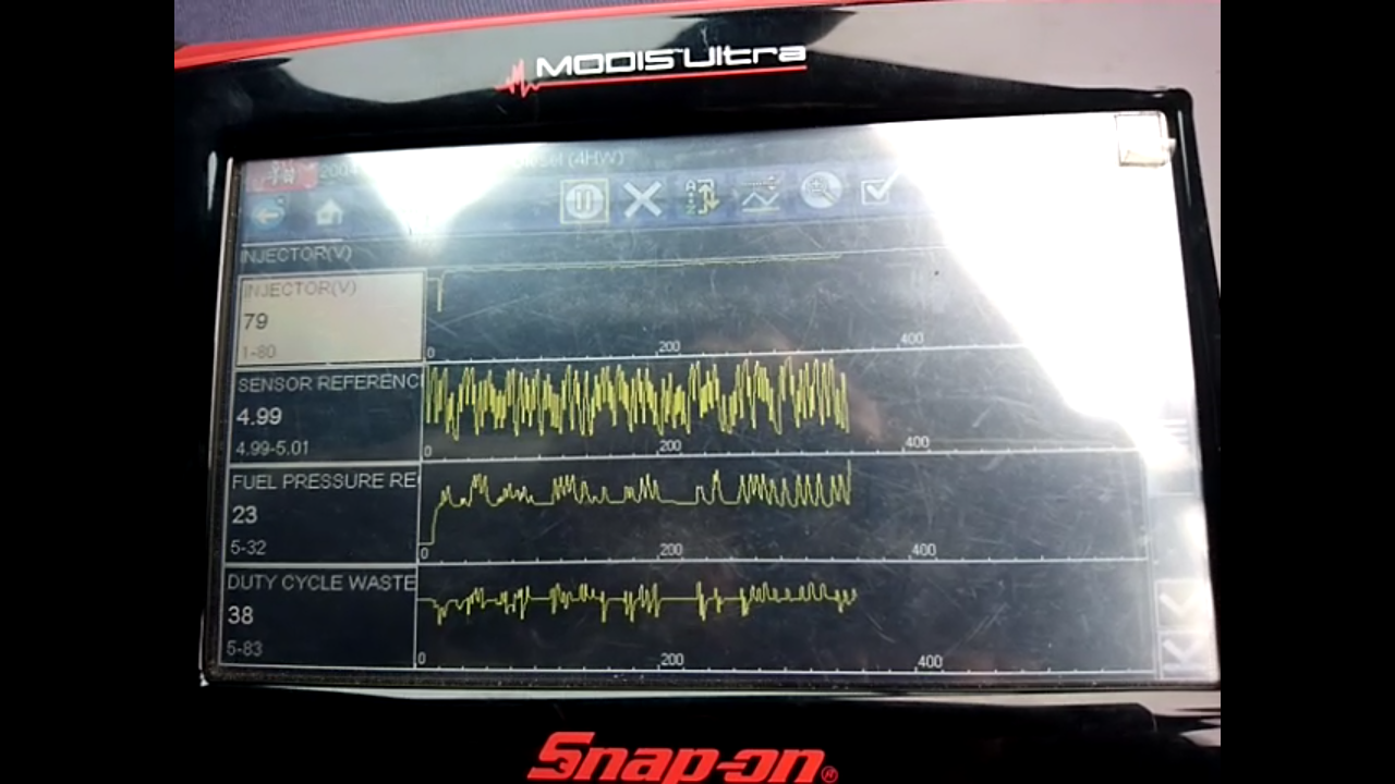

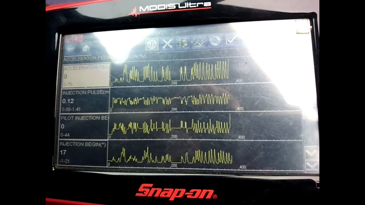

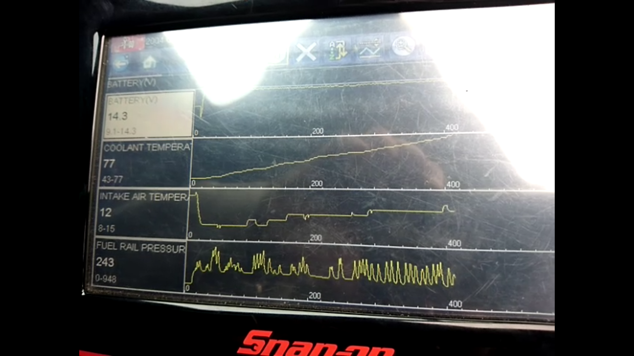

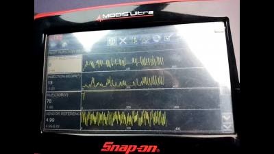

Thanks for your reply. If I disconnect the maf the car has even less power and goes in to limp mode and won't rev above 3000rpm. I took a video of what I scanned on the live data. I didn't scan the dpf data, I do have a warning about the additive system and additive levels, when the additive was topped up some years ago we couldn't get the additive level to reset, the scanner did all the resets that should have reset the values but they just wouldn't work. Tried a few garages with different scanners but no joy and didn't want to pay Citroën prices. I know the dpf isn't blocked because it had 5 holes drilled through it when we realised it might block because of the additive problem. I will check the dpf pressures with the scanner though just to double check.
Am wondering if the egr is slightly open, planning on blocking that off to check.
Here's a few screen shots attached.
