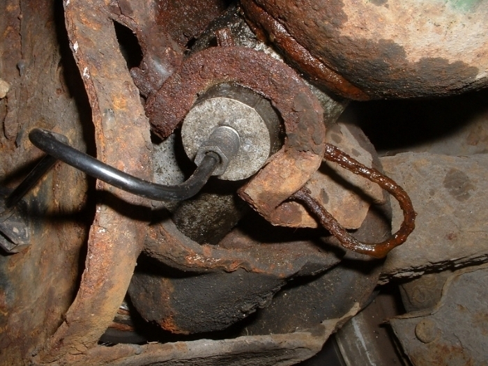

RichardW yes it's that collar that is stretching ....quite weak with the rust

This is how much the suspension cylinder collar has stretched / moved any more and I fear the pipe will be damaged / blow

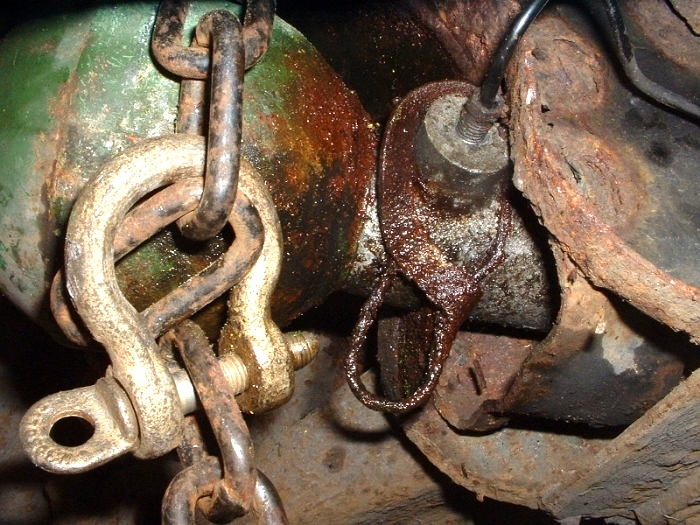

Thanks - looks like I'm going to have to buy the tool then as there's no way I can use a hammer and a chain wrench at the same time ...

Drivers side rear sphere (top right) before I get angry and the suspension cylinder collar before it crumbles

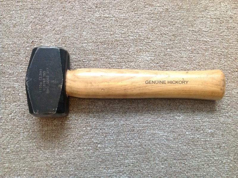

Have you a good-sized hammer to go with that sphere tool? A toffee hammer is no good. a 4 lb club hammer is the minimum you should consider as almost adequate...
Mandrake
- Posts: 8692
- Joined: 10 Apr 2005, 17:23
- x 695
Re: 2.1 TD Xantia on a budget
Here's the one I use, from B&Q I think:CitroJim wrote:Have you a good-sized hammer to go with that sphere tool? A toffee hammer is no good. a 4 lb club hammer is the minimum you should consider as almost adequate...
It's "only" 2.5 lb but it seems to do the job. Too much heavier than that and it gets difficult to swing it with one hand above you while lying on your back with the other hand pulling on the sphere removal tool IMHO...
