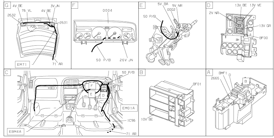

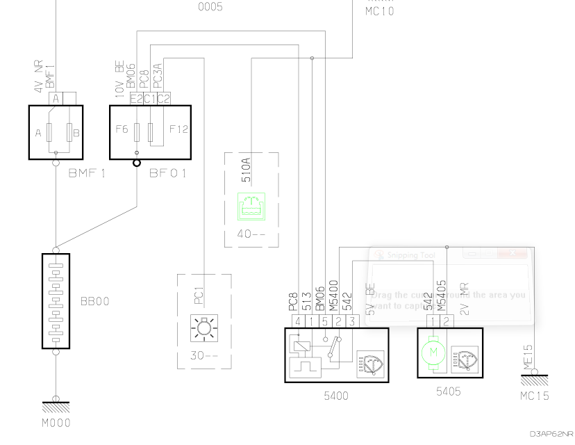

Just looked there's a few diagrams for "headlamp wash":
5400 is the headlamp wash timer relay.
Locations of C and D
The fuse F6 appears to be on the ground side?
Also the Front fog lamp relay is 2665
Which has a wire BM06A united with BM06, I guess you could cut and isolate that wire so it's no longer connected to the headlamp wash timer? (or remove the relay?

Not in the diagram you posted, F6 is in BF01 which connects to the battery positive at BB00.The fuse F6 appears to be on the ground side?
I'm going to have to study this a bit more because I can't see how F6 blowing would affect the fog lights, it should only stop the headlight washer...I better check which fuse is actually blown...Also the Front fog lamp relay is 2665
Also your diagram shows relay 5400 for the headlight washer as the centre relay of the group of three, but on my car the centre one is the starter inhibit relay.

F6 is indeed shared, I just didn't realise that on another diagram for the fog lights (which you didn't show) it also shows F6 feeding the relay for the fog lights. (Still learning auto electrical nomenclature
So as far as I can see I can just unplug and leave out relay 5400 and replace F6 and assuming the short is somewhere in the washer motor or the wiring to it the fog lights should work again without blowing the fuse. I'll give it a try tomorrow. The only slight snag is mine has the locations of the three relays in the fuse box swapped around compared to the diagram (even with the correct RPO) so I'll have to double check I have the right one.
If it still blows I'll know there is an intermittent short somewhere in the fog lamp wiring rather than the washer motor/wiring.

It might not be a short in the motor or its wiring, but a seized motor/pump causing the motor to pull a big-enough current to blow the fuse.

I've identified the big tall pink relay as the headlight washer relay and timer and removed that, replaced F6 again (yes it was spectacularly blown again with about 3mm of the wire completely vaporised) and the fog lights are running again. We shall see if it lasts this time, assuming it does we'll known its the washer motor or the wiring to it to blame.
