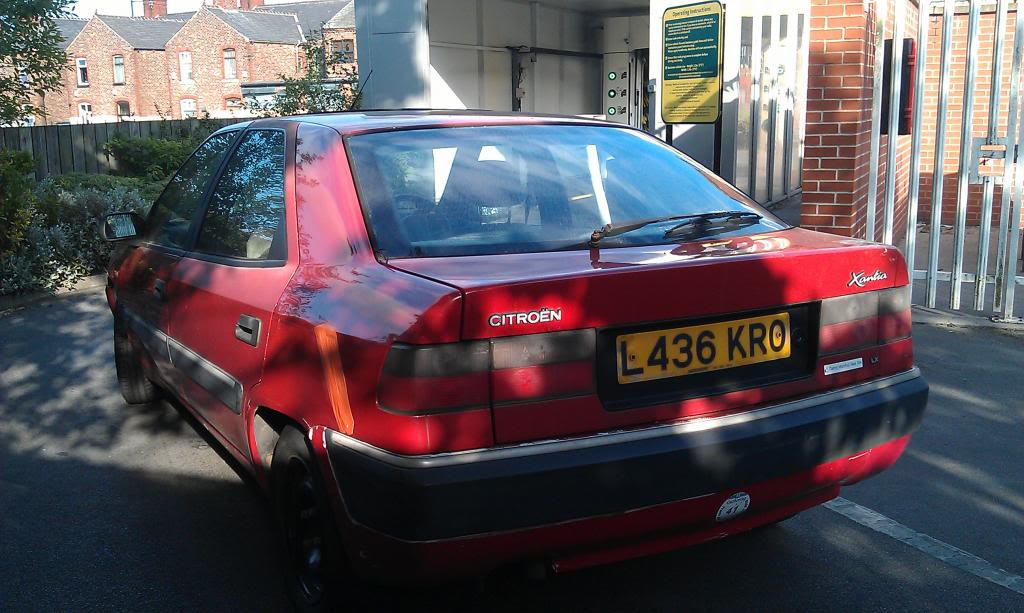

Hiya French Car fans,
Thank you for all your help, it all took longer than expected. Looks like this poor old Citroen has been now undriven for about 8 months! Wow, My garage took 3 months to get round to doing the job! by which time the MOT/Insurance/Tax was all out What didn't help was the Head Gasket going on My Mondeo Si last month!
So Cycling and joyful public transport for us for a month!
It's back, and another half grand invested along with tax, hope and pray the clip doesn't snap again, it's a proper Citroen part, and a new cable (one I got from GSF was wrong) feels a lot better a lot lighter, i think it was original clip and cable so understandable it went after 18 and a bit years. I just cant afford for my health sake for it to break again. Clutch itself doesnt feel too bad now, not as high and not noticably slipping, so might just see how I get on...
MOT wise, rear brakes done, surely and I hope they didn't think handbrake was on rear surely...
bulbs wipers and other stuff that surprised me and very dangerous ball joint, hmm strange.
So anyway back on the road after all this time. Wish me luck. 3rd day in use and so far so good, paranoid about cable. was a light click on day one but that was just the cable nipple getting comfortable I expect, seems OK...
If clutch seems to slip a lot will look at clutch replacement, any recommendations for fitters? and also might look at pipe condition and replacement of one or 2 strut return pipes and maybe fluid, any recommendations on someone to do that?
Cheers, here are the unwashed pics, enjoy!!

Now prepare for responses from the Great Unwashed !
The world is full of them and a lot are in
- Posts: 55073
- x 8391
Re: Xantia Mk1 Clutch pedal cable clip broken! BACK on the r
Looks clean enough to me in an appealing rat-like waymendedit wrote:Now prepare for responses from the Great Unwashed !
Well done and pleased to see it back on the road!
