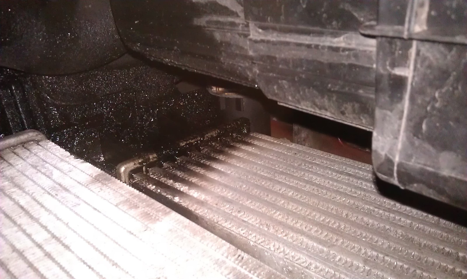

Ok thanks guys, will get some tomorrow...but!....was just outside and took this of the bottom of the ic....not good, and may explain everything....and I need a new one :evil:
Sorry for the big pic
oneday
Posts: 663
Joined: 15 Aug 2012, 22:49
Re: Should an 03 C5 2ltr hdi be sluggish going uphill
Unread post by oneday »
yep looks like its leaking

Citroenmad
Posts: 8125
Joined: 04 Dec 2008, 22:08
x 110
Unread post by Citroenmad »
Yep, thats leaking! :lol:
Still, I would try the other suggestions too, always a good idea to keep the MAF clean.

I knew it had a leak but because I looked at the mot's and saw a leaking injector, I thought it'd been leaking a while and didnt think to look there, bollox :evil: :roll:
The cheapest I can find so far is £130 (aep)
How easy/hard are they to fit
What'a caused it to leak or does it just happen
Y'know...this car's turning into a bloody money pit :evil:

oneday
Posts: 663
easy to fit

Citroenmad
Posts: 8125
x 110
I think thats how much I paid, roughly. It took me about 20 minutes to fit.

stu9
Posts: 318
Joined: 23 Oct 2012, 18:56
x 8
Unread post by stu9 »
Ok....what about the turbo, will/should it still be ok
Do I need to drain oil or anything
Citroenmad
Posts: 8125
x 110
The turbo will be fine, no need to drain any oil. Just undo the pipes at the top and botton of the intercooler - they are only air pipework. You'll need the undertray off to undo the bottom pipe, then there is some screws at the top, unto that, undo the plastic slam panel area and pull it out. Its a tight fit but it fits.
