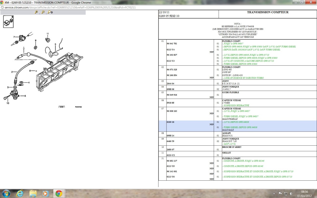

Deanxm
- Posts: 3327
- Joined: 18 Dec 2008, 17:57
- x 87
Re: I am also P£$$$ed with hydractive
item 7 is the hydractive road speed sensor Robert yes
