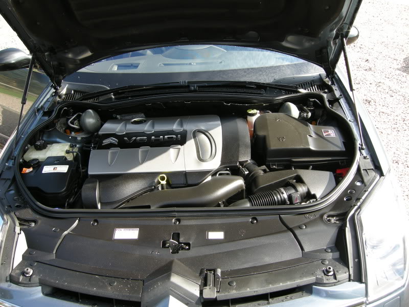

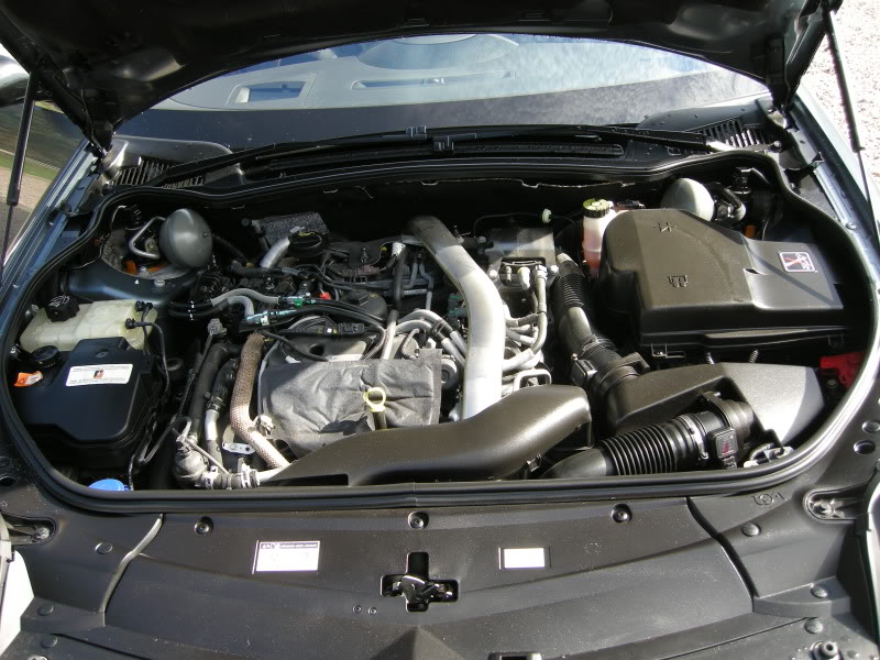

I remember looking under the bonnet when I had mine... Changing an engine on one isn't something I'd ever want to consider and I've changed several engines on V8 Range Rover's in the past.
Here's an under bonnet picture of a 2.7 HDi with the engine cover fitted and one without:
David.
David.

Re: cheap c6
Thanks for the photo's
that engine looks a bit tight in there, I noticed that there's a rubber seal all around the engine area where the bonnet shuts down onto it, I've never noticed that on any other car before.
